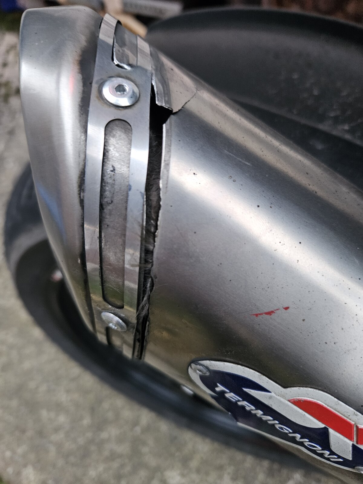

  1. The can on my Termi system has split and cracked. Anyone know where i can get a replacemnt can for the fullbsystem.
  2. Shorten the sleeve?
  3. I’d do this. Seems the easiest fix.
  4. Why would you not get it repaired out of interest, or at least contact Termi to see what they suggest or can do for you?
    Contacts - Termignoni
    • Dislike Dislike x 1
  5. Dependant on age/mileage I’m sure the good chaps at termignoni would be more than happy to uphold their quality assurance fulfilments and look into replacing it for you?
    Going off their historic accolades these guys extrude confidence in the market place
  6. @Red899 @Carr01, I’m afraid Termignoni will be contractually obliged to refer all queries and/or claims to Ducati, as Akrapovic are for the systems they developed for Ducati. Andy
  7. Another here for shortening it a bit, just remember to use blind stainless rivets when you reassemble, not the cheap ally ones
  8. I would shorten that too, may have split due to the packing collapsing, repacked mine a few years ago, not easy to get apart.
  9. Looks like it's been dropped to me.
  10. Ive contacted Termi who referred me to the UK suppliers. Im waiting for a reply from them. Im looking into shortening it but corncerned about cutting/drilling titanium. Im looking for a company that can work with Ti. Neither the bike nor exhaust have been dropped, it does however have 26,000miles on it. 16,000 in the last 18 months.

  15. Any decent welder can fix it.
    Maybe you didn't drop it but someone did. You can see that from the direction of the rivet.
