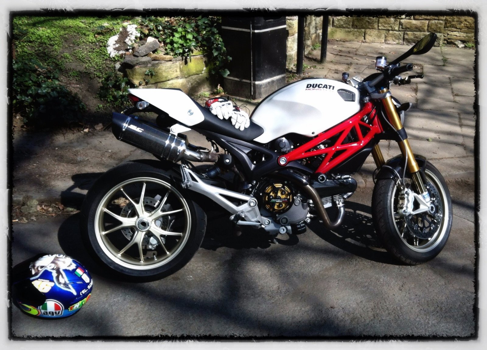

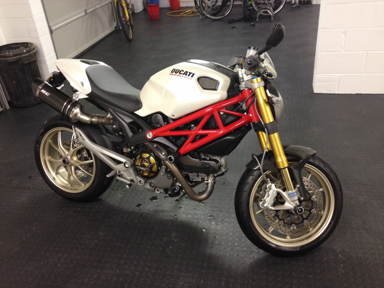

    I had termi's on my 696 but went a different route on my 1100. I got some SC project cans which are much nicer in quality and then had my ecu mapped by cJS racing. The whole package is so much better and well worth the cash.
    Have a look at the Sc website for some nice cans and then try CJS. It might also be worth asking nelly at Cornerspeed as I think he can map the Siemens ecu now.
