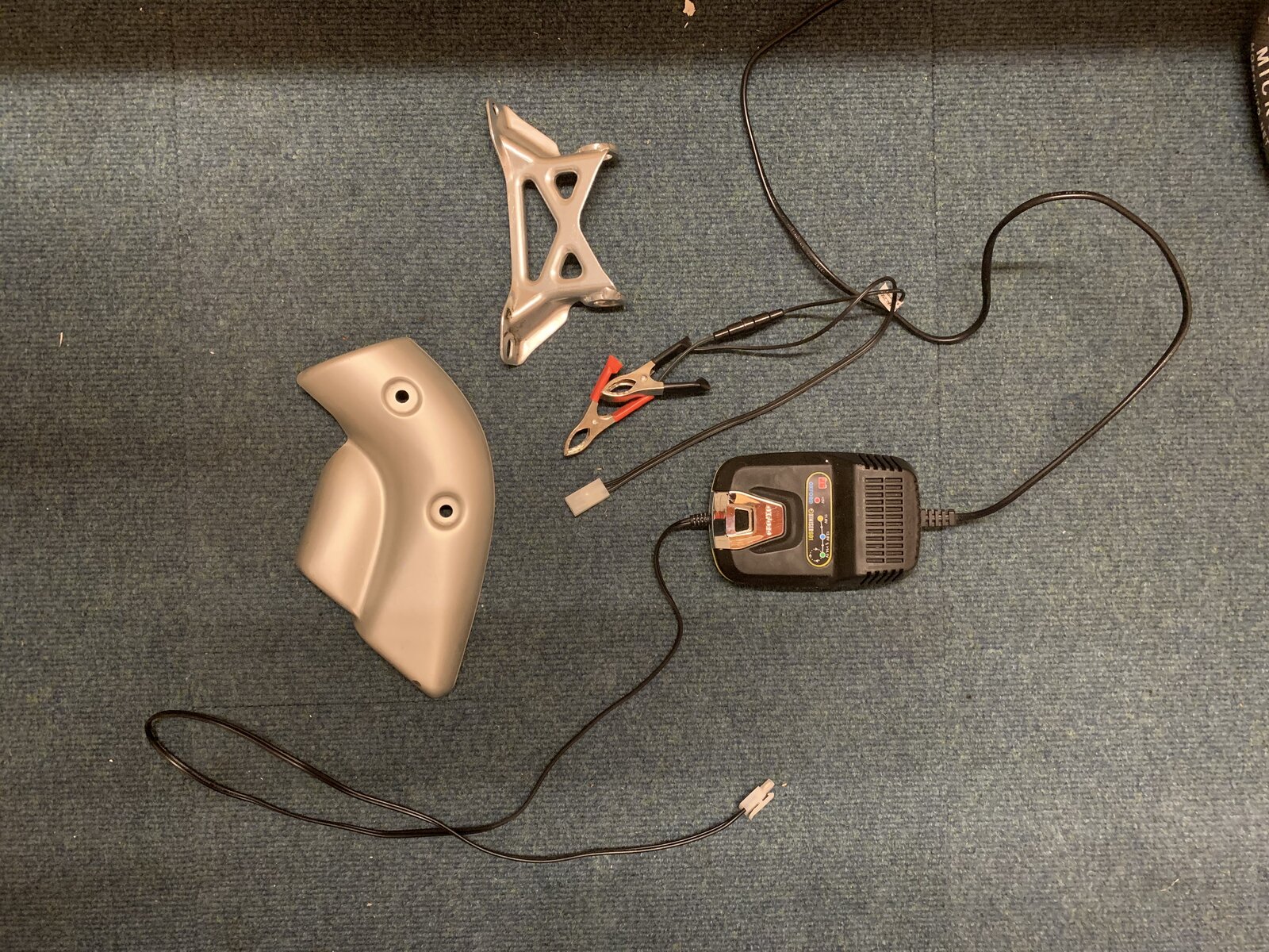

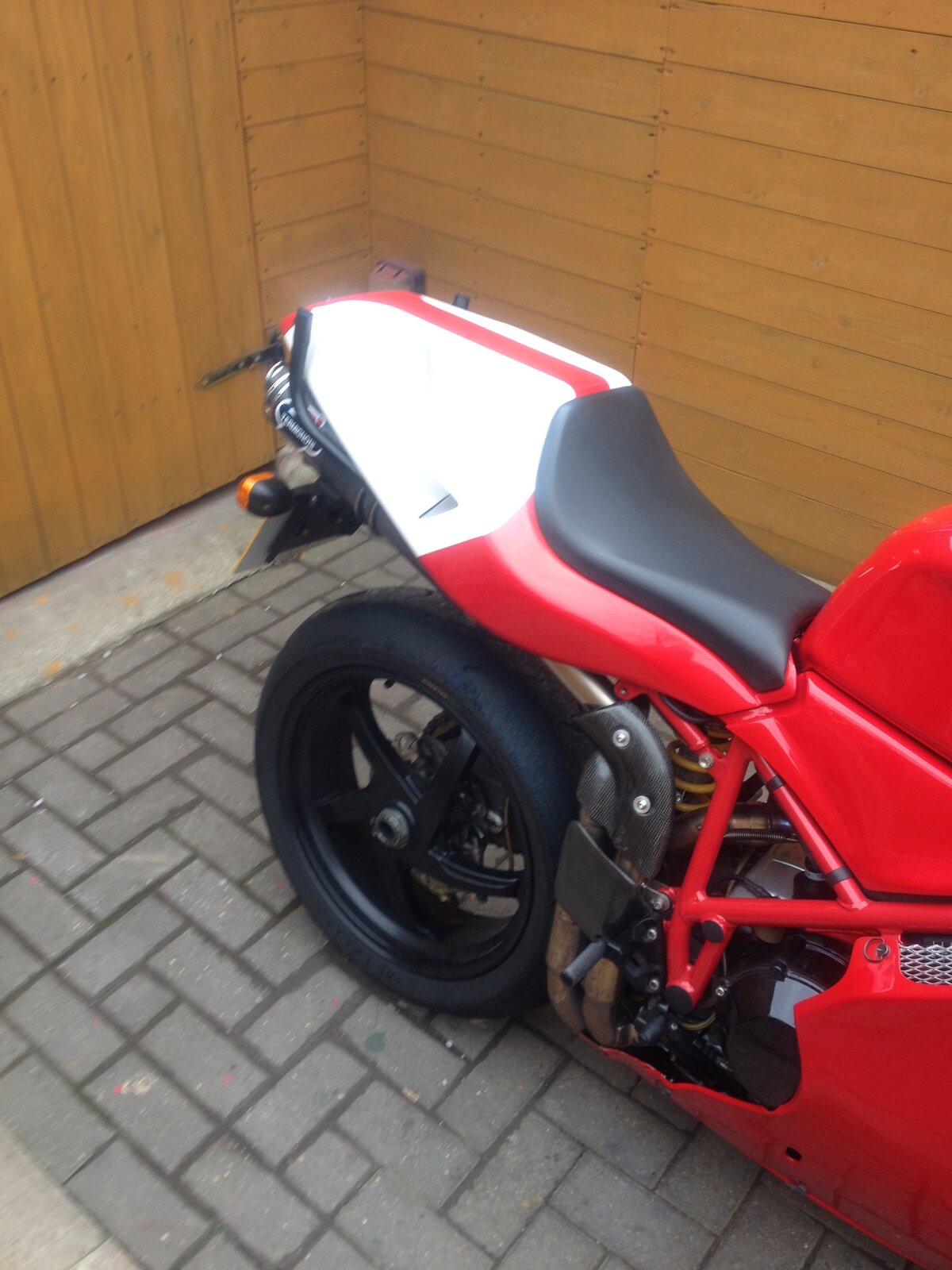

I think in total there are about 5 different types. Some Carbon Fibre ones used to be supplied with a new set of pipes and others are similar to the 998 type, which is pictured in one of the photos above. The link pipe on your bike has the early mountings for the square type of heat shield. If you fit carbon fibre heel guards you will find that this will shield quite a lot of the exhaust. This is my 748R engined 748S, with such a setup.
The heel guard is a DP one and has a large heat shield. They are meant to be fitted behind the rearset mounting of aftermarket rearsets. Mine can be seen in the photo. I guess though that they would also fit behind stock rearsets, they might look a bit odd possibly
I did the sam as Red. Couldn’t get the heat shield to line up with the heel guard so bought the Corse type ones, re drilled the holes and spaced them as best I could.

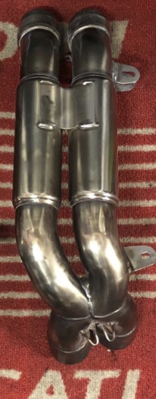

You can just fit the top heat shield on the bend but you’ll see the holes for the other heat shield on the link pipe or just fit a link pipe like this one
