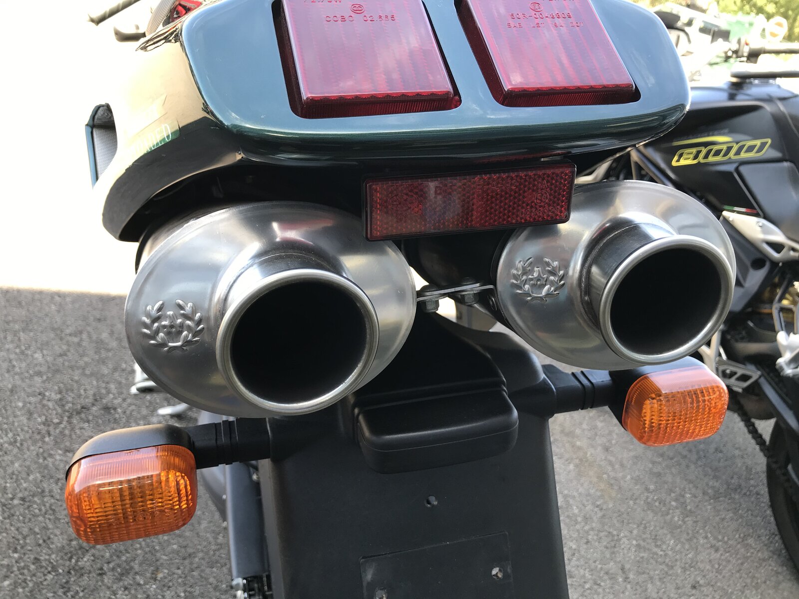

Can anyone tell by looking if this is a full system or just slip-ons? I'm pretty sure it's a full system, but I'm on the road and can't check the bike at home...
It's got the larger 50mm mid section pipe and cans so not the standard pipes with 45mm cans. That said it could be a 45-50mm mid section using the original 45mm header pipes, if so not a 'full' system, rather a 'half' system which may actually be better anyway as a full 50mm can be too big, at least on the older Desmoquattro 916/996 models, not sure on 998?
I do t believe it’s possible to fit 50mm header pipes onto the 998 engine, only the 45mm pipes. The 50mm pipes are for the 998S/996R engine. If anything it will be a 45/50 link pipe and 50mm Termis.

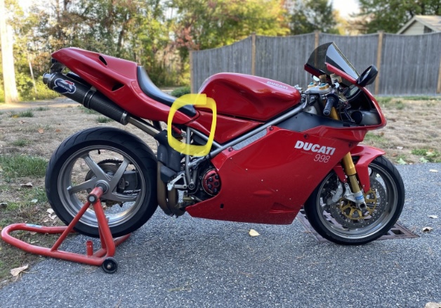

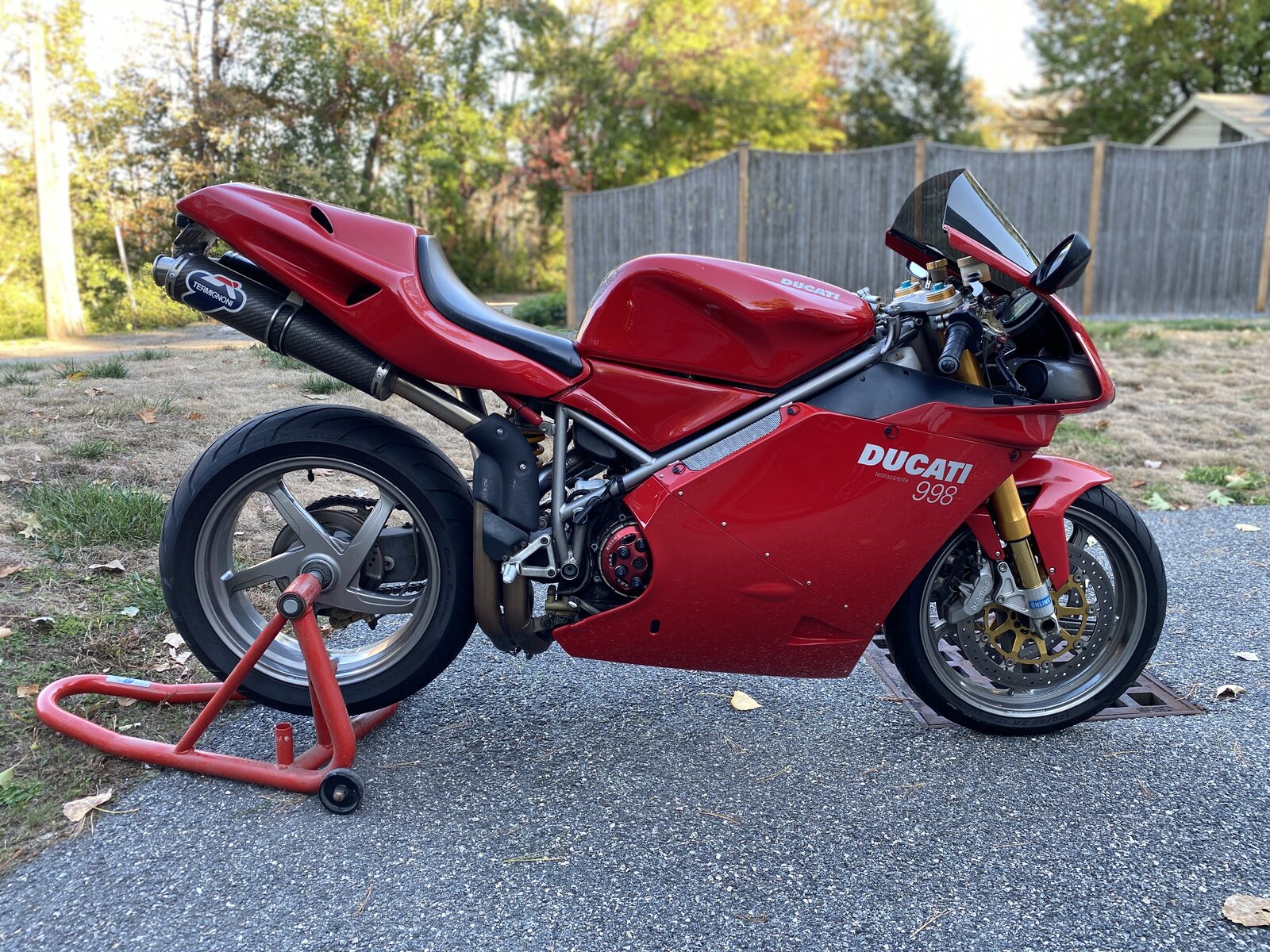

Well it certainly is not an original mono subframe, not that there’s anything wrong with that just something to be aware of, perhaps the angle that frame joins the main frame or the mounting points for the end cans are the culprit causing that optical effect
I don’t think there’s anything wrong. subframe painted red, looks original seeing the weld. The seat is just not sitting in his rear lock. You can see this clearly on the airbox line.
