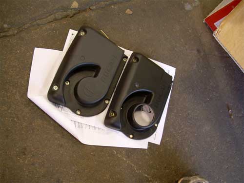

  1. Hi I've got a second hand pair of termis and the race ecu that comes with it but no airbox, can u tell me what the difference is from the standard one and the one that comes with termis and can I modify the standard one to work ? Cheers
  2. A hole in the lid. If you get a hole cutter then cut out the Ducati logo on the lid
  3. Super thanks Chris :)
