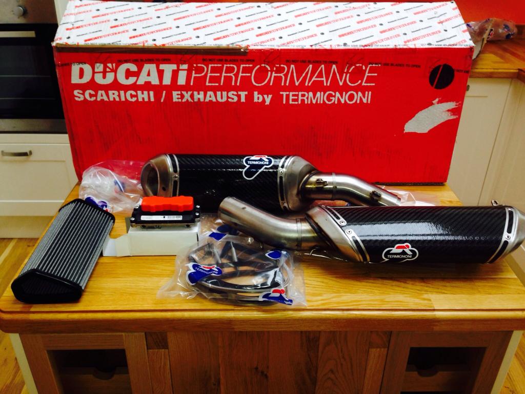

    I have treated myself (well it is the time of year!) to a new set of slash style termi's + ECU + Air filter for my 848 EVO 2011.:wink::wink::wink: Part No. DUC96459910B.
    I thought /understood the ECU was a 'plug&play' system but the dealer(onyerbike) is telling me I will have to take the bike to have the Throttle Position Sensor re-programmed as it will run rich, is this right?
    I will be receiving them on Monday next, any info/fitment tips is most appreciated from you technical fellows.
    I will post pictures of the fitment when completed.
    Cheers Vince. :upyeah:
