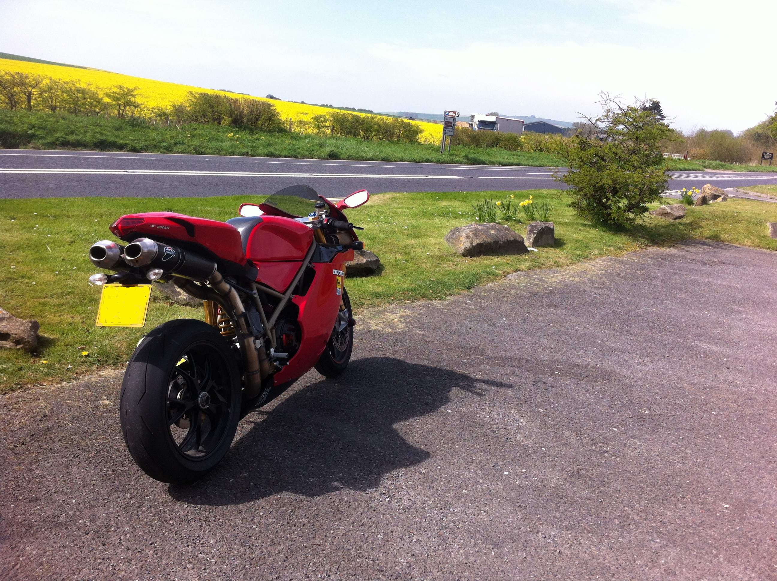

    The 1098 is all ohlined up now, I have also got me a new R frame with a DUC plate and V5 which I may be getting painted and swapping over this winter. It has an annoying farting/fuelling issue at the mo that I'm trying to sort!
    The 848 evo engined build is my track bike, been to Spain in Jan and was in Wales last weekend.
    One was scorchio, the other was wet and windy...:rolleyes:
  9. Looks good, ride well? So HOT in Wales and Wet in Spain ;) lol NOT he says :)
  10. Good enough for Miss Daisy... :Chicken::Nailbiting:
    You still have the blingest 848 in all the land?
  11. Mainly the cams. The Multi version has cams with very limited overlap (nominally 11 degrees), making it soft and tractable at low revs, while the superbike version has vastly more overlap - hence more power at the top end, but a bit awkward in towns. Maybe one day we'll get variable valve timing, and the best of both worlds, but not so far.
  12. Love the rearsets. Shame about the seat unit. Put an 916 one on you heathen barbarian. :Wideyed::Sorry:
