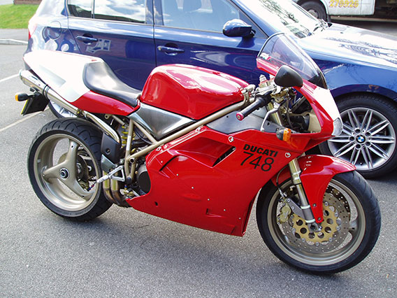

  1. If you've not seen the topic in the For Sale section, I picked this 748 up from 748 fidler on Sunday.
    The bike is in good condition and serves as my introduction into the world of Ducatis (and "big boy" bikes having just passed my test last week). I also plan to carry on 748 fidler's tradition of servicing and maintaining the bike at home.

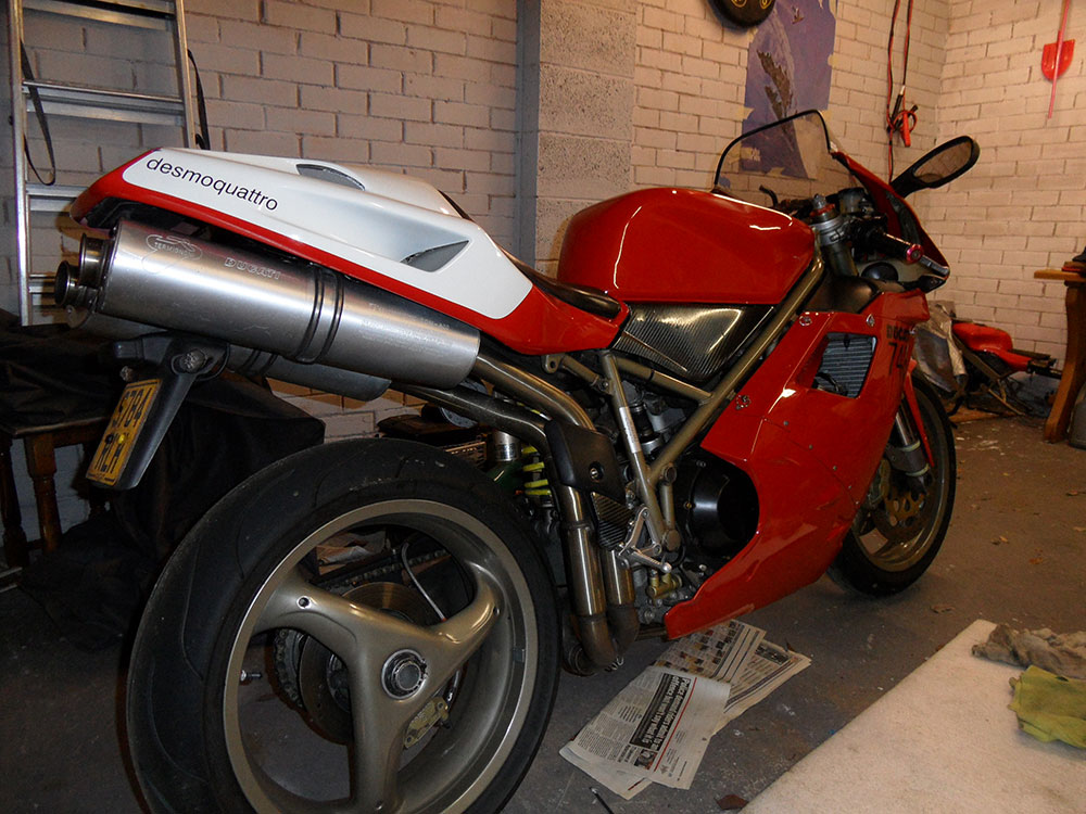

    I almost didn't get to take the 250 mile trip up from Kent to Scunthorpe, as my licence is currently with the DVLA meaning I couldn't hire a van, and I made the decision to buy a bit too late to secure a bike trailer. In the end I was lucky that my mates Ford Tourneo Connect, affectionately nicknamed The PopeMobile, was available, and after measuring up I was relatively (ish) certain the bike would fit in the back. Well I was just about right as the following photo testifies:
    And this is the current state of affairs:

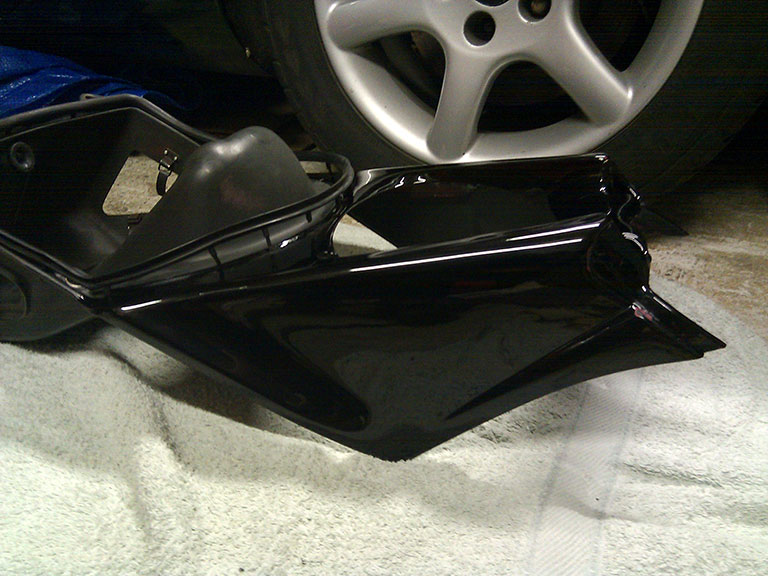

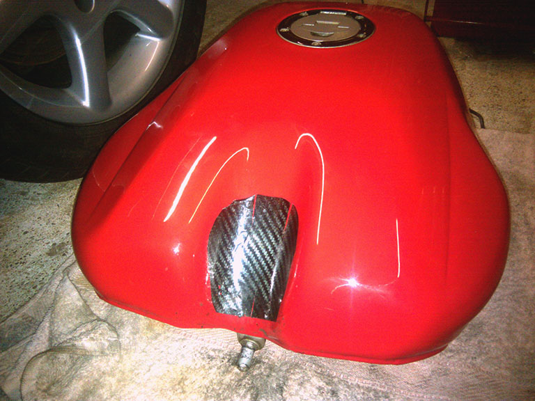

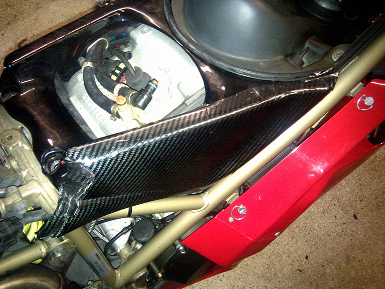

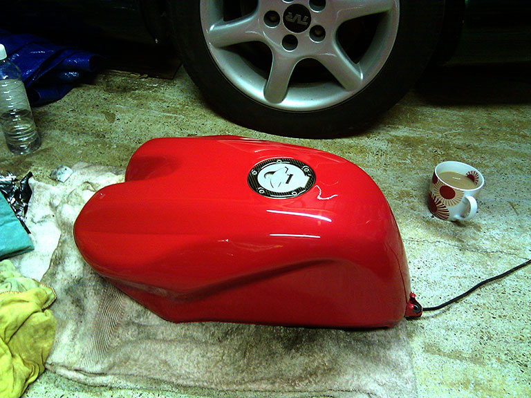

    The belts haven't been done in 3 years, so that's the first major job I'm doing. Ordered them from Moto Rapido today; superb price and the staff were mega-helpful. In preparation for receiving them I took the fuel tank off. As you can see in the pics in the first post, there is a bit of carbon fibre vinyl wrap on the bike. It looks good from a distance, but up close it looks a bit tatty (sorry 748 fidler if that was you who'd put it on). So I've now removed the vinyl wrap from around the ignition barrel and also airbox bit below the tank.
    The carbon fibre wrap on the tank
    The wrap on the airbox
    After removing the vinyl, taking off the remaining glue with some white spirit and then using AutoGlym Paint Restorer and AutoGlym Polish

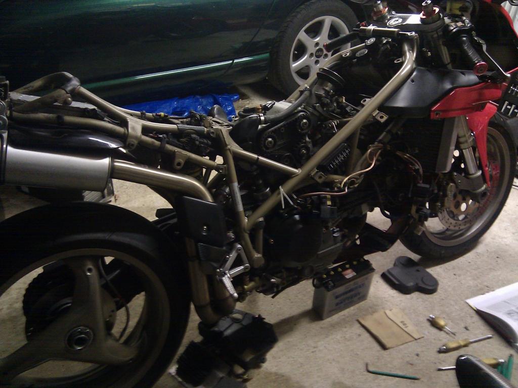

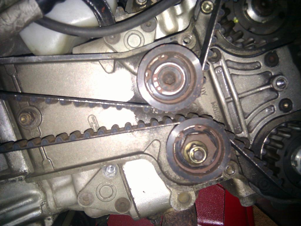

  11. Had my first ride on the bike this afternoon and WOW! The noise, the acceleration, the noise, the handling, did I mention the noise. Definitely made the right choice in purchasing this awesome feat of engineering. Got home after a quick ride up and down the road (read: an hour and a half around the A roads of Kent), thighs and wrists need replacing but it's a small price to pay.

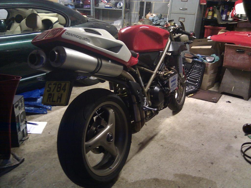

    Have spent the past couple of days in the garage working on her. Took half the bike apart to change the timing belts and valve clearances. Both were just a precaution as the bike hadn't been used much at all over the past year. Good news is that all the valve clearances were within tolerance. The closing clearances are dam awkward to measure though. Timing belt was pretty straight forward too - just care to make sure the engine is at TDC and the timing marks all line up, then whip the old belts off, put the new ones on, tension up and put everything back together! Glad I changed the belts actually, the old ones didn't have any writing on them at all. New ones are Ducati items with red writing.
    Couple of pictures:
    Quite close!

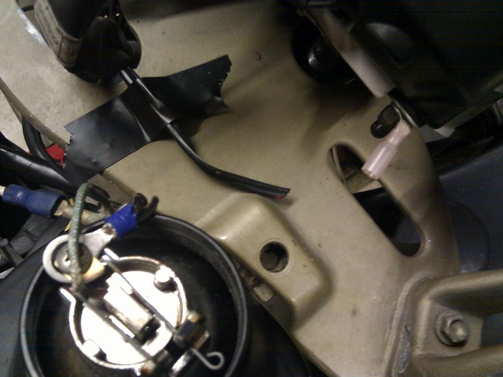

    Lastly, found this odd bit of wiring:

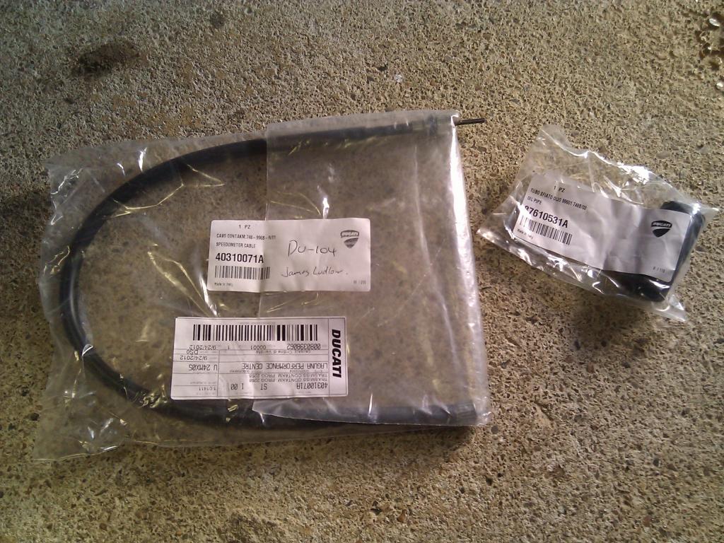

  13. Speedo cable had broke just behind the clocks. Not sure how it happened, maybe in transport if one of us had accidentally grabbed the cable whilst man-handling the front? Who knows. No problem, picked up a new cable from Laguna Ashford today for less than £25 and it's a doddle to fit.

    My speedo cable from Laguna Ashford and the new breather hose from Moto-Rapido:
