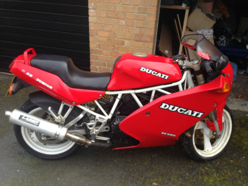

  1. Hello, I'm Lumbux(some call me Paul) and normally float around the SuperSport area but thought a project thread on my latest addition would be good. On Friday I left home for a 830 mile round trip to pick up a 400 SS Junior from Helens Bay, Northern Ireland. It took me 29 hours but was worth it.

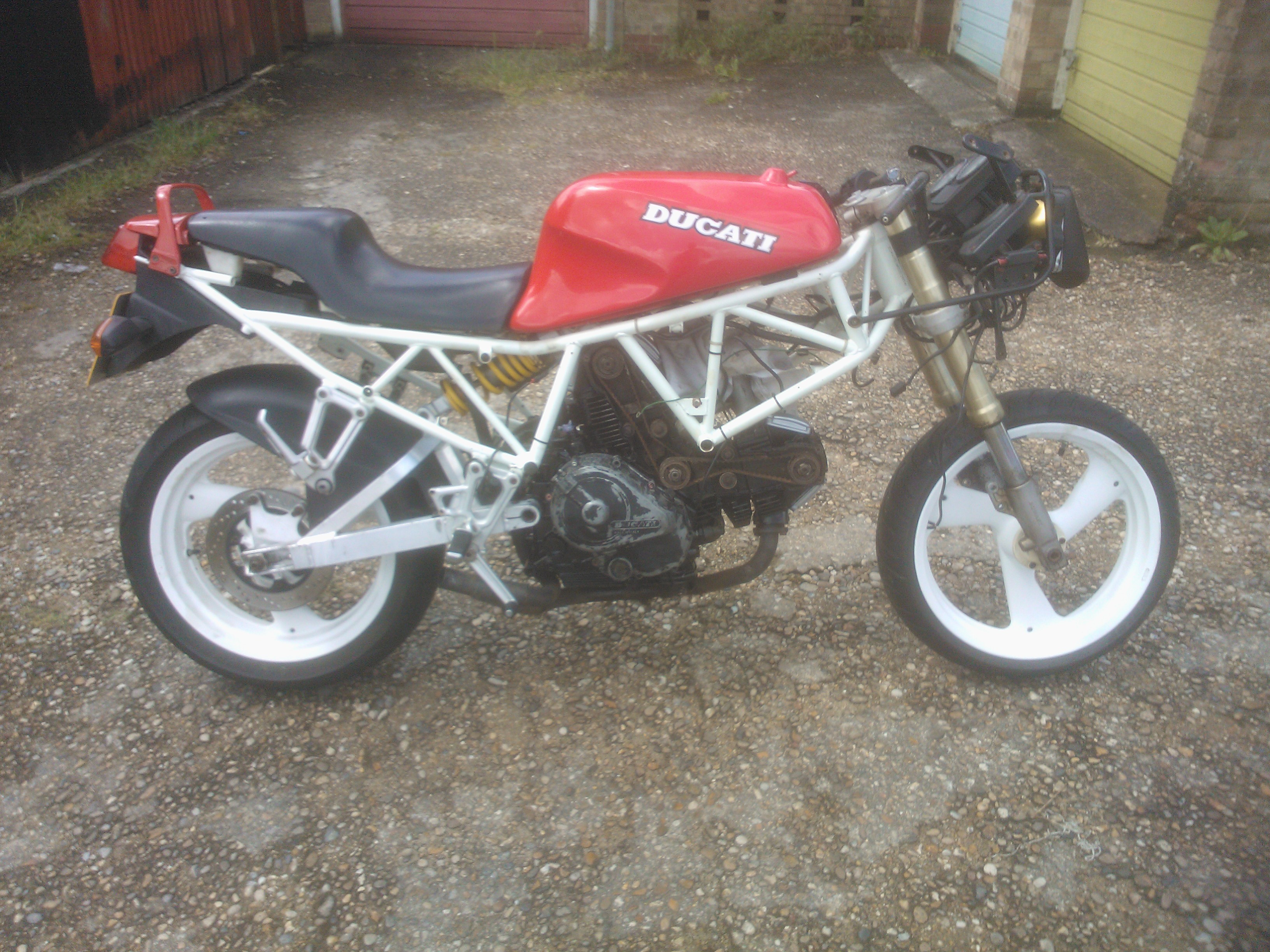

    It took me 45 minuets to strip the bike down and load into the car. My aim is to get it back on the road for less than a grand, including the cost of buying (£575). I will post some more pictures as I go but plan is to strip down, clean and paint engine, service and put back together. need to get it into a roller as were having a new kitchen soon and need the space in the garage!! Picture is before I picking up but will add more photos as things happen. One question, I cant seem to find the valve clearances, anyone any ideas or should I use the ones for the 750 I've got??

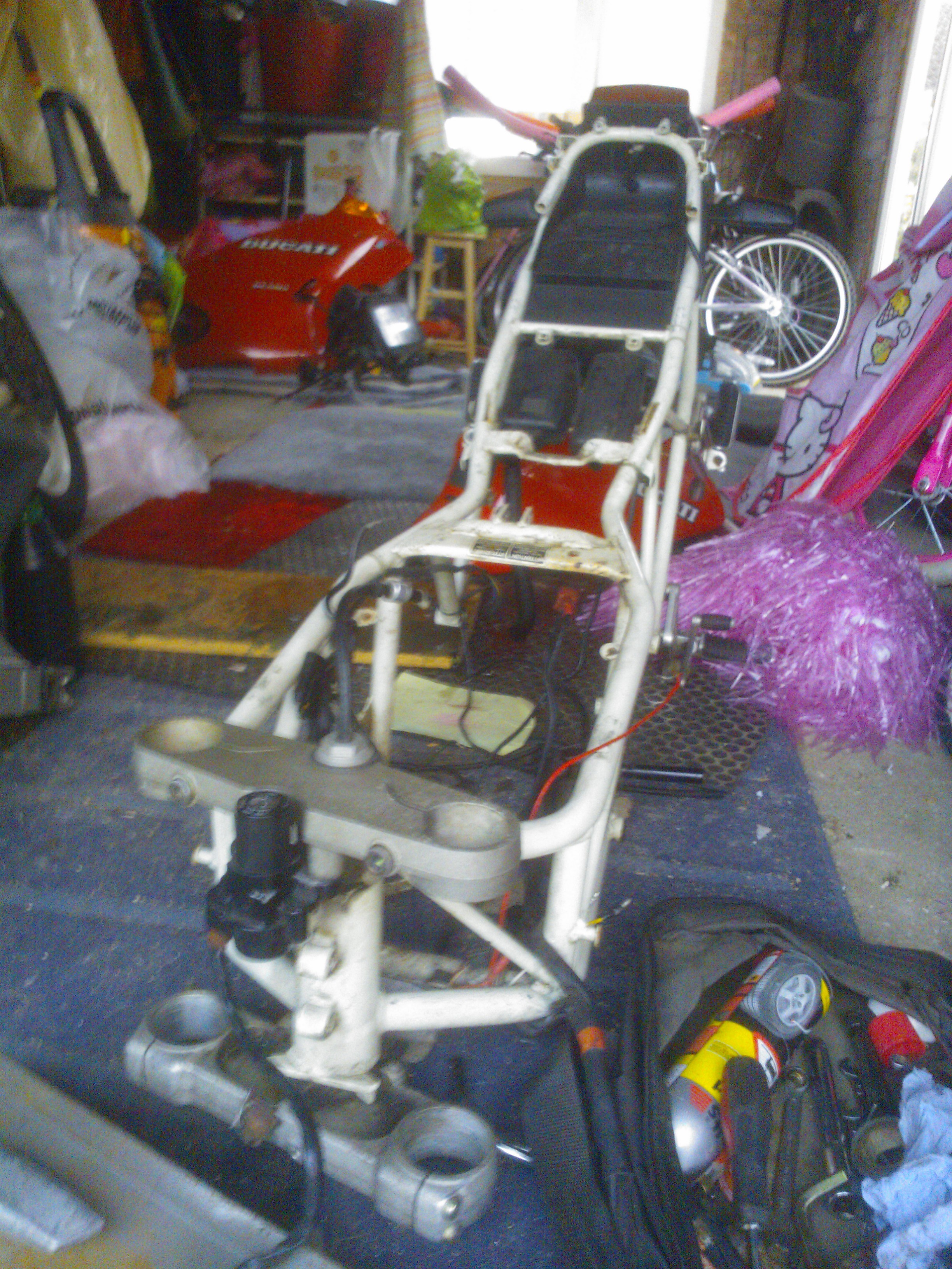

  7. Cleaned the frame last night and cleaned the steering bearings at work today. Hope to get the engine washed tomorrow, ready for paint. Hope to get the frame and engine back together next week.

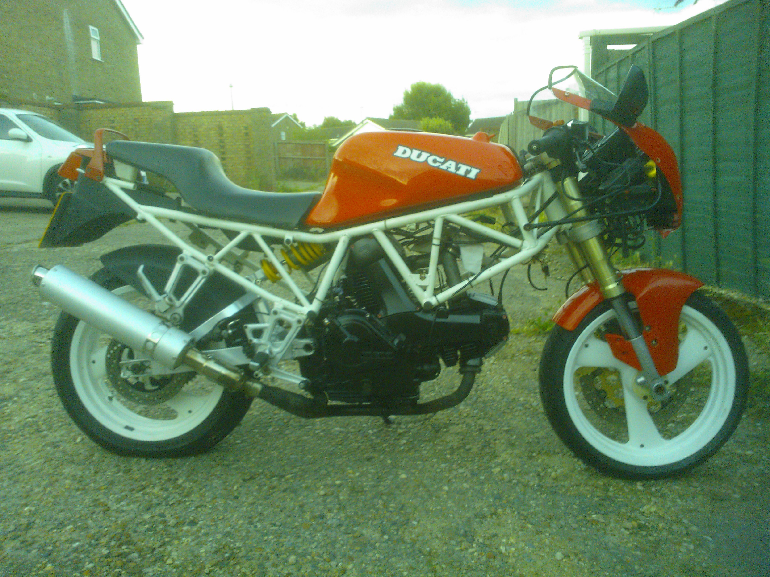

    Well all the fairings are cleaned and polished and in the loft as not to get broken.
    Took me hour and a half to get the fuel filler off, those damn grub screws. tank looks good, just one small hole in it, I'll fibre glass it up and pour some resin into the inside to help stop the rot. Next is engine clean, will get this done over the weekend ready for painting next week. I'll put some photos on tomorrow.
  12. Works comming on, doing a little everyday, fork rebuild next

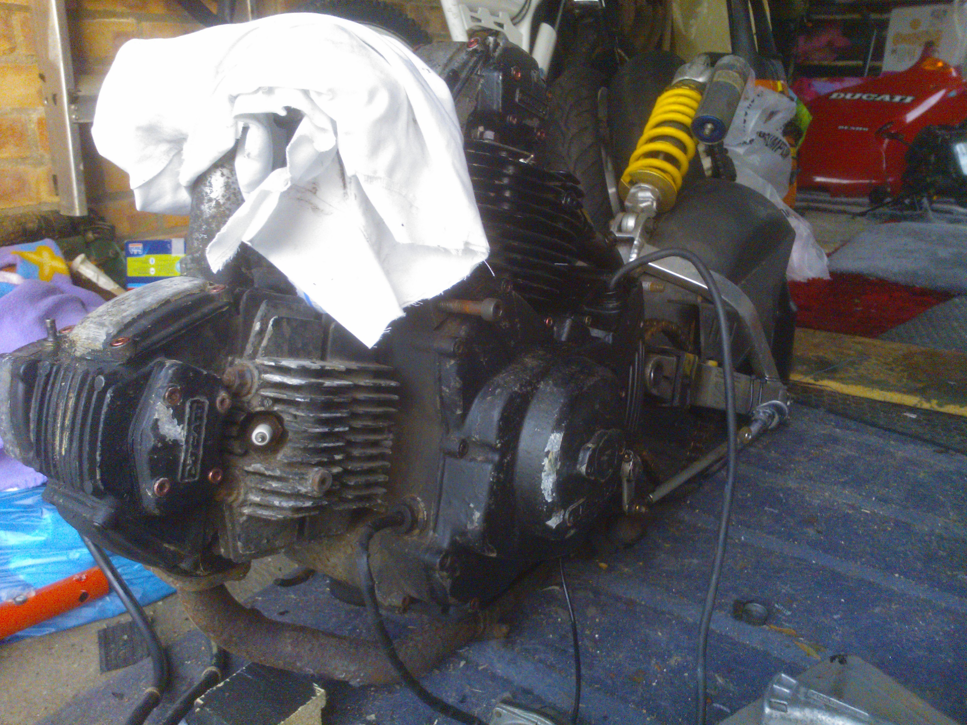

  13. Blimey, engine is a bit "crusty"
  14. It's like one of "The Levellers" of the engine world ;)
  15. You should be able to get some Brembo seal kits etc from Jim Aim Motorcycles at Sible Hedingham.........they are KTM dealers and a lot of Brembo parts on Ducatis were fitted to KTMs.....
  16. your engine looks tidy compared to mine,how you planning on cleaning it? if you do a good job you can clean my engine lol.
