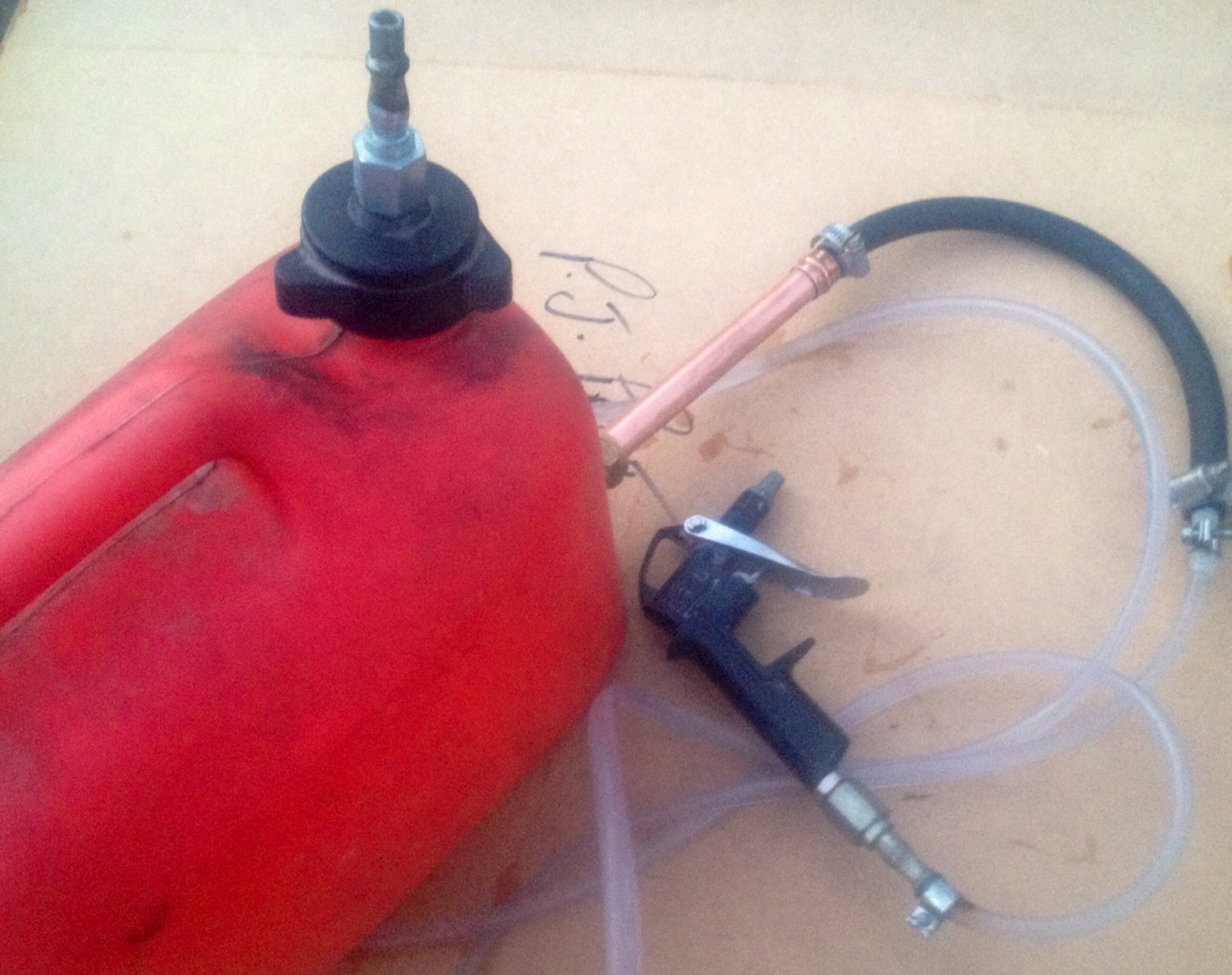

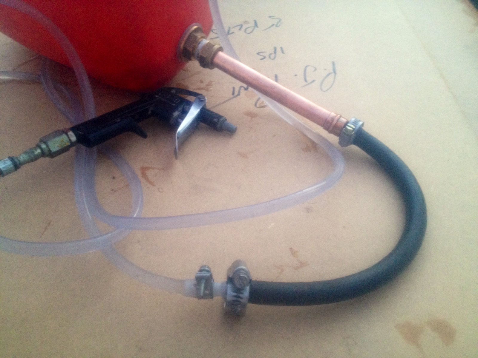

    I've just made this portable pressure washer.. ( my compressors mobile) thought it would be ideal for cleaning off when I use my B&Q sand blast box..

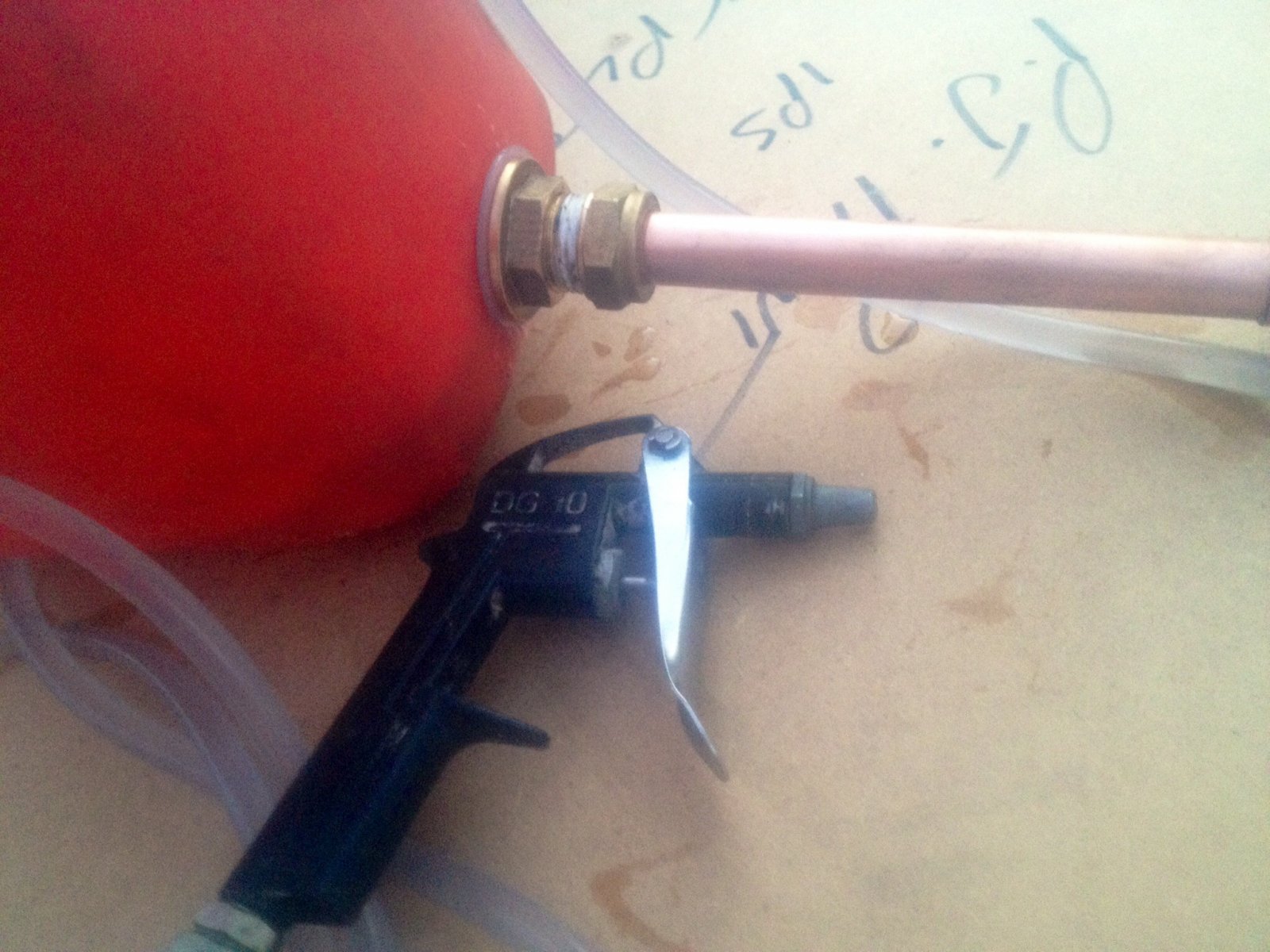

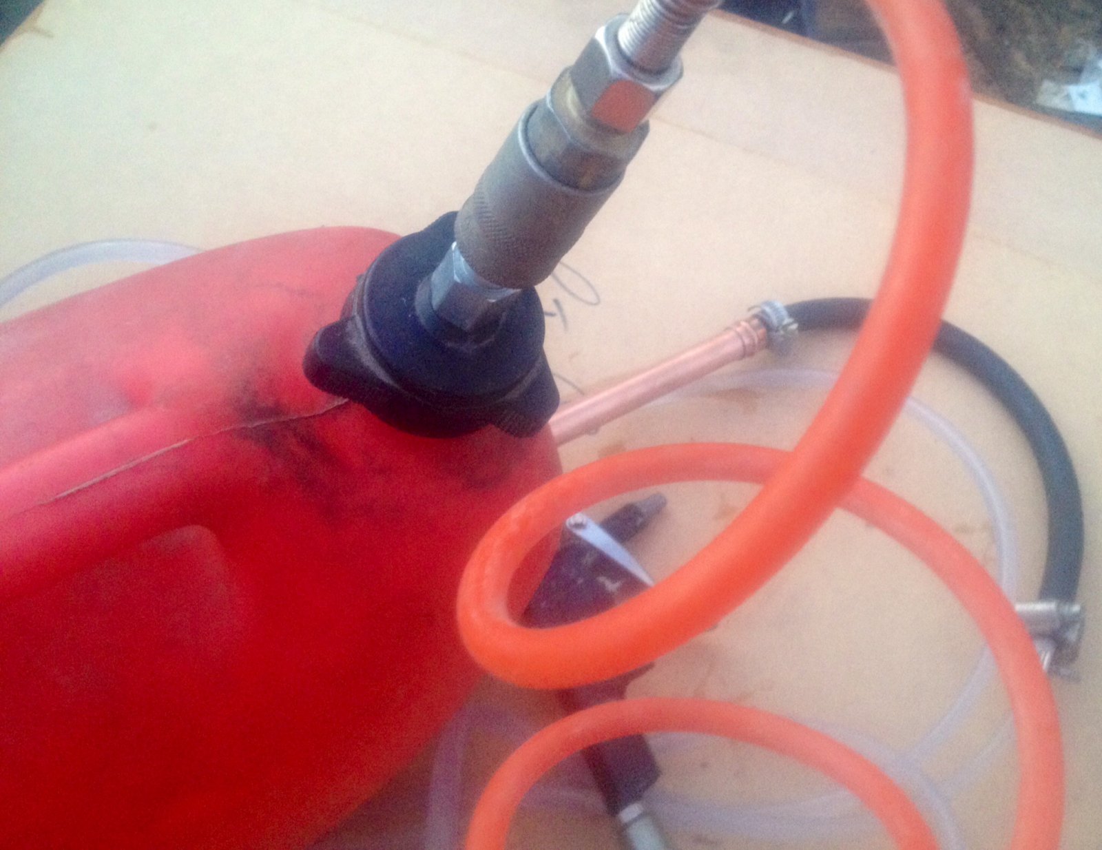

    Found the old fuel can with no leaks, drilled suitable hole in top and fitted quick release air connector which goes to my compressor.. Scrap copper pipe and cheap air blower gun rescued from you know where, old rubber pipe from same place, clips and copper joiner from stuff I had lying around in workshop, union fitted to bottom of can from an old overflow / system tank again from the place my poll tax helps to run..
    50 mins later and it's all working great.. At 30 psi it projects cleaning fluid/water a good 20 - 30 feet down the garden.. The only part I had to buy was the connector for the air blower gun £2...
    The petrol can is the hard ridged kind so it works great, just fitted my inline regulator to air feed, half filled can with cleaner and water.. The air fills the rest of the can, press the gun and away you go ..
    Recycling is the way forward.. Now where's that old jerry can I got from the tip, that would hold even more...

  17. In principle excellent.
    However I doubt very much that jerry can is pressure rated, even to 30 psi.
    Stored energy can kill, even at low pressure.

    However as a scavenger, and ex mechanic I've already got that one covered, quite literally. I Welded a steel cage together which bolts down to the floor either inside my workshop or outside. I put the Jerry can inside that..
