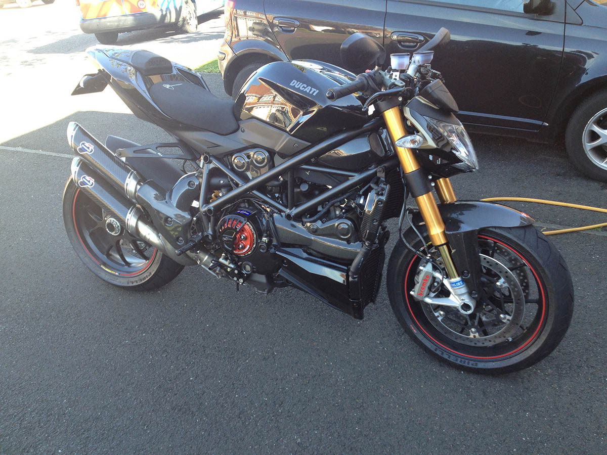

  14. I have just bought my second s, for reasons I won`t bore you with. A 2009 but with masses of DP stuff, Termis, very low mileage, and (I think) a reasonable price.
    Will eventually sell one and am hoping that their rarity will keep prices high.:Greedy:
    Go for it Lewygoosy. They are wonderful. You too nothingfaced.
  15. Aerodynamics?
  16. Another to tease you.Put the large air ducts on for a real mean look
  17. looks mean as hell with the black on black frame. Gorgeous bike you have there
