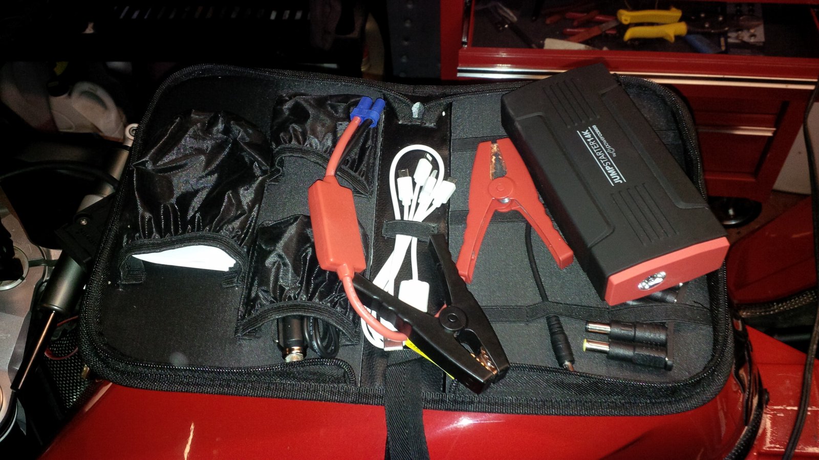

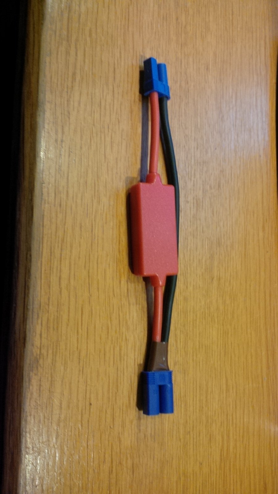

  6. Morning Guys and Girls, well the mini jump start finally turned up! 14000 ma looks impressive? a lot bigger than the 8000 they sent before, they sent me the whole new kit so i have still got my old one, i disconnected my battery from the 1198 connected the jump starter Hey presto! started first time, Fantastic, 2 days later my VW Caddy diesel van battery went flat connected the jump starter started first time!, i hadn't even charged up the starter pack between using it, this seems like a great piece of kit My kit, came from a company called Powercase in Canada, the director was very apologetic when they sent the wrong battery pack in the first place, but give them there due they sorted it. The new kit they sent also includes all adaptors for phones/lap tops, pads etc plus a anti surge lead between power pack and bike, i will get some pics later today of my extension lead under my pillion seat

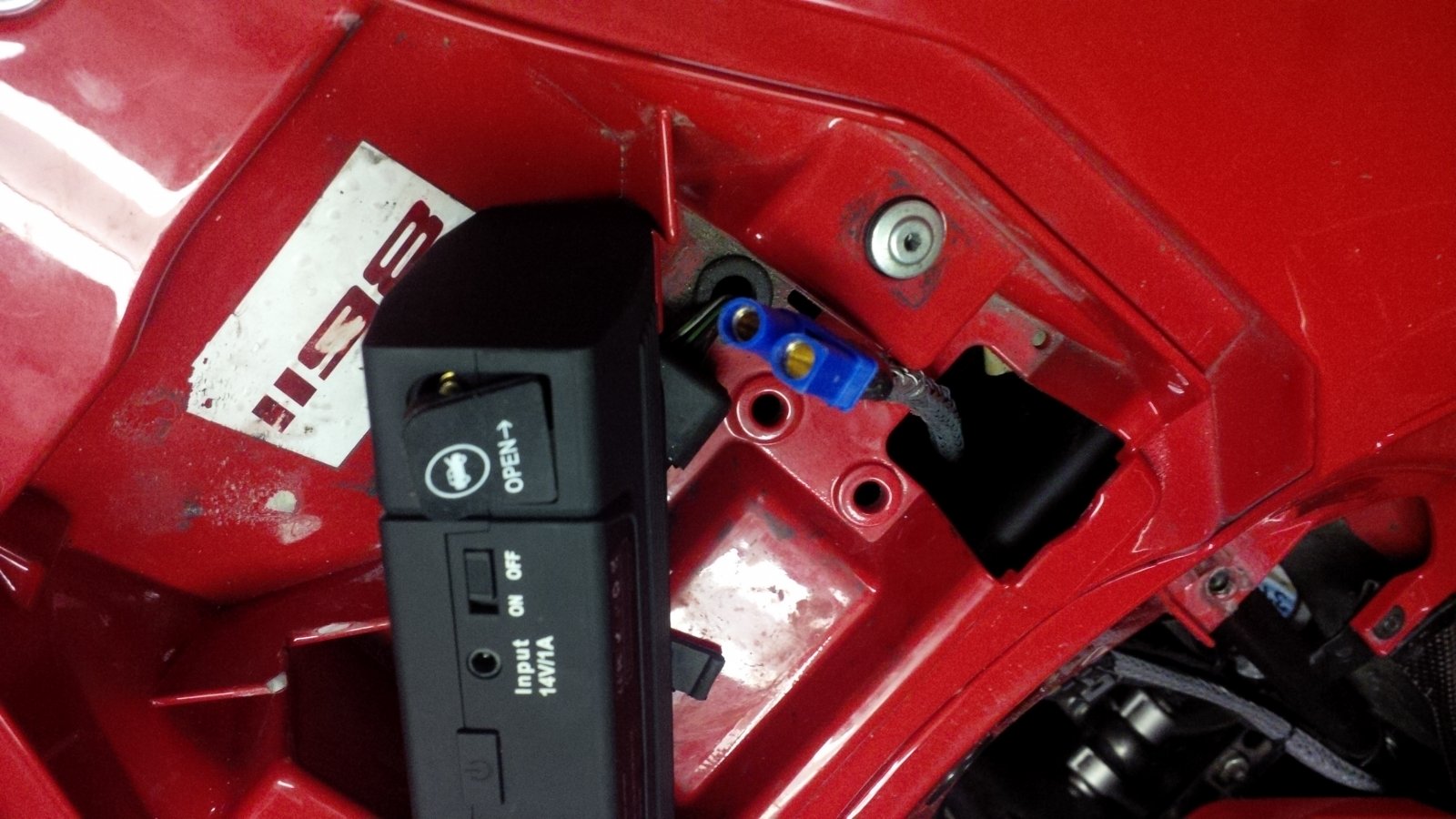

  7. This is the power pack that works! as you can see i have run a pos and neg from my battery to the pillion seat which has the same plugs soldered on as the jump start pack, i also adapted the anti surge lead to plug into my bike then into the starter pack, makes life a lot easier than removing the fairings etc IMG_20150211_080133.jpg IMG_20150211_080244.jpg IMG_20150211_080244.jpg IMG_20150211_080503.jpg
