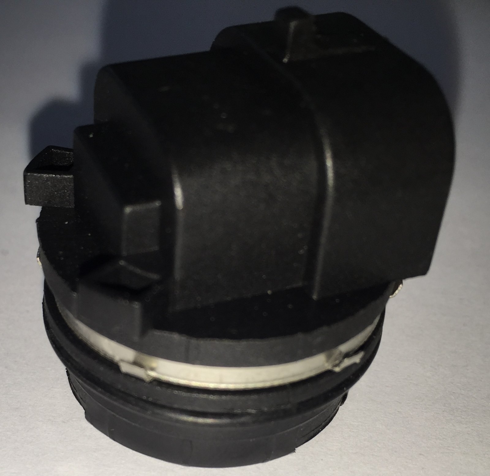

  9. Most bolt on and off, the 999 one has one use clips which are destroyed on removal - it's a gentle prise and ease the old one off - you can see the clips on this new one here to get an idea... never removed one myself so not sure how much force is required...

  12. Thanks all - been at work today and not allowed to post there so could read all this useful stuff but not reply. Sooo, I can remove the original but it'll destroy the clips - not a problem as I have a replacement part, it's a standard Fiat parts bin item so easy to get hold of. ;-)
    I haven't taken the old one off yet so can't work out if it'll go in the other way around or not.
    Ah so why am I doing this someone asked - well my 999 has two throttle bodies but of the pair the one with the TPS is the important one. So, when I lopped off the rear cylinder for fun to make a single cylinder I only need one throttle body. The problem is this now needs to become the front throttle body and keeping the cable routing for the throttle in the same place to avoid using custom cables means that TPS is now at the front right of the airbox and even with a new hole and rubber recess fitted in the airbox the TPS is snug against the side. When I plug in the loom, the connector wire is bent back over tightly so if I can put the TPS in 180 degrees rotated, it'll face backwards and the loom plugs in at a wider part of the airbox - no bent wires or tightly packed connectors! But before I went and trashed a throttle body I wanted to know it could be done so thanks for the info and experienced support (finm and exige for the detail!), it's much appreciated. I need to get a nice FIAT jobby now and have a go... :)

  15. Well that's that question answered! I can get the old TPS out and fit a new one but not 180 degrees turned. The throttle body shaft is slotted one side only. I could take the shaft out and rotate it 180 degrees too if it wasn't for the throttle cable pulley being pressed on so that just won't be possible. Even if I could turn that 180 degrees, the TPS has a locating pin that only has one position in the throttle body itself. So, long and short of it is, I can't turn the TPS through 180 degrees and I'll just have to put up with squashed wiring!
