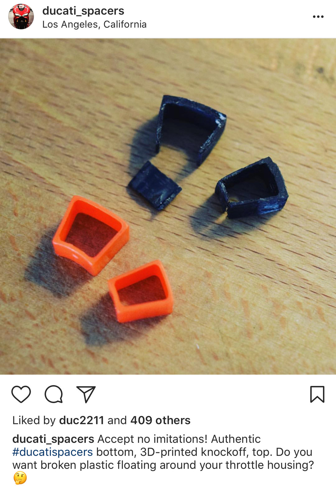

    I have ordered the Spacers very cheap from a guy in Germany who made them through his 3D-printer (material is ABS - same plastic as those LEGO play stones are made of).
    Wil let you guys know if the upgrade is worth it or not.

  10. I’ve had them on my 959 and 1299. The biggest difference is when you are going on/off throttle (in slow traffic of the transitions through/out of a bend when you want to bring it on gradually)... although you can sort of get used to it, the movement at the start takes away precision in those gentle moments. I’d do it every time.
    I’d also advise against 3D printed ones because they fall apart, and you don’t want bits floating around inside the throttle.
  11. This is why I’d only use quality spacers....
  12. Depends on which material you print them. ABS material sounds good to me and they are red too. But thanks for the advice - will check mine thoroughly, and if they are delicate to brake I won't put them on.
  13. Okay guys - after installing the spacers and a proper testride here's my Verdict:
    1. Check and doubl-check the placement and use a fine rasp to adapt size if necessary (as with mine)
    2. Go and buy them. :upyeah:
    The throttle play is gone (as expected), but also the upshifts works smoother now and the mid-gas while downshifting does not move the bike a split-second forwards as before. Holding an exact speed is just a piece of cake now, also in lower revs.
    3. I will recheck my aftermarket ones frequently (at least thats the plan), but the improvement in feel and response is so good, I would invest 150,- EUR easily for that.
    Cheers
