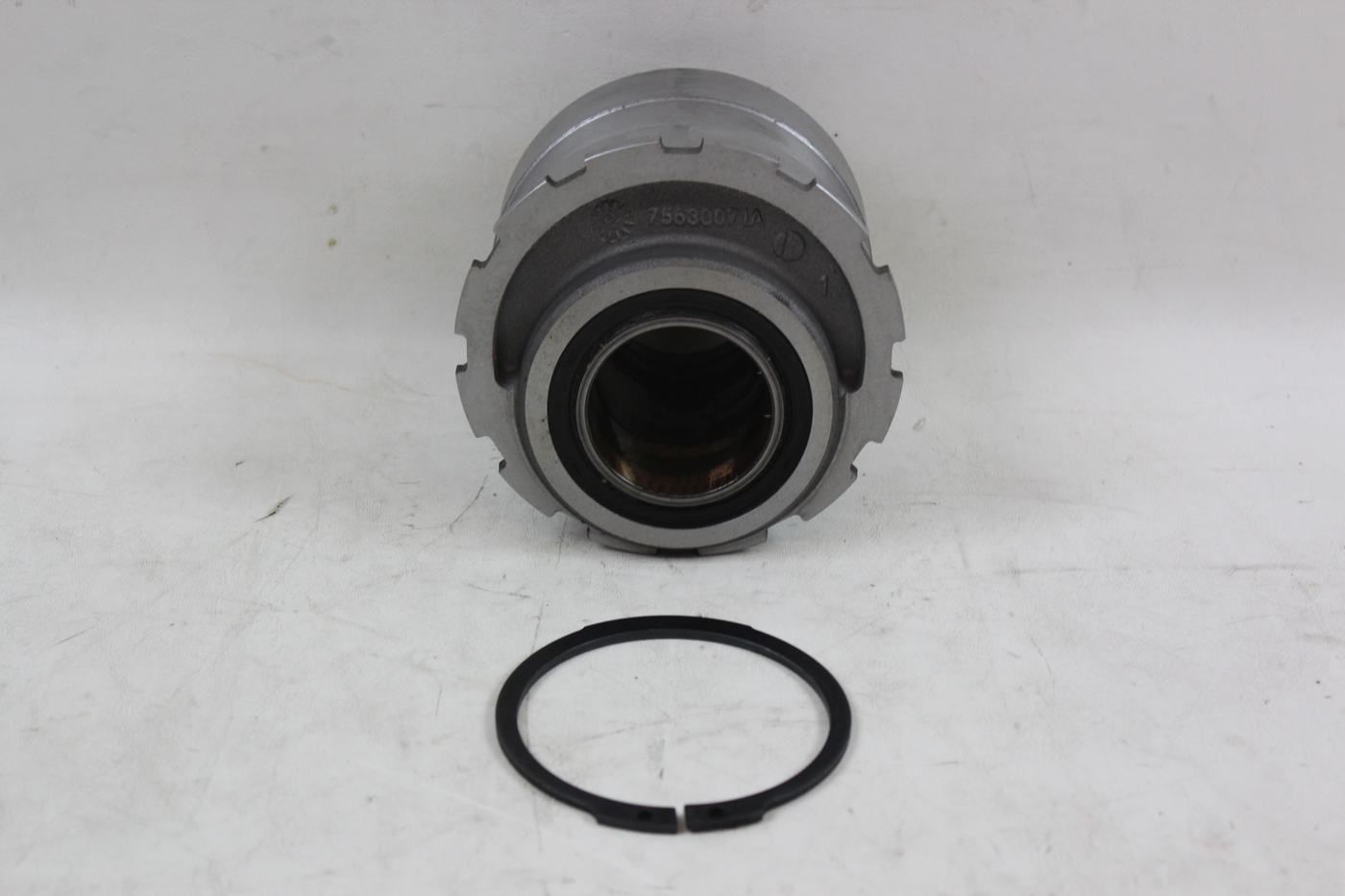

  2. Surely it's the same as any of the SSSA models, loosen hub, rotate it, nip it up & adjust link rod for ride height.

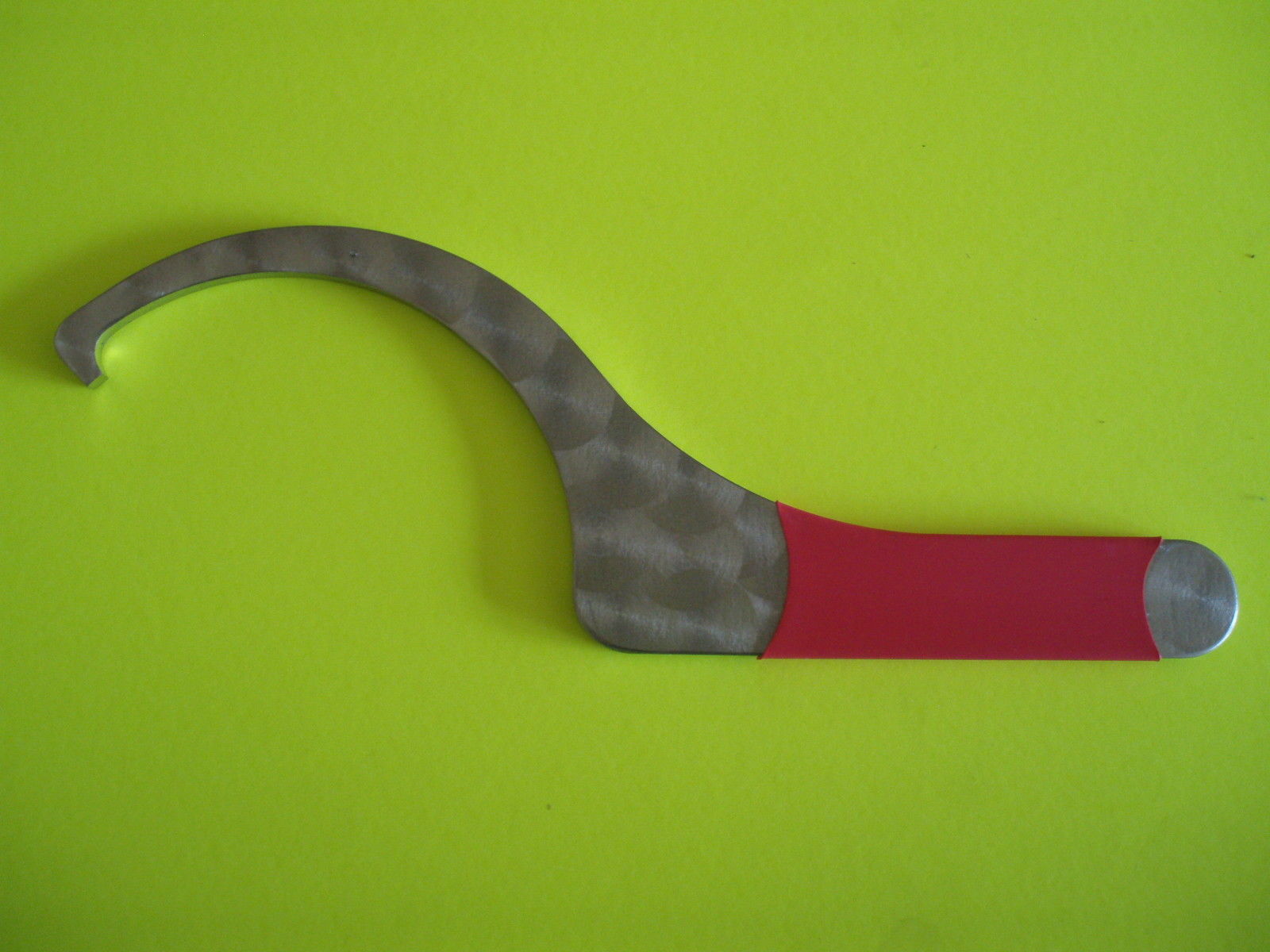

  3. I'm ok with the 955 Daytona which needs a special tool to rotate the hub, not seen this carried out on an 1199 though. Any pic's would make it clearer.
  4. Yep. that's the baby. I'll see if the Daytona one fits or find one that does. The toolkit - will check - is under the seat and about the size of a - very small - box of matches so doubt it includes an adjuster.
