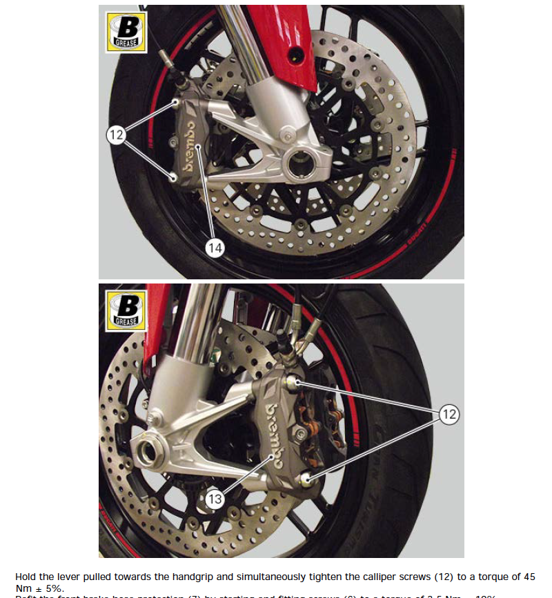

    The correct torque setting is 45 NM
    "El ajuste de torque correcto es 45 NM"
