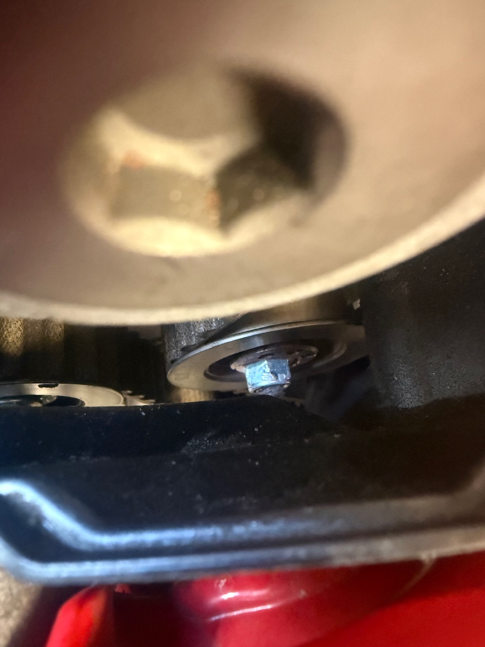

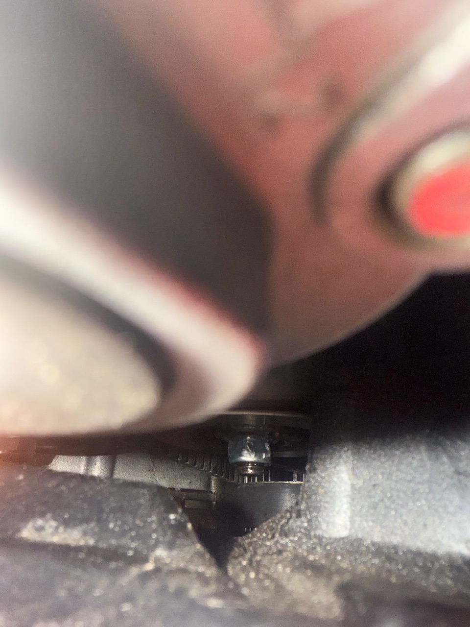

  16. :joy::joy::mad:. I had one this week where the Fuji nut on the tensioner had been rounder off by a previous individual. You can just see it in these photos if you look carefully, they were taken from above, looking down.
    It made it impossible to get a spanner on it, and when I could it just slipped off. I’d swear the thing had been tightened well in excess of 25Nm too.
    I ended up having to cut it off. Could just get the tip of a burr grinder onto it and had to grind away one face of the nut until it was weak enough to split and come off. Over an hour’s work on one nut :confused:
  17. Phew!
    I think I am going to have a lie down! :joy::joy::joy::):upyeah:
  18. Oh, and looking at those photos @glenandem reminds me, the crankcase breather pipe is in the way too, and has to be dealt with. Another PITA. Detach at the crankcase end not the airbox end, you’ll never get it back onto the airbox spigot, it’s hard enough getting it back onto the crankcase spigot.
