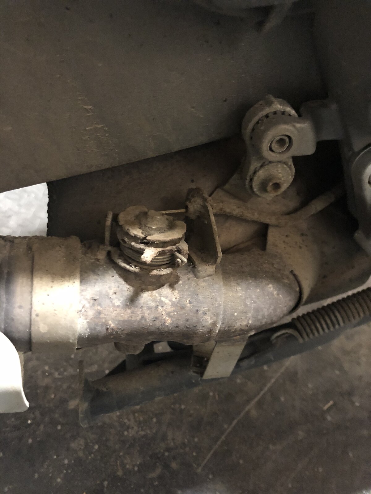

Removed the black exhaust cover. Is this the exhaust valve that might be stuck? It is minging with dirt! There’s a cable attached that looks ok I think.
That looks well corroded, I think that would be a large part of your issue Clean all that up and lube it. You could do with the silencer off too so you can see if the valve is moving inside the exhaust.
Mate that is minging. The valve should rotate. Lots of WD40 to start. Drop me a PM (touch my avatar and hit start conversation). Happy to pop over tomorrow. Andy
That thing looks like it’s been at the bottom of the ocean for a while, like it was part of some old shipwreck.
Once it’s free it will rotate when you turn the Ignition on. Then once it’s free get one of the Healtech or DucEE plug ins and you will never have the problem again (no downside)
An image like that could get you banned from the forum! Have you seen how clean some of the bikes are on here!?
Believe it or not I do wash it at least once a month. Used every day come rain or shine. Presently collecting a solid covering of road salt so probably time for a good rinse!
From the looks of the awful state of the metalwork, it appears to be well and truly lacking in likely movement. I've seldom seen worse to be honest. That being the case, it will almost certainly be the reason for your throttle issues. Once you've sprayed the area liberally with WD40 or some other similar rust penetrating spray and left it to soak for a while, say 2-3 weeks (I am joking!), then attempted to ease the flap valve by hand, I would suggest after it moves freely, spraying it with ACF50 or such like. Then periodically checking the valve/spring action and re-spraying as suggested, should keep you on the move more smoothly. If you don't with to adopt the HealTech or DucEE electronic gizmo approach, detach the valve mechanism and add a spring or two to the cable activator to replicate the spring action, which will also fool the system into thinking the flap valve remains fully functioning. This method has been well described in numerous posts on this forum, so you should be able to see what I'm talking about. Good luck with solving the problem.
