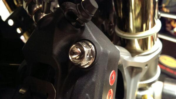

  1. Thought I would change the stock caliper bolts to some nice pro bolt titanium ones,when comparing them,they look different ,can one of you guys just confirm that they look ok,cheers image.jpg
  2. Are you asking if they will hold your calliper on then yes.
  3. Nope crap, never work.
    Send them to me, I'll fimd a use for them ;)
  4. They look different to the stock one on the left.
  5. Threads the same. shaft is narrower at the lower part. i guess to save weight...lol.
  6. Standard bolt has cut threads, Ti bolt has rolled threads.

  8. Ti is too hard to cut, rolled thread die. Stainless can be rolled also but cheaper to cut.

    like braiders said, just fit them, and at the pub nobody will have a clue they're Ti until you point to them and tell them.

  16. They are correct, fit them, both bolts have rolled threads for what its worth, cheap eBay Ti bolts are often cut threads, a lot of Pro Bolt stuff is made by Racebolt, pay Probolt a visit and ask to see the manufacturing plant ;)
