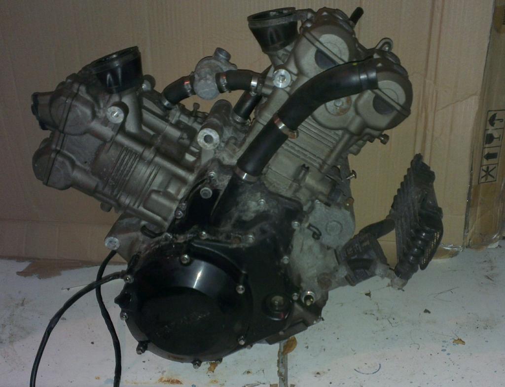

After the gearbox ate itself due to cautious careful riding :biggrin::biggrin::biggrin: I thought it time to take it out and fix it. First thing I noticed, it's a damn site lighter than my 996 motor. Barring a 4 prong socket to take off a type of castle nut there's been no special tools needed yet either. If anyone's actually interested I can post some pictures of how the strip/build go. But I'm guessing it's the wrong forum for it.

Yes,best bung some pics up of the rebuild.Ive got an S lump spread over one of my work benches waiting to be stuck back together.

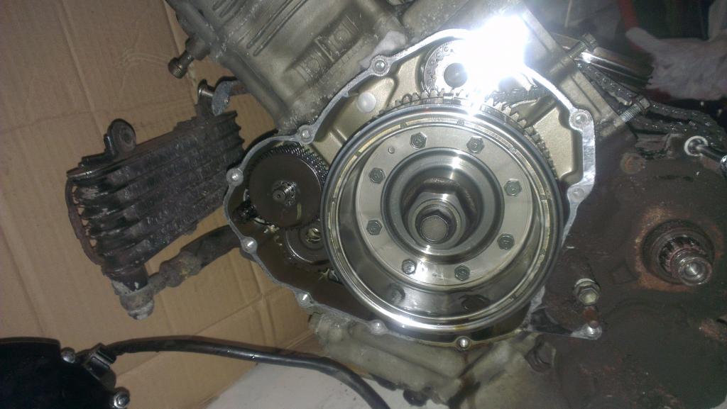

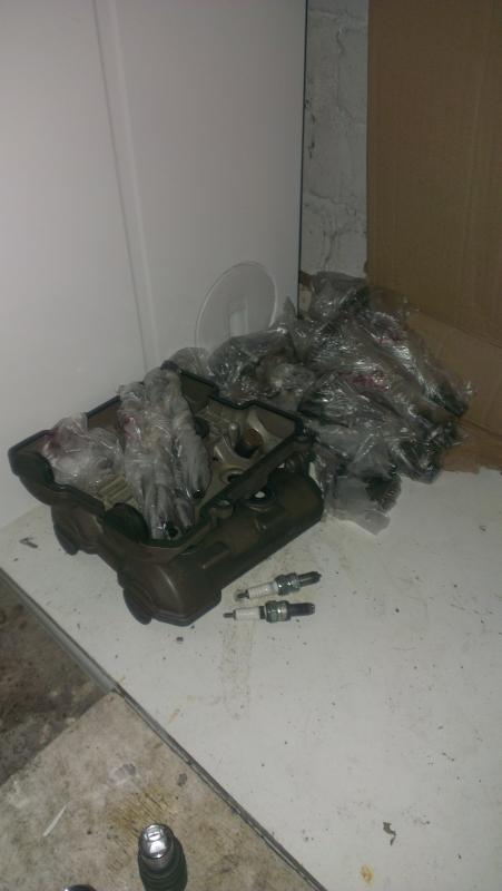

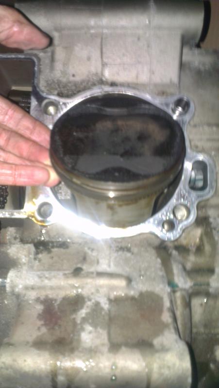

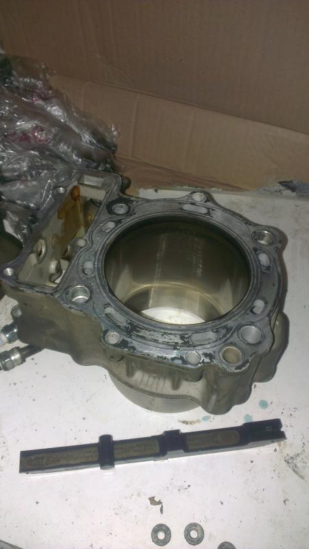

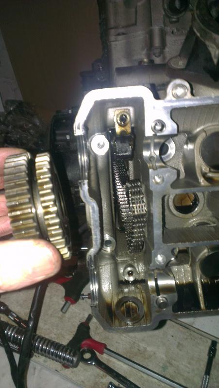

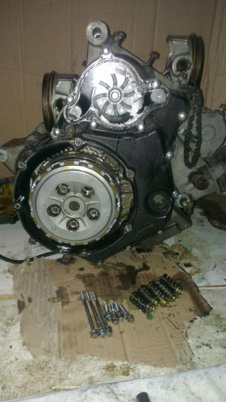

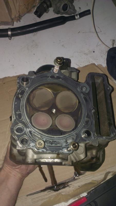

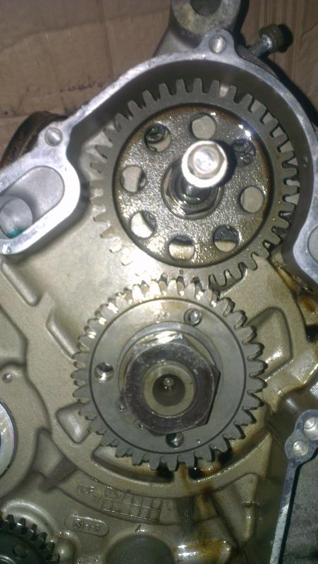

OK, so here we have the featherweight engine. Cam covers off. Cams out. Ooooooops. Taking the Idler gear out I hear the tinkle of something metal falling into something metal. How glad was I to see a spacing washer where you do in the pic. All valves look pretty good in the rear. Barrel good too. Yep. If the front's as good as this the bikes a keeper and I'll not mind shelling the money out to fix the box now. Piston Good. Beautiful tabs on the alternator cover front and rear are perfectly placed to rock the cover off. And finally the alternator and amazing floating gear. It's a piece of cake to work on the TL up to now. I can see why Ducati mechanics earn their money. I just hope it ends up going back together as easy. But having all parts bagged and/or labelled should help. I'll let you know what happens tomorrow. Maybe nothing.

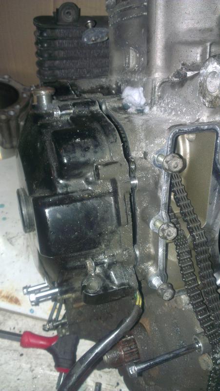

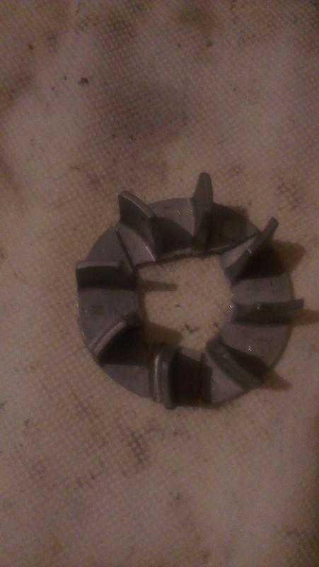

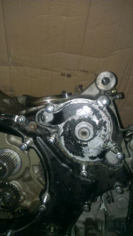

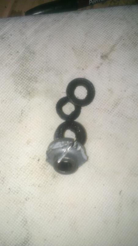

So, another day, another new swear word to invent. This morning the front head came off, along with the clutch and water pump covers. Then clutch came out, a slipper clutch no doubt with this being the first production bike fitted with a one from the factory. But the water pump impeller wouldn't budge. Draw it off the shaft the book says. Hmmm... pair of screw drivers down the back should do it. Ooooooh. Erm... Dremmel time. Aaaaaannnd the right casing is off. Big nut of a size I haven't got here, and the need for a flywheel puller stops play for today. :frown: The good news is the piston, barrel, valves and the likes of the front pot is as good as the rear, I can't feel any nasty bearings, all nuts so far have been undone by a skinny bloke with a dumb bell bar as a ratchet extension, and the shopping list has started :smile: SHOPPING LIST. 1. IMPELLER. I hate buying tools twice, or if I can borrow them from work. So I don't know when I'll post any more news as my tools are scattered to the 4 corners of the world and I'm not in work until Tuesday.
