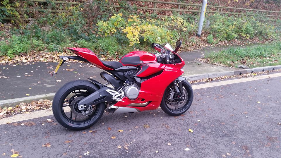

  9. I have it on my 899, was on there when I got it in September. Seems to be holding up pretty well so far (about 1k miles) but we will see long term.
    From more than 3ft u really can't even see it!!
  10. [​IMG]
    Last shot of the tank may show it better
  11. 9k on my 899 since ventureshield & still looks mint.
