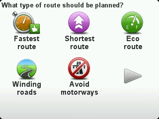

  7. The Tyre help menu seems pretty comprehensive.
    "4. If you have a TomTom device, change the following option (you have to do this only once):
    Change preferences --> Planning preferences --> Ask me every time I plan --> Done --> Done "
    Followed by
    "Here is a description for TomTom devices
    Itinerary planning --> Options --> Load Itinerary
    [​IMG] You will be asked if you want to remove the current trip. Select 'Yes'.
    Select the itinerary you want to use and confirm with 'Done'.
    TomTom will ask you if you want to navigate to the destination of the route. Choose 'Yes'.
    At this point you can select your trip's type. In most cases it is wise to select 'Avoid highways'. But of course you are free to select the type that your prefer. Confirm with 'Done'.
    (If you cannot select your trip's type, you have to change the preferences in your TomTom. Go to step 4 above.)
    For different TomTom device types menu structures and images may be different."
