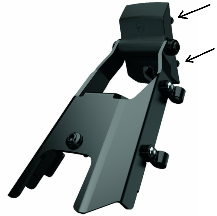

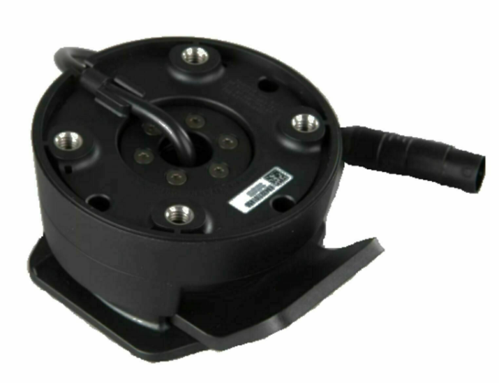

  1. I've come to hardwire my TomTom rider 410 in, straight away come up with an issue! - Wonder if anyone has done this and what the solution is?
    The Nav holder can only be screwed in from the front -
    Now the TomTom hardwire mount can only be screwed in the back (that's what she said).
    I don't want to use a medley of ram mounts as it will stick out too far - what the hell do I do?
    Cheers.
  2. You need to replace the stock mount - I think the guy from iconic (Jamie?) who is on here does a plate that might fit but check out his website also.

  3. The Ducati nav bracket has something of a propriety mount plate and only fits the Garmin Zumo 390/395 models that they were pushing as the Ducati nav solution.
    The Ducati bracket can be adapted to the regular AMPS hole patten that the vast majority of sat nav cradles have by the use of an adaptor plate that replaces the plastic 390/395 mount plate. A member here used to make them, though no longer I fear. It was Desmo Dave, worth giving him a shout if you do need one, he may still have them in stock.
    I have one of these adapter plates currently in use with the Ducati bracket and my Garmin XT. You do need to bend the metal arms of the bracket apart slightly for the new adapter plate to fit.
    If you don't already have the Ducati mount I suggest buying an alternative one with the AMPS hole patten such as the Iconic.

  4. I use a similar, but better Nav mount. Similar to the Iconic mount. The Navihalter mount. Its way better for mounting a TomTom. That one you can mount the Nav holder
    from the back.
