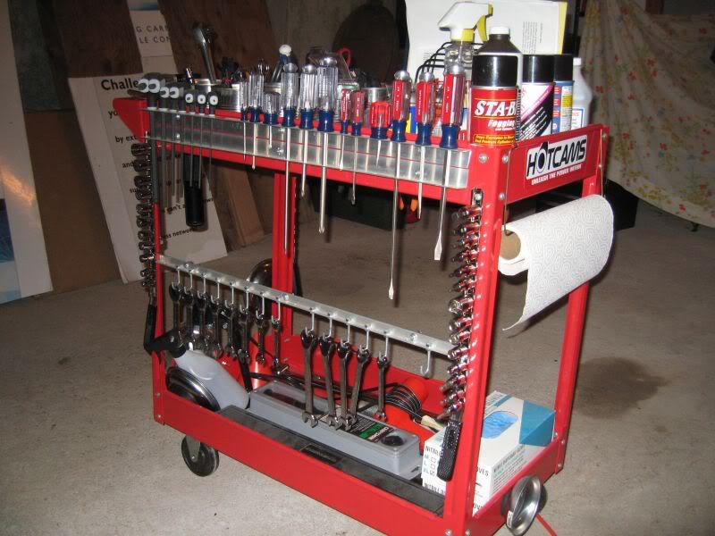

  1. I saw this whilst looking for a tool cart I thought it was good idea. Does anyone else agree, I copied and pasted the rest so the comments are not mine below.
    I particularly like the way he has secured the extension lead to the cart.
    I totally stole this idea from someone in ADVRider, but I cannot locate the original post. In any case, thanks!
    I wanted to have easy access to my most frequently used tools and also a convenient place to store them. A big rolling toolbox is expensive and never really appealed to me. What’s pictured below is a $30 (on sale) Harbor Freight tool cart that I have customized a bit.
    I bought a piece of aluminum angle stock, cut it in two, clamped the pieces together and then drilled appropriately sized holes for the shafts of my screw drivers and T-handle hex wrenches. I bolted the aluminum pieces one on top of the other along one of the long sides of the cart. Below these I added a smaller aluminum angle bracket with hooks to hang the ratcheting combination wrenches – regular and shorty lengths.
    I added a power strip, extension cord and a couple of hooks to store the extension cord on, all at the bottom of the cart.
    I bolted socket holders the cart’s corner posts and populated these with my most commonly used sockets, hex bits, etc.
    I bent a coat hanger to hold a roll of towels and added it to one end of the cart.

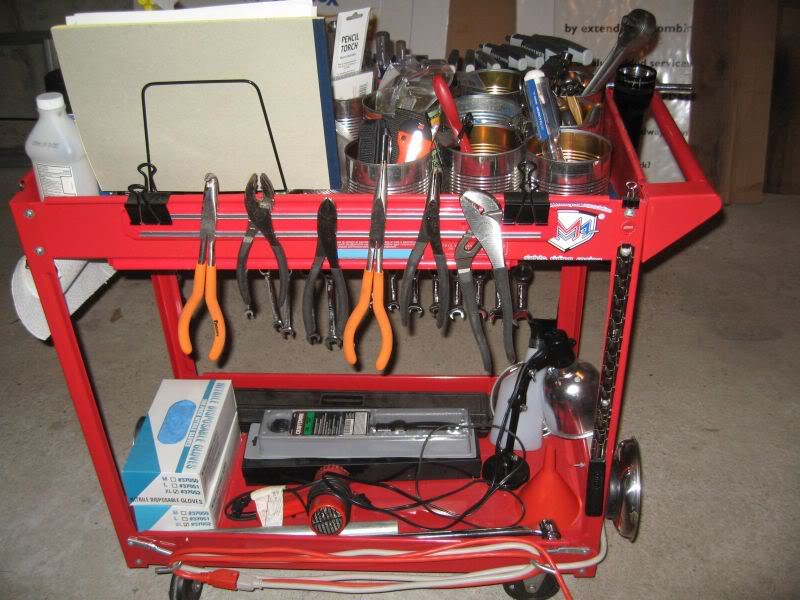

    I’m toying with the idea of adding a magnetic tool strip along the other long edge to hold pliers. I have it clamped in place at the moment to see how it works..
    The cart has two shelves. The top one holds smaller tools that don’t otherwise have a home, chemicals, notepad and manuals – and just general odds and ends.. The smaller stuff I keep in cans for organizational purposes – one for small pliers, one for small tubes of chemicals, etc.
    The bottom shelf holds larger tools such as torque wrenches, a box of nitrile gloves, a set of oversized sockets, breaker bar, long socket extensions, etc. It also has a lamp with a magnetic base that I can stick to the cart or on the bike. Magnetic parts bowls are stuck here and there on the cart.
    The cart has a handle at one end that I use to hang a Maglite and my 3/8-inch socket T-handle.
    I keep the cart stashed in a corner of the garage, covered by an old bed sheet. It’s a cinch to roll it to the bike, unwrap the extension cord and plug it in. Then I have immediate access to common tools, chemicals, paper towels, gloves, etc and plugs for lights, power tools, etc.
    Not only can I readily lay hands on a desired tool, the tools all have a home that I can easily return them to when I’m done with them. It really does work well for me and the total investment (minus tools, obviously) was around $60 for the cart, aluminum stock, power strip, extension cord, lamp and various fasteners.
