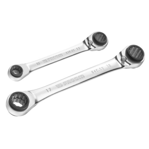

  16. Tools
    I carry these nice Facom ratchet spanners - 8 sizes in two spanners ( nice quality but not cheap - 8,10,12,13,16,17,18,19mm) and a 14mm, a set of allen keys, small set of srewdriver bits, bulbs, fuses and spare batteries for the alarm keyfob as well as the Ducati tool kit under the seat
