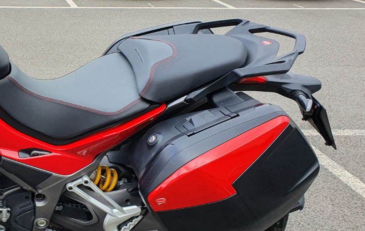

  10. The top box wil fit. There is a spare lock included included with the 1260. The mounting hardware does not fit. That is significantly different from the earlier MTS. Switched from a 2010 to a 2020 1260 GT. so know from practical experience
  11. I have a genuine Ducati top box frame mounting plate for the 1260 multistrada. No longer have the bike so its just sat in garage. If your interested message me
  12. Nice one. Just doing some haggling with the bike dealer, hopefully I will know very soon if the bike is mine. They do have the top box lock which is good news.
