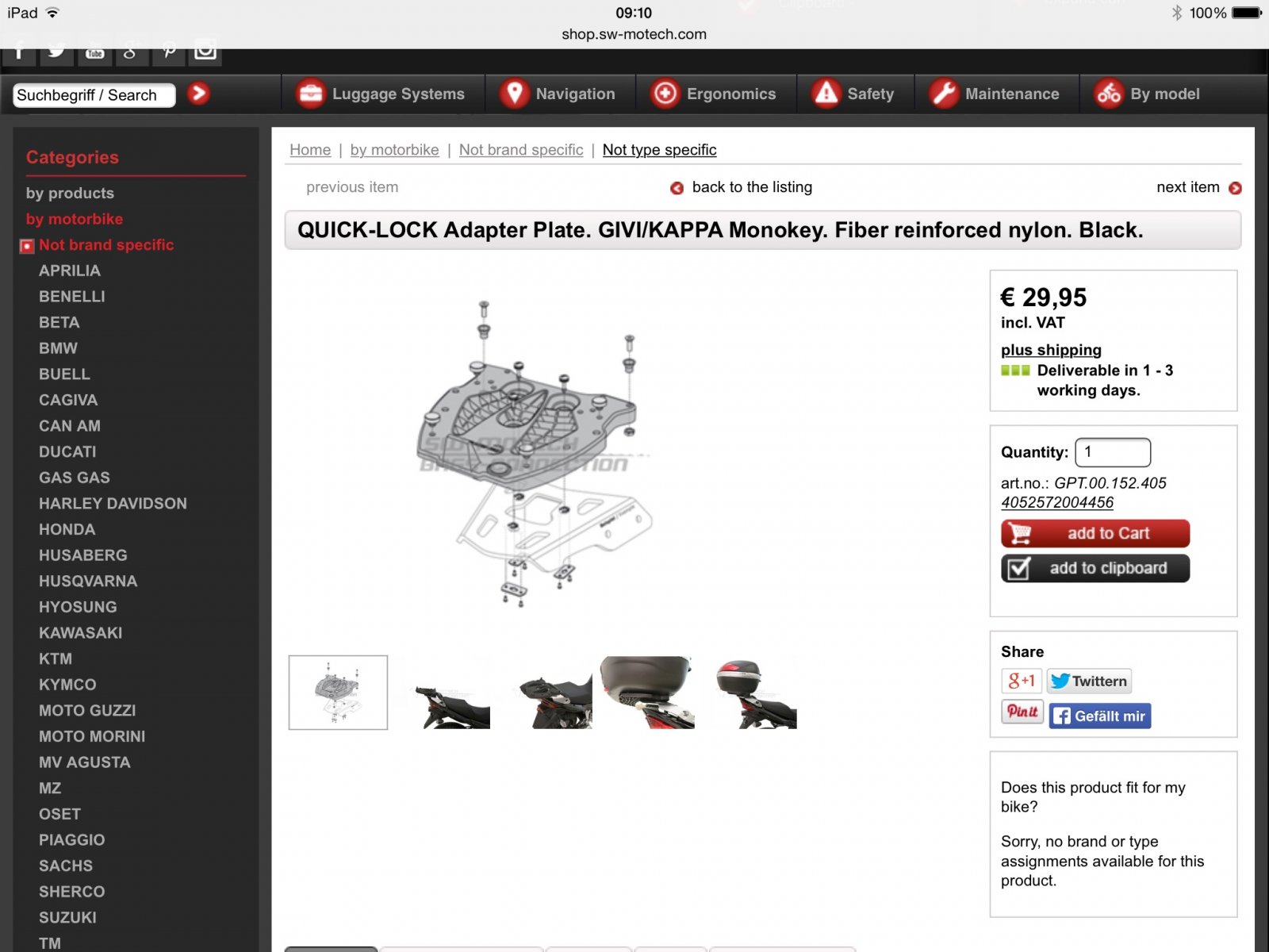

    On topic :p but scared now :Bag:

  3. No just the standard plate John, hence my Q. The link includes a plate I just don't know if I need another plate too
  4. SW-Motech do an adaptor plate to take the Monokey mount, but it doesn't have the support arms. My SW plate has a veeeery slight bend in it after 4-5k miles, due to wind pressure and lack of support arms, but it is fixed safe as houses, so all good. I now use a pair of spring lock straps through the loops on the box, for added stability, just in case?

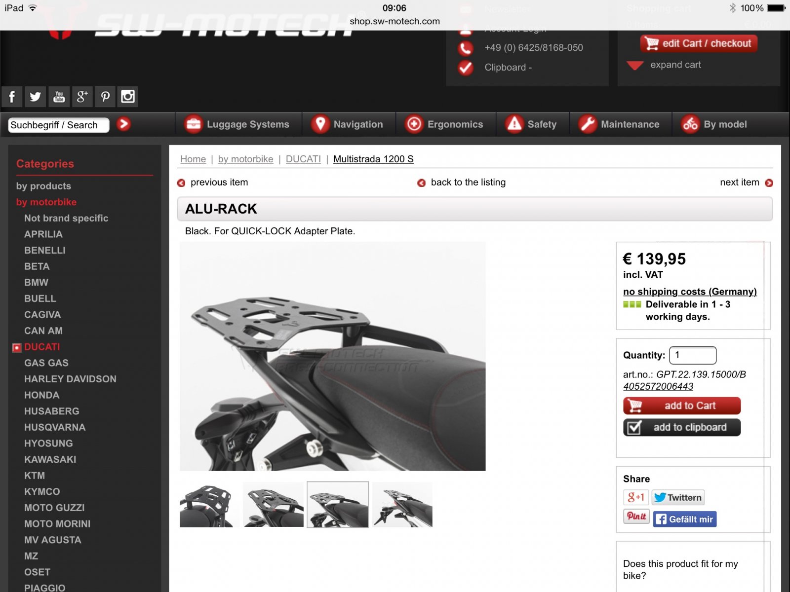

  16. Mine is attached by these two plates.
    I have the aluminium one, which has bent a tiny amount. This bolts onto the existing Ducati grab rail mounting points. The resin adapter plate fixes to the metal one via 3, quarter turn pins (I carry a 10p piece around to undo them). The box then just snaps into place, simples. I have a piece of high density foam under my box as the connection wasn't as rock solid tight as I liked.
