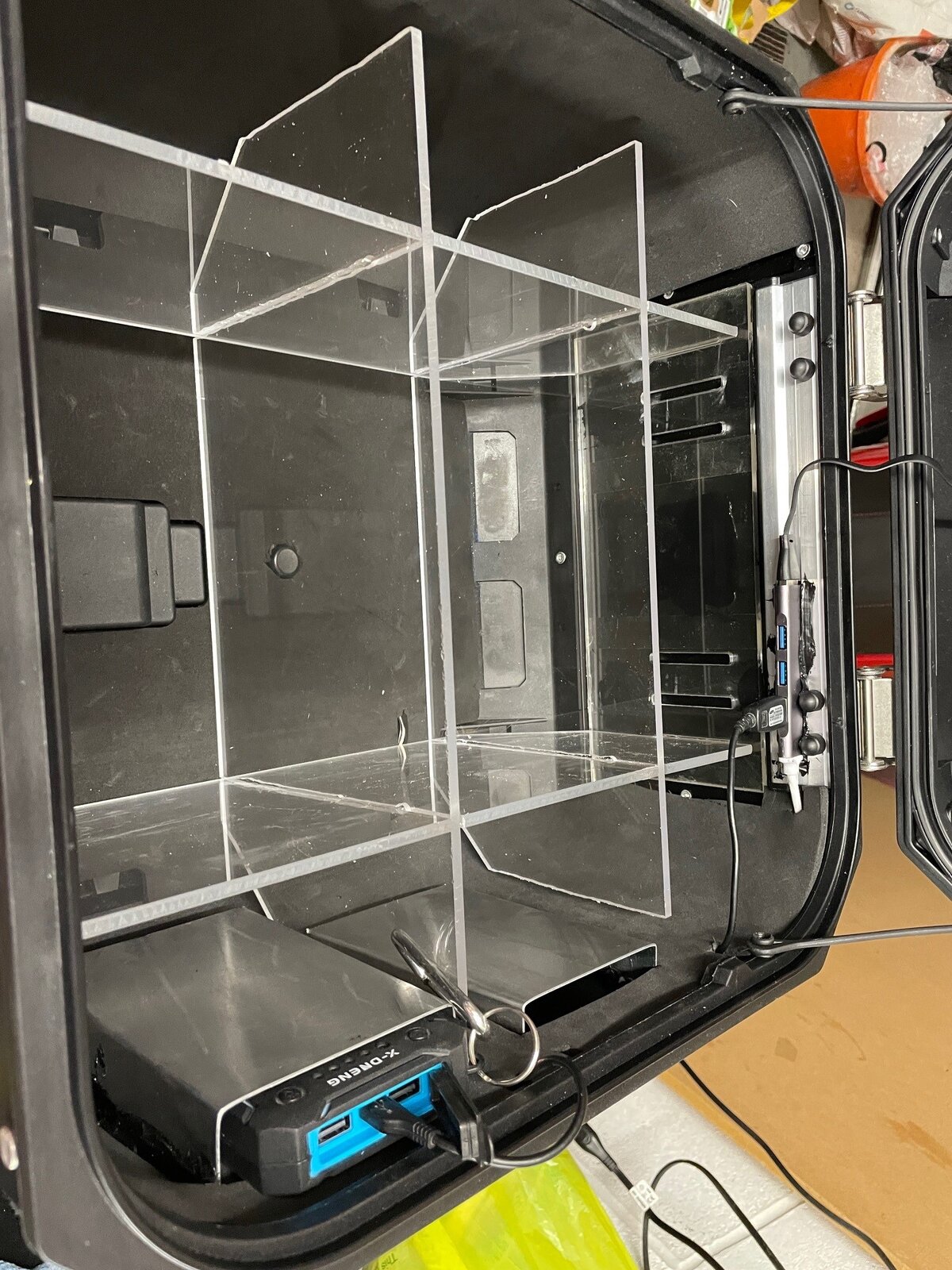

  1. Hi All. Just thought I'd post about my top box dividers and electrification. I have a 42l Givi Trekker top box and wanted to have it compartmentalised and electrified so I can charge my equipment whilst riding. I purchased a divider kit (plus two extra dividers) from ebay thetopboxdividers33. The fit is excellent and easy to install. The extra dividers I created channels in each so the could slot over each other. For the electrics I utilised a GIV E101 Brake Light Kit and connected it to the USB power outlet under the seat of my DVT Multi. I purchased a small USB hub and connected that in to provide power (be aware that the power from the USB plug under the seat is only 1A). I had to drill a hole in the rack and the bottom of the top box but if you use a step drill bit its straight forward if you are patient.
