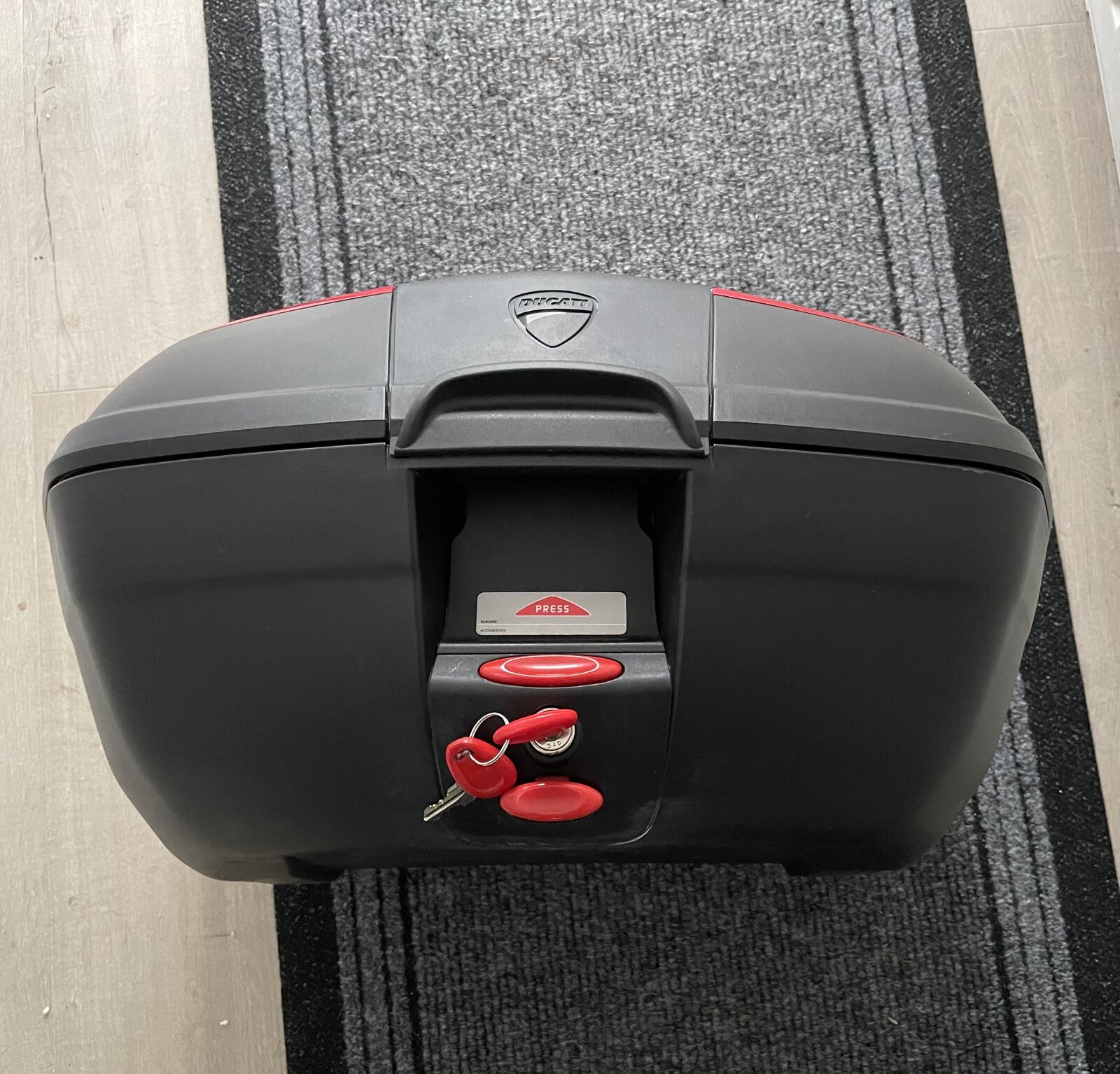

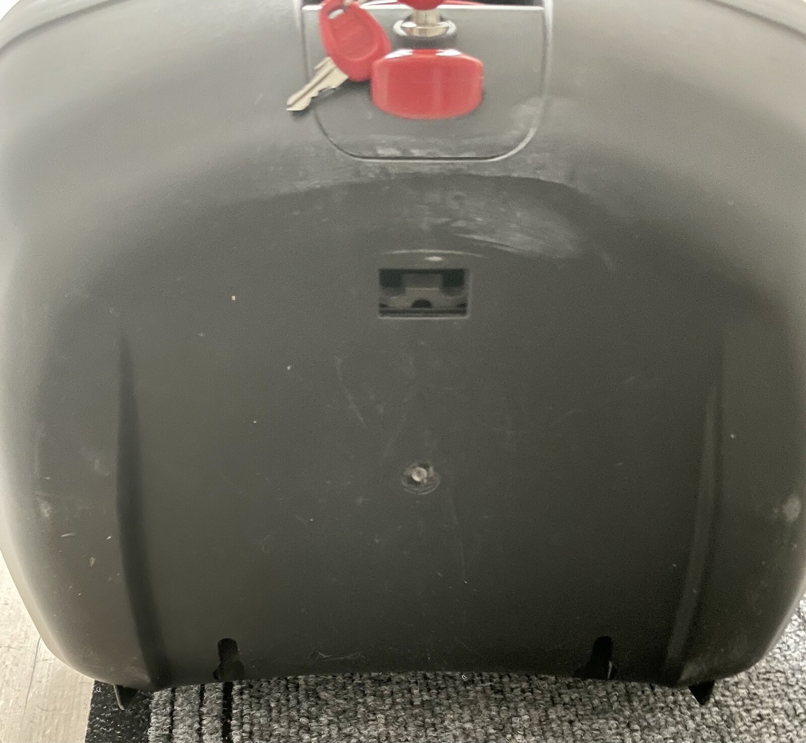

  1. Hi all i have a 2011 and just purchased a s/h oem top box but am at a loss as to where to find the correct fixing plate. Any help would be greatly received!
  2. Just in case you're not aware, you'll also need the 2 supports as well as the plate.

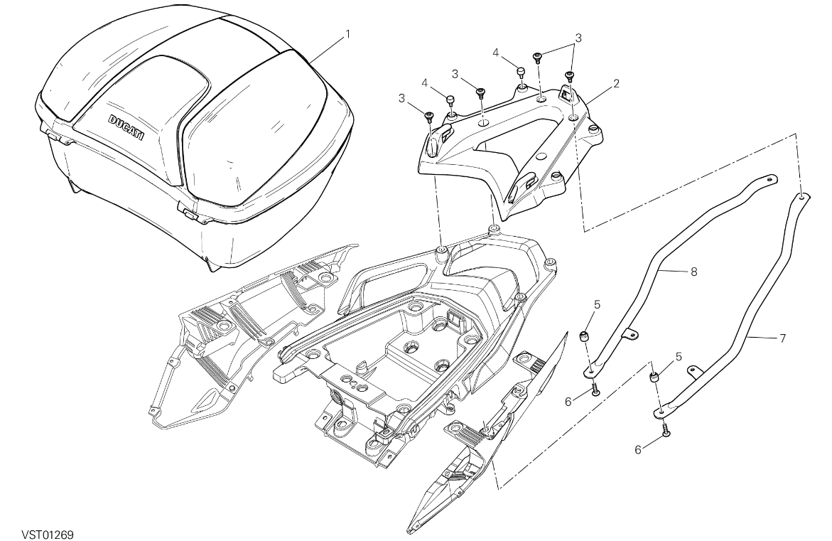

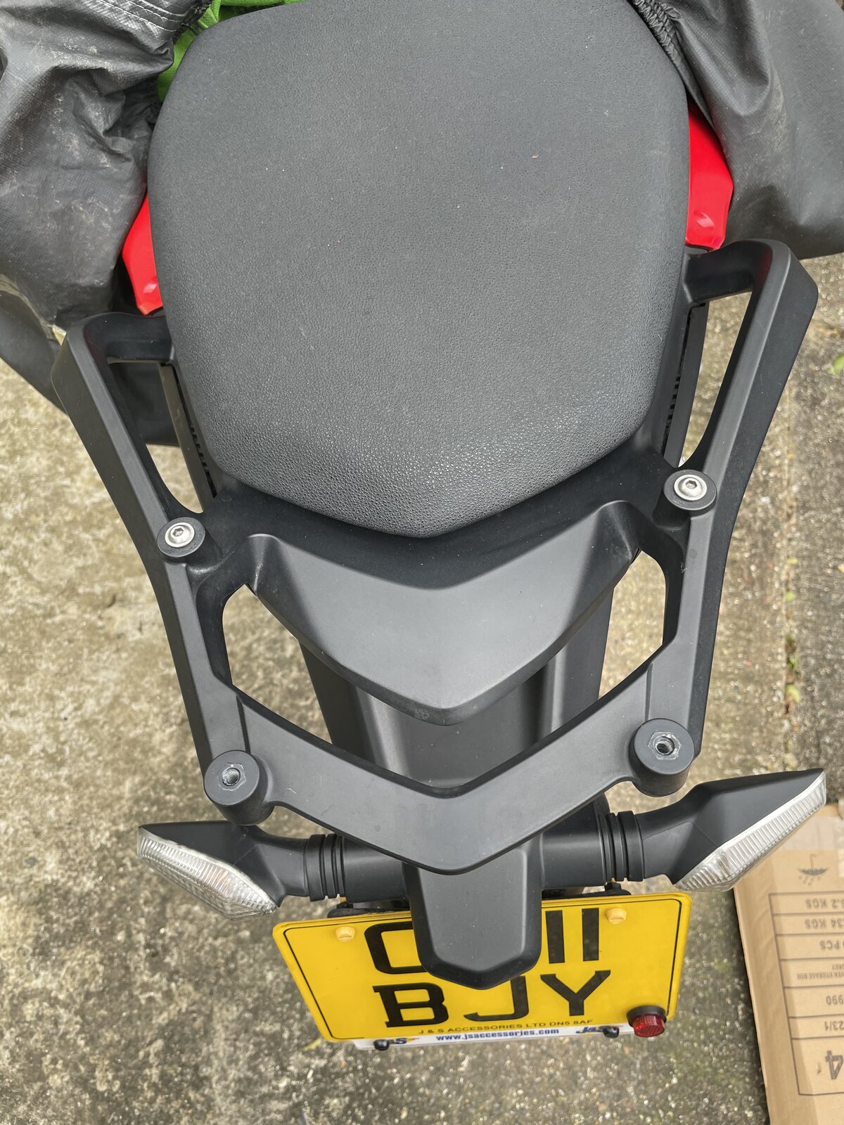

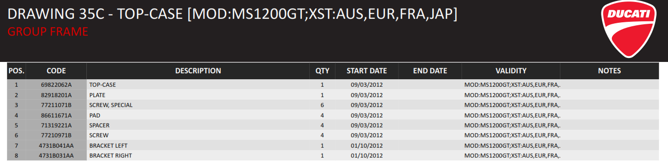

  5. The top case mounting plate, arms etc. were the same for the 2010-2014 models and only changed when the DVT model was introduced in 2015.
    The 2013 GT model cam standard with a top case so all the parts are listed in the parts catalogue for this bike:
    Let us know how you get on sourcing the parts.

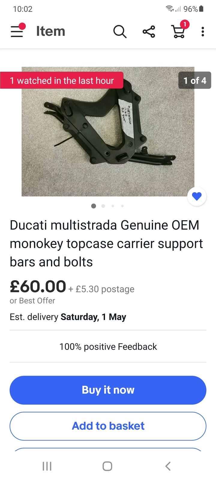

  6. There's one on eBay right now

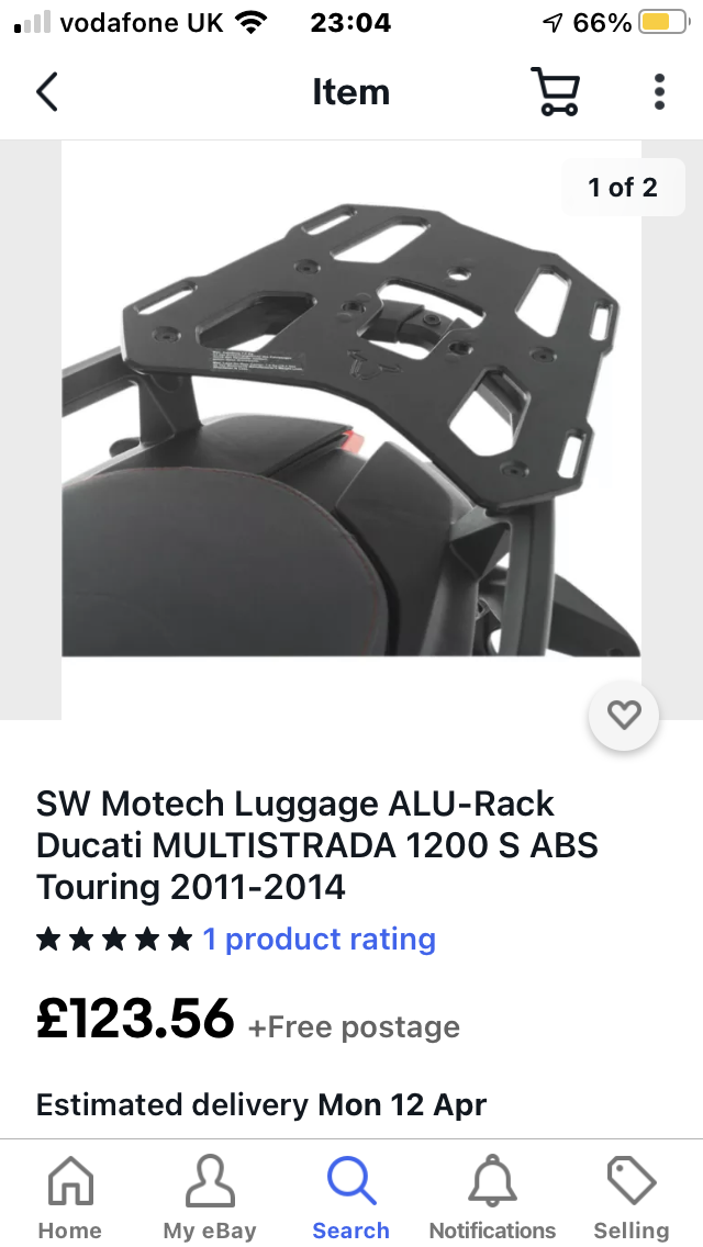

  7. Beware if there are no support rails with the above. My mate broke the grab rail on his Enduro by using a 3rd party plate that didn't have any.
