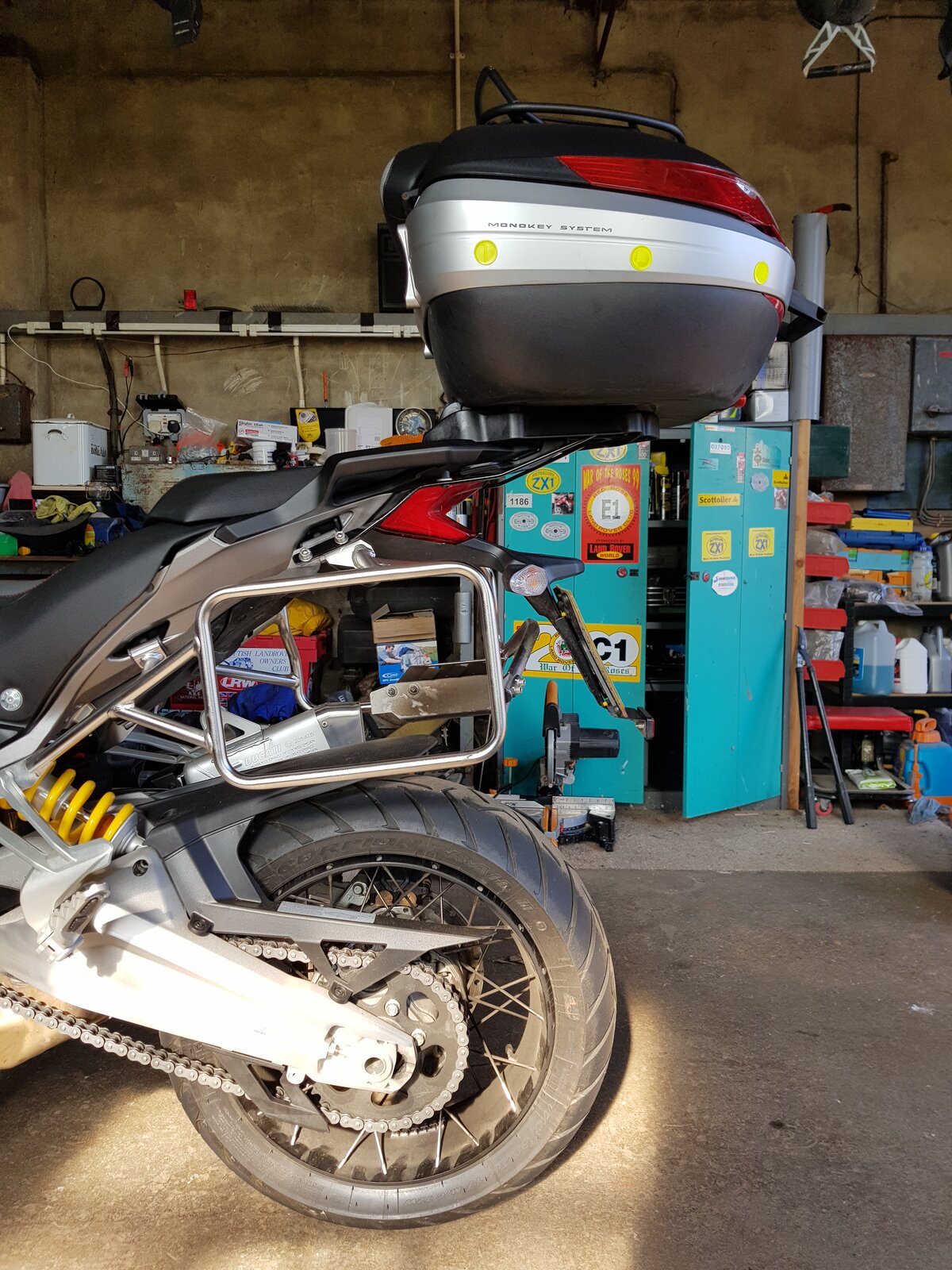

  13. As others have said I also just purchased the individual parts.
    The lower supports conflict with the touratech cross brace. I made a couple of supports from flat bar mounted from the Givi plate to the cross brace mounts. 3 years on no problems apart from reprinting the supports and cross brace.

  17. When I got my Multi with topbox already on it was slightly too far forward for serious pillion trips and also quite flimsy. I made a 6mm ali plate to mount on the back and bought the Ventura struts from under the tail section to stiffen the whole plot up. Has worked a treat.
