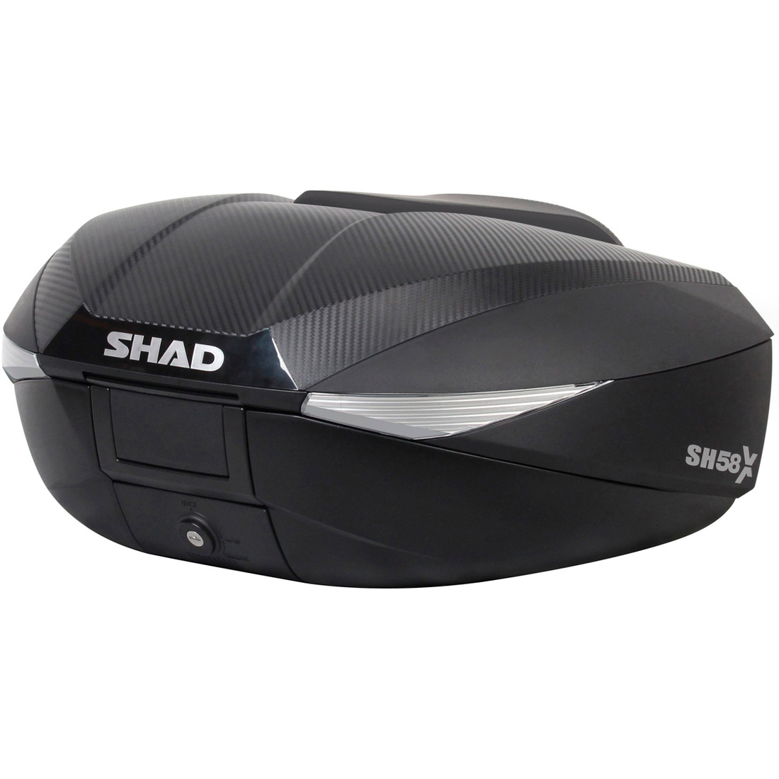

  6. I has a SHAD 58 ltr top box on my 1260, great piece of kit as its expandable and looks so much better than the Givi. If your interested i've still got the SHAD mounting kit for the 1260 available.
