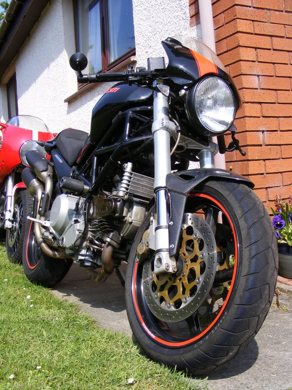

  1. Before I commit to getting oil pipes made up for my 944SS project, I need to make my mind up how best to route the lines. Connections are to the top of the cooler. I have seen one or both lines go under the horizontal pot. But think I like them both up the right hand side. Got any pics of your setup? Anything you would do differently next time? Cheers
  2. Do you mean like the hypermotard set up?

    So did you just buy a set of Hyper oil lines and stick them on?
  4. I just needed one hyper line, bought from Ducati Glasgow. It looked standard, bolted straight on and routed alongside the remaining line like it was designed that way.
    I've also done this on my SportClassic.
    The one OE Ducati line was a similar price to getting two aftermarket lines made, but I like this set up better as it looks original, plus I despise the chavvy red/blue fittings on aftermarket plumbing.

  6. Good to meet you yesterday Dave. I think my mind is made up. Just need to see to what extent Harry can 'sharpen his pencil'
    Very nice SportClassic, it was drawing a lot of attention :upyeah:

  10. They look great (wish my bike was that clean).:upyeah:

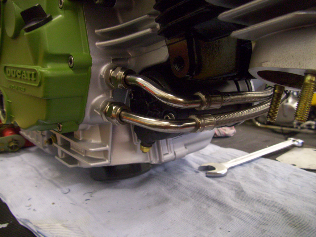

    One of the next little things I may also do is to 'hide in plain sight' the crankcase breather tubes by wrapping that in stainless braid to match the oil lines.
