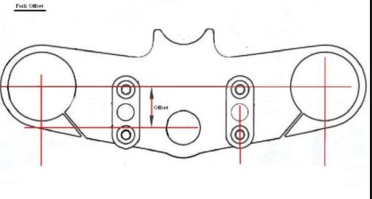

  1. Can any of you lovely people on here confirm the dimensions of a 'new' Supersport top yoke?
    Offset?
    Fork Diameter?
    Distance between Fork centres?
    Ones with the bolt down clip-ons.
    Thanks

  4. Thanks Doggy, that answers the Fork centres question close enough.
    The offset would be nice.
  5. No idea what that is or how to measure it!.

    This is Offset by the way:
  8. As near as I can measure with the bars on, the distance between the fork leg centres is 205mm and the offset is 35mm. Be aware that the standard model and S model have different fork leg diameters, 43mm for the base model and 48mm for the S.
  9. Derek
    Many thanks indeed for looking, it's appreciated.
    It's the diameter of the fork outers I was after, the bit the yokes clamp to, which again I realise will be different depending on the stanchion diameter.
