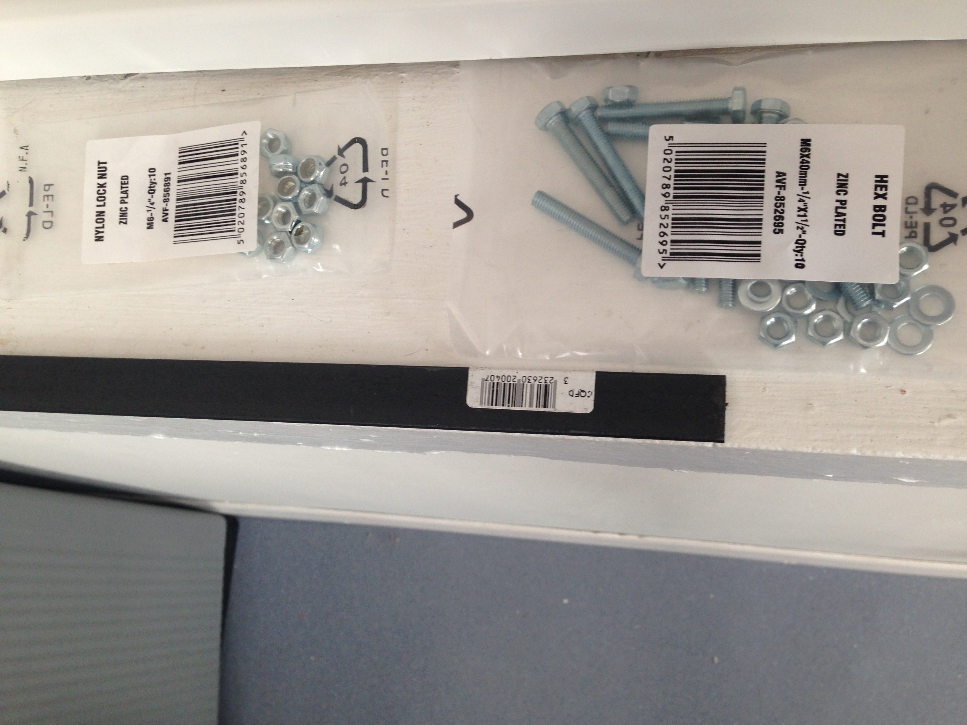

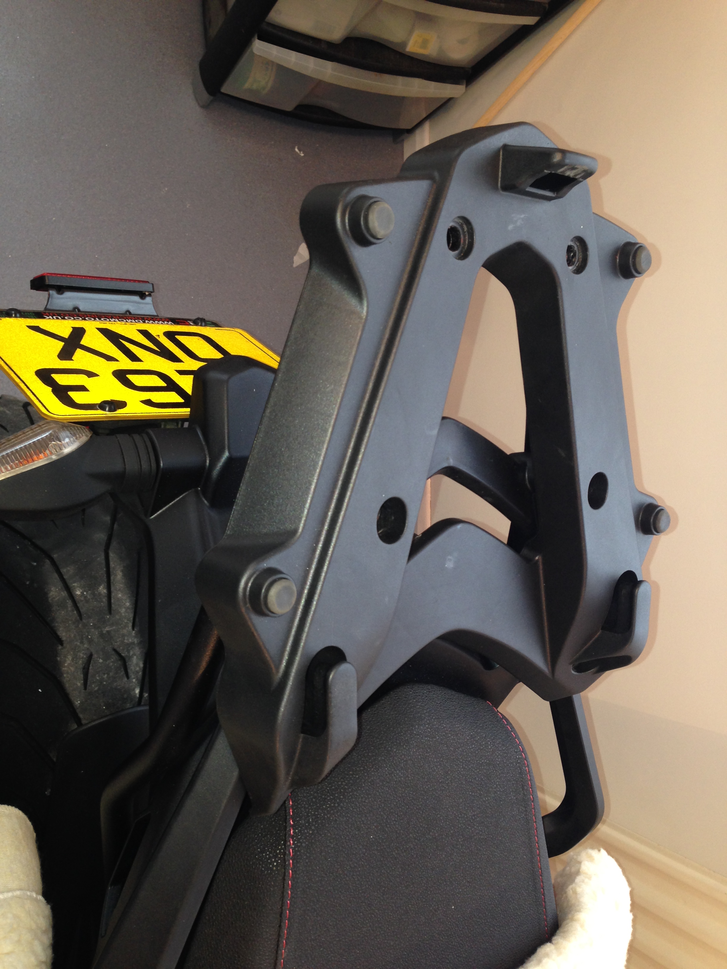

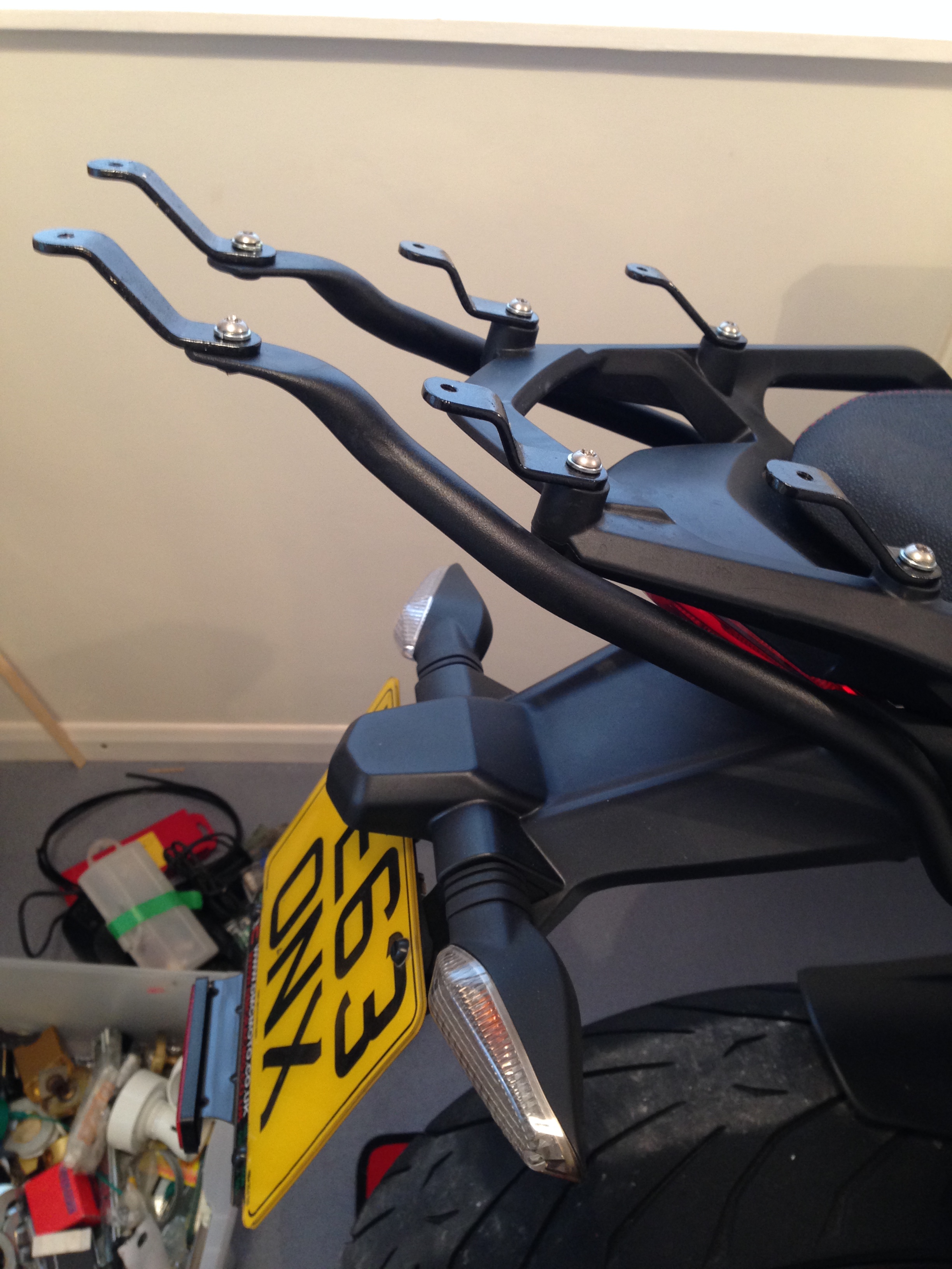

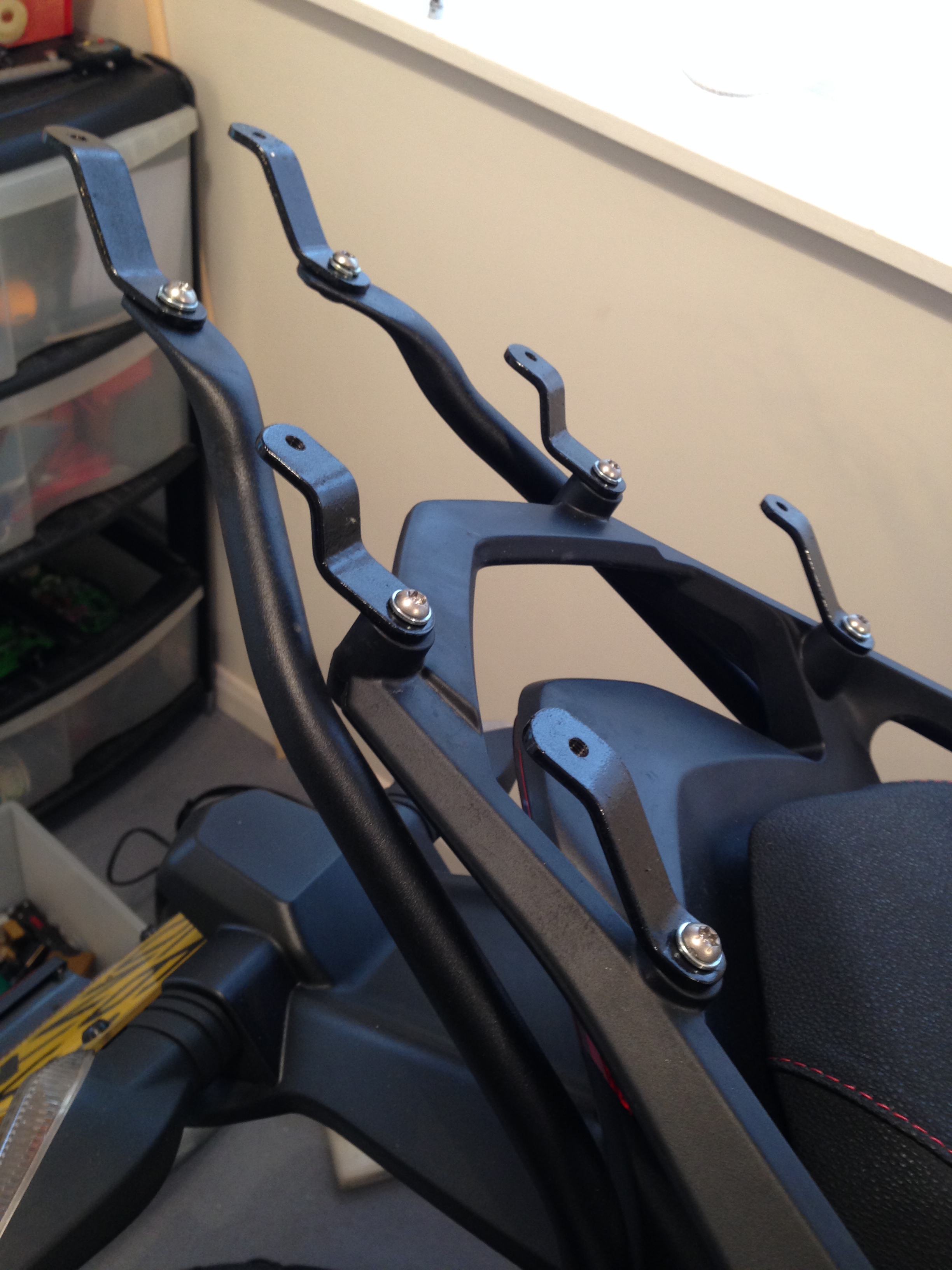

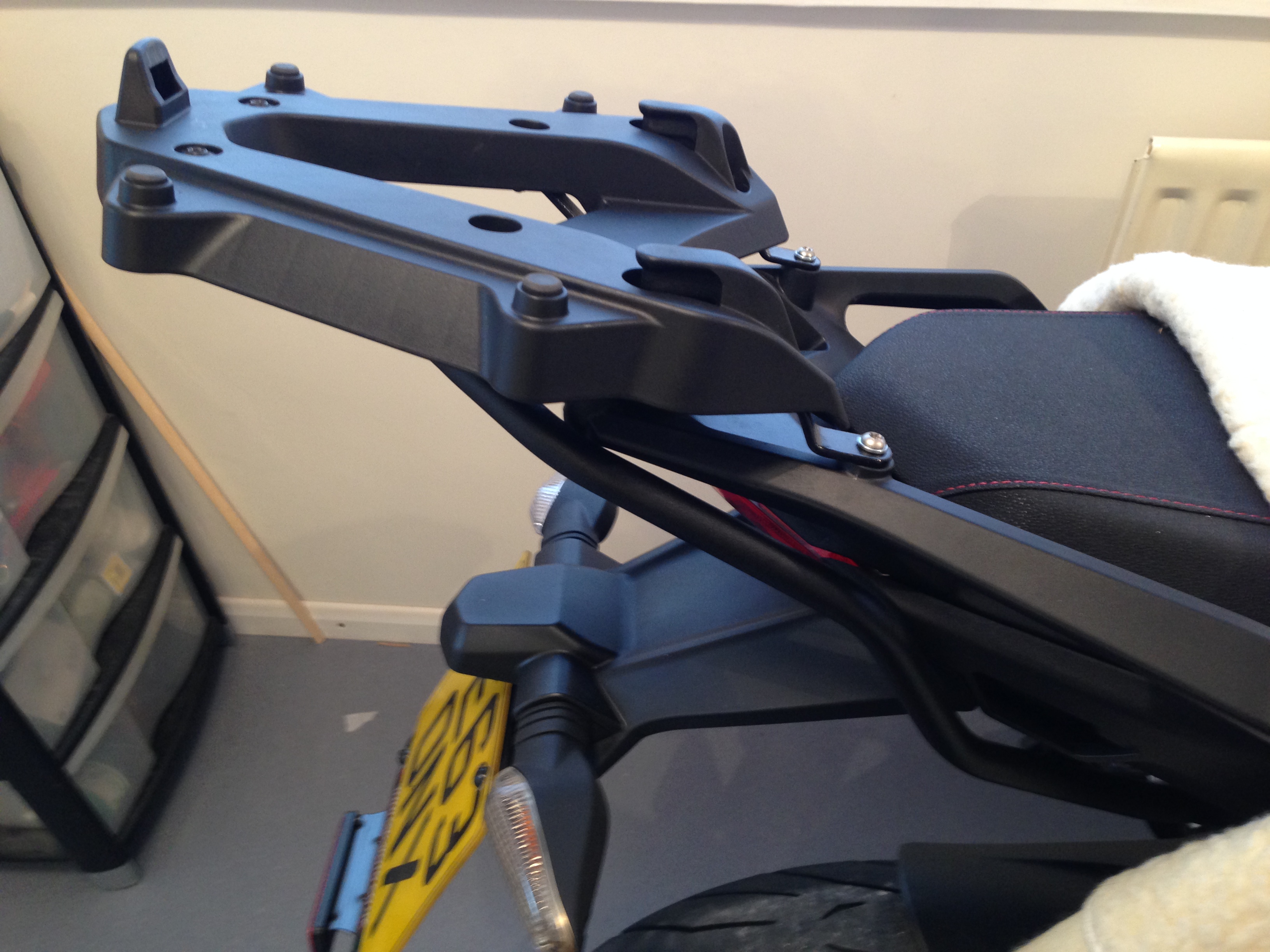

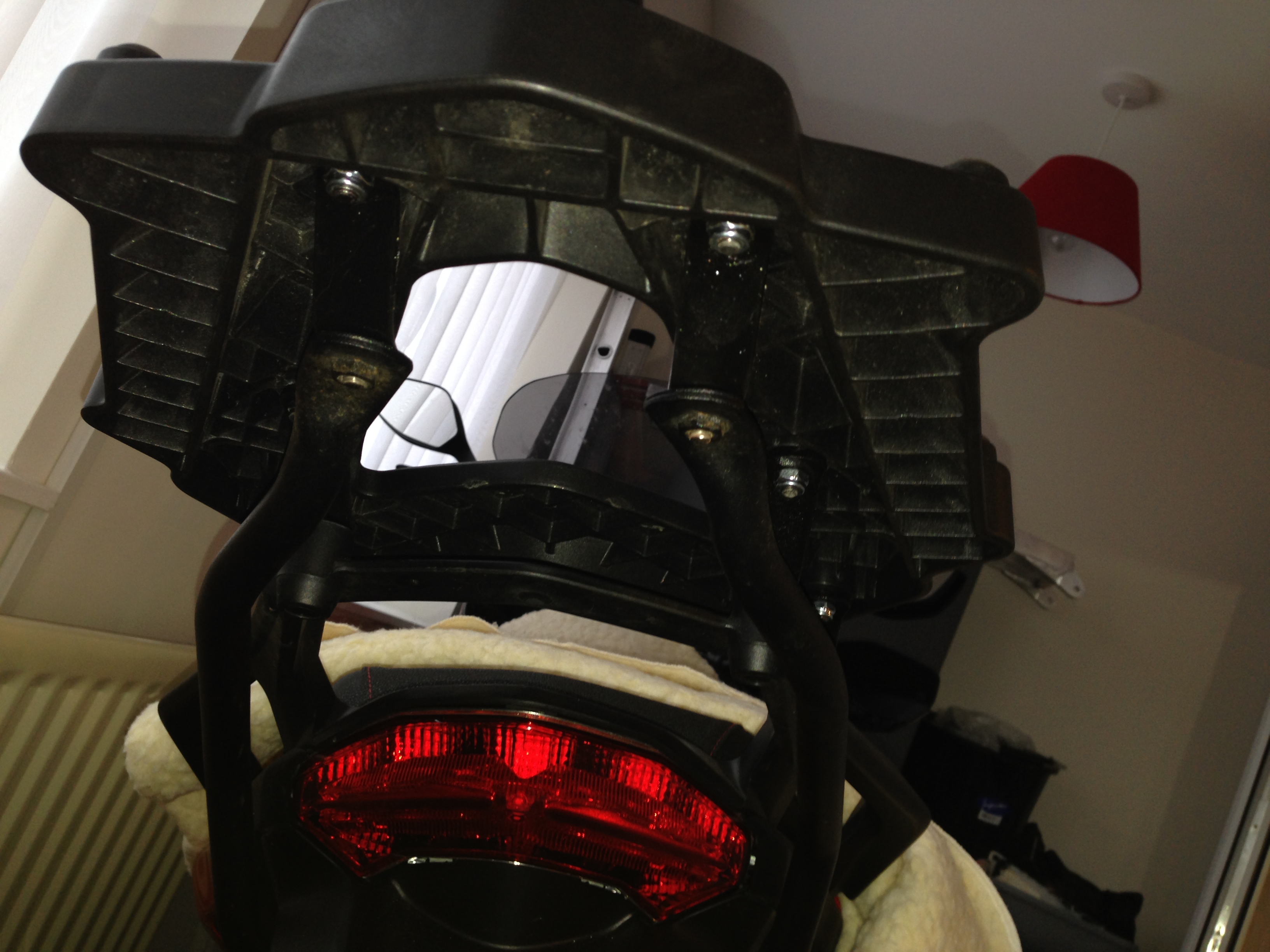

  11. Today I decided to look into moving the top box rack back. So I nipped to B&Q and bought some 20 x 4 flat bar and a few bolts, although I didn't use the bolts in the end I found a stash of torques drive stainless steel bolts nuts and spring washers.
    It turns out the rack is held on with 6 shoulder hex head bolts which I used to screw into the top of each of the brackets. and the ss bolts to screw the brackets down to the bike, I may paint them black at a later date but I'm off to the NW200 in a few days so I'll use that as a test before I commit to painting them.
    I threaded (M6) the top hole of the bracket to receive the original screws. and drilled the bottom holes 6mm clear.
    I've moved the rack back 50mm 2 inch in old money, I recon this will give us the extra room on the bike.

  12. Hi jc, that looks bang on mate only wish I had your skill with metal.
  13. The ingenuity of some of the members on this forum knows no bounds. Great job:upyeah:. Andy
