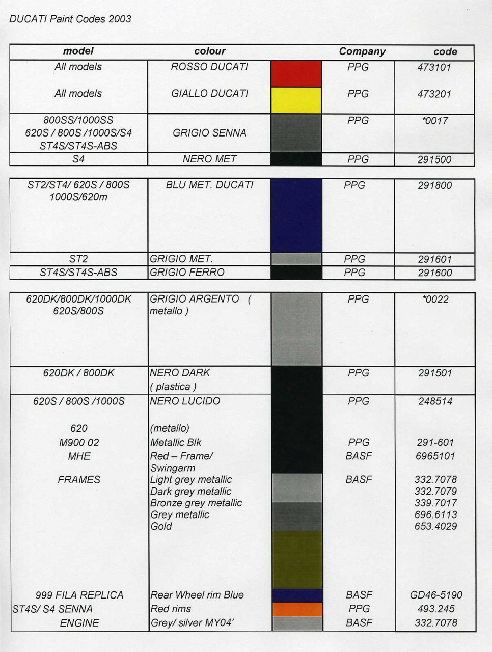

    Can't promise it's right, but this is what I have on codes for that year.
  3. That seems to match the 473.101 but I can't find a match for any of the DUC/xxx codes.
  4. No worries, if it's cheap enough order some but I found that paint code to match mine :upyeah:
