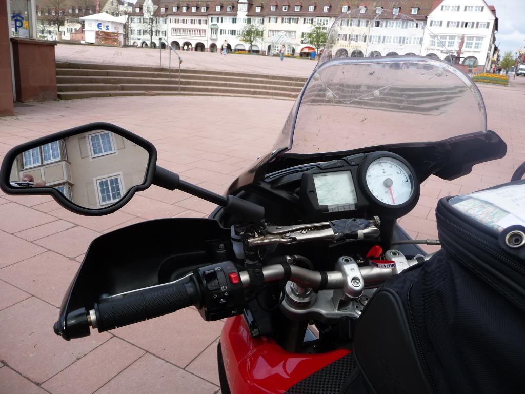

  16. No touring toolkit is complete without Mole Grips - the most versatile emergency tool - gear, brake or clutch lever, vice, clamp etc...
    Overtaking mirror sheared somewhere in Germany enroute to Czechoslovakia.
    Mole Grips out - sorted for the trip in less than 5 minutes
    P1000398.jpg .
