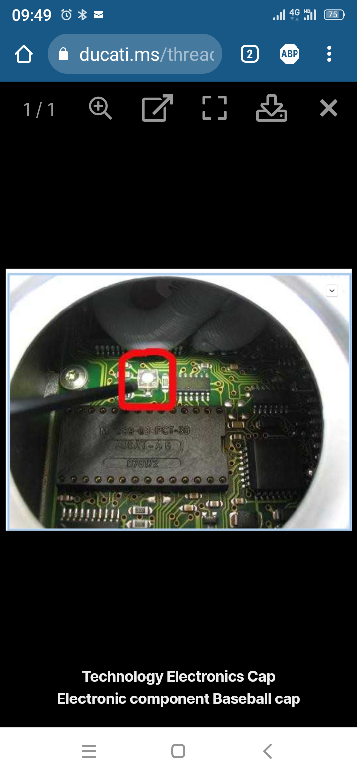

  2. When TPS is good and bodies are balanced, Co is adjusted via a small pot in the ECU. Screenshot_20230912-094900.png
  3. be as gentle as possible if you carry out above when it comes to full adjustment/lock in either direction, preferably with a plastic tipped screwdriver (small straight blade) - even a modified wooden lolly stick will do.
  4. Yes all good regarding co and adjustment, I purchased a small potentiometer screwdriver used for TVs.
