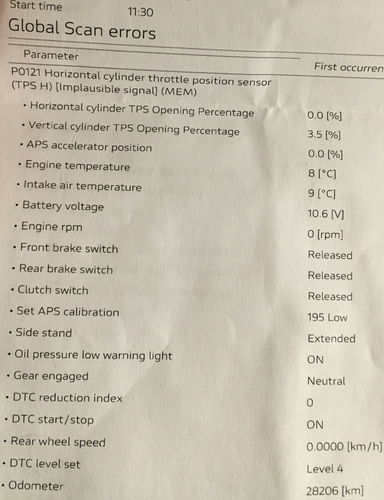

    I broke down on the road the other day with the red warning and bike would run still, but with no throttle.
    I was recovered to a Ducati dealership who cleared all the codes and I was away again. Couldn’t get it booked in at the time as they were super busy and I was on the way to a funeral. But I digress.
    Anyway, it ran fine again until a few days later where the same code returned.

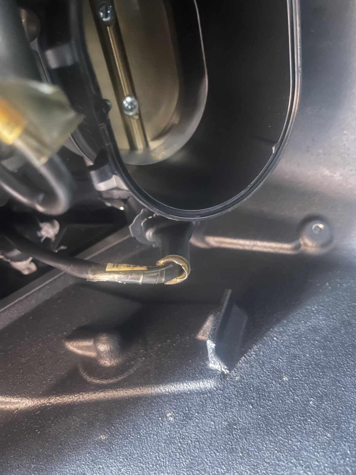

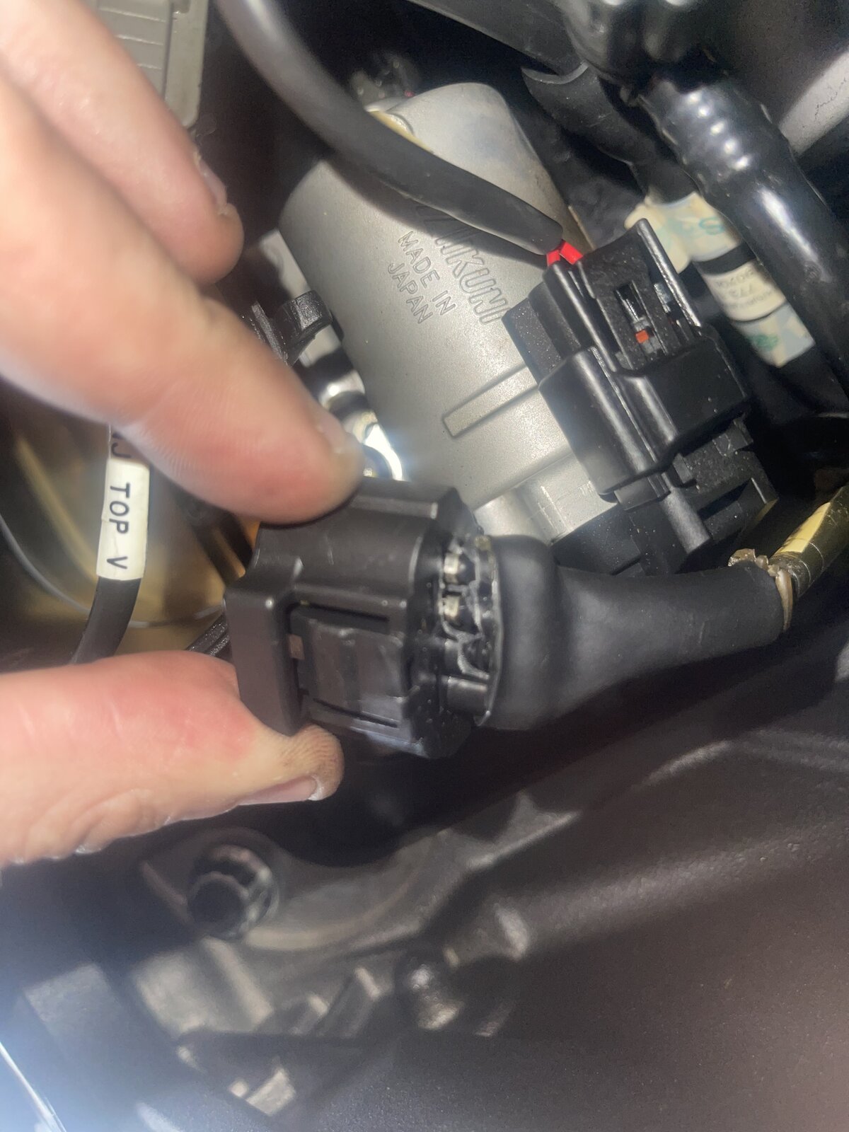

    Has anyone had this issue before? I’ve changed both MAP sensors and I’ve just taken the tank off and had a look inside, everything seems ok, however the horizontal cylinder TPS connector looked a little strained, but I don’t see any breaks in the wiring. Do you think this could be it?

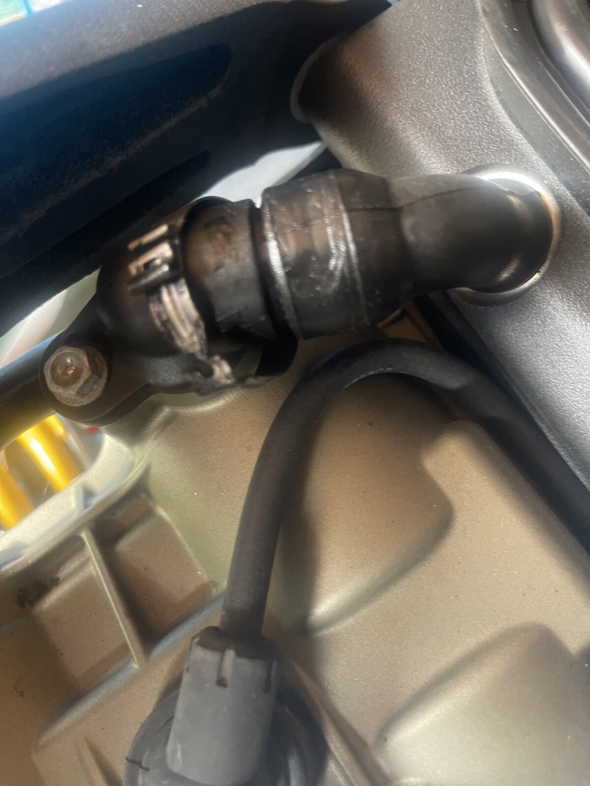

    It was also leaking oil, but I think I may have Found this as the vertical cylinder had a clip undone on the breather
