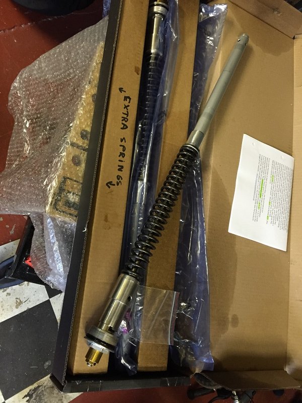

    Sort forks - stock internals were OK but could be SO much better

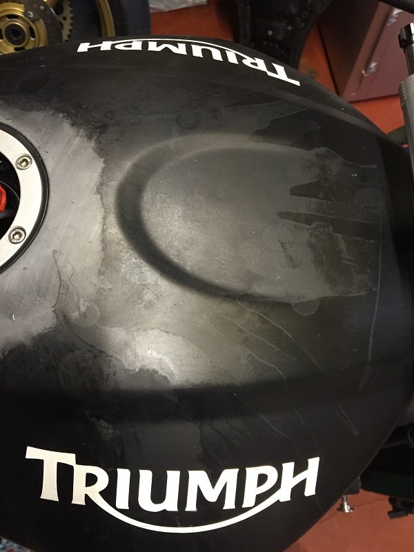

    Sort tank - This was a strange matte finish and scoured with petrol marks - track bike chic but not pretty

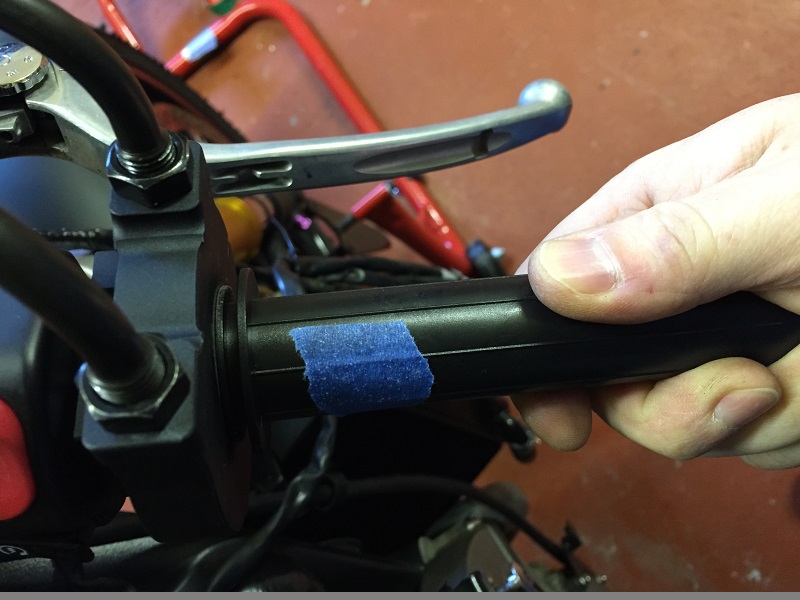

    Quick action throttle - the stock has far too large a travel so its hard to get fully on the gas from closed.

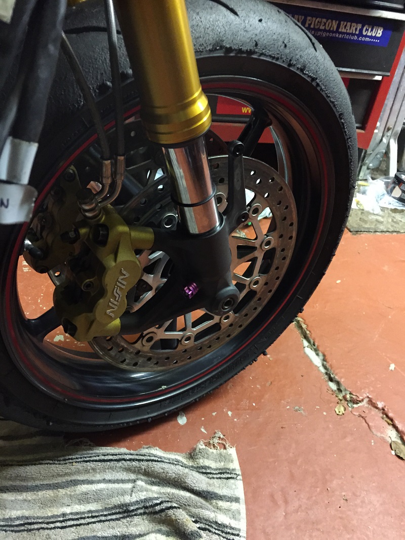

  2. The forks. Having priced up all sorts of options (Replace with 2011 forks, replace with Ohlins, replace internals with KTech etc) I came across a forum member who was selling his Maxton internals. These were about £450 new and were spung for my weight. I Have Maxton stuff on my Speed Triple so know how good it is so I snapped them up for £180. Maxton take the stock internals and replace some parts, modify others and generally take them from being stock OEM ones to top notch stuff. These should stop the front feeling so vague at speed and lean. Not much to show but you can see the purple bump adjuster at the bottom of the fork leg.

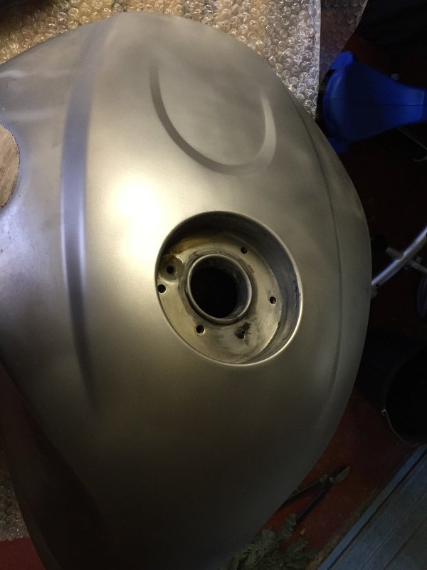

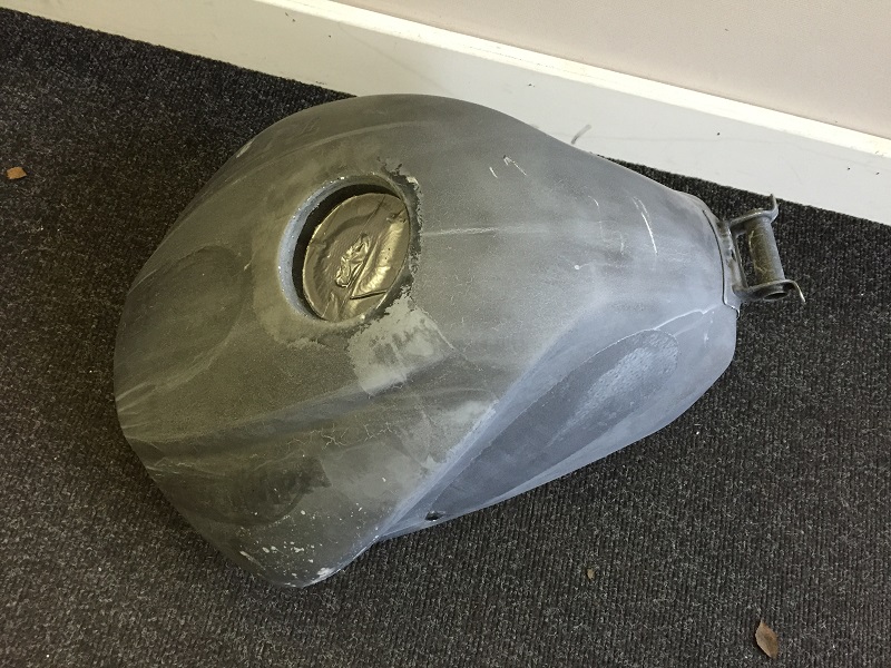

  3. The Tank

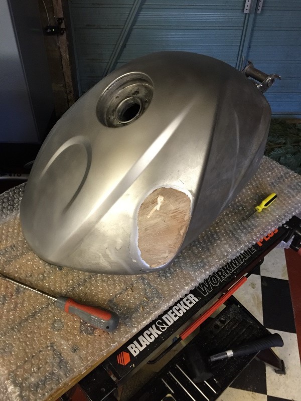

    Scoured and knarly (dude) but not what I was after. I decided to see if I could get a brushed metal finish on the bare tank so went to get it glass blasted.
    The used a nasty chemical to get the paint off before blasting it to get off the primer.
    I got a call a couple of days later to say they had done it but there was a big patch of filler on the top. Bugger.

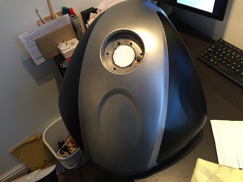

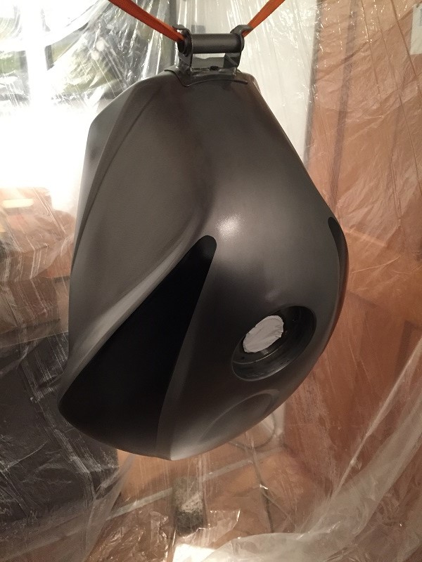

  4. Still onwards and upwards. I chipped out the old filler and redid it with a view to covering the area with wrap to cover the filler. I then used a green Scottish pad to give a brushed effect, did the wrapped areas and coated it with 4 coats of petrol resistant lacquer in my murder room (plastic sheets in the corner of the garage to reduce dust).

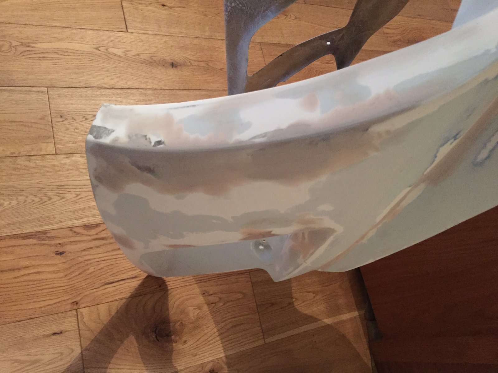

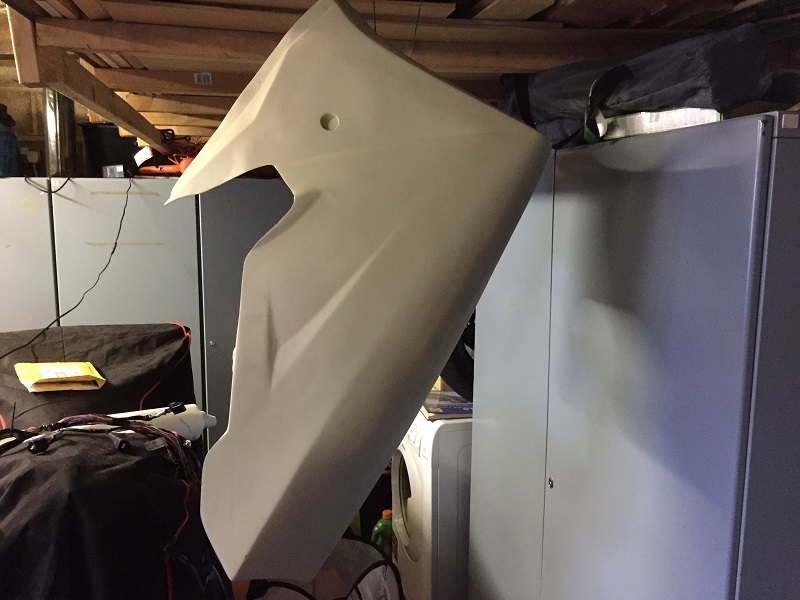

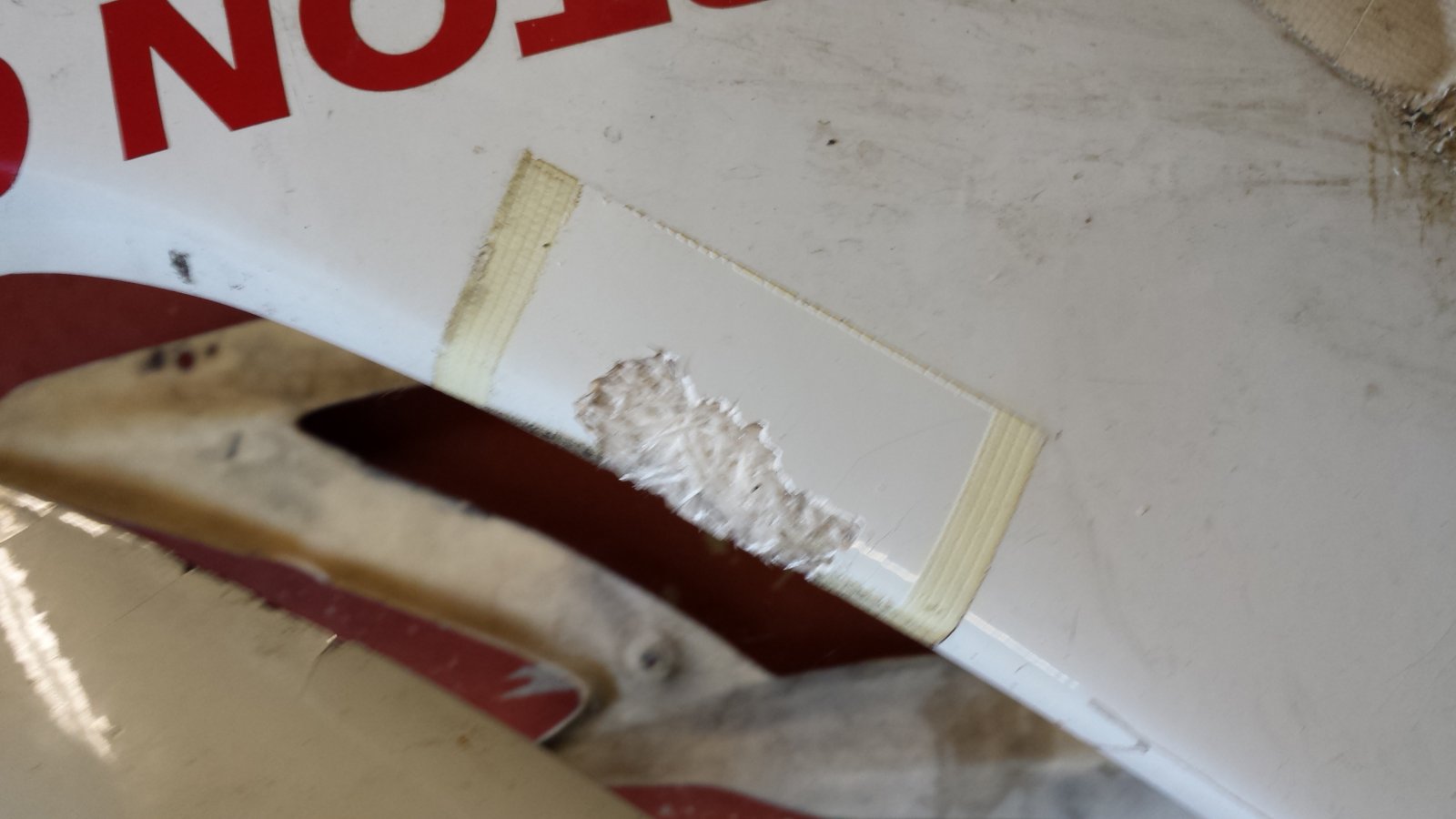

  5. Fairings

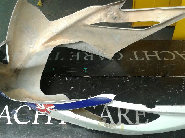

    OK from 20 paces but got lots worse the closer you got. I'm not looking for perfect but if it needs repairing lets do it all anyway.

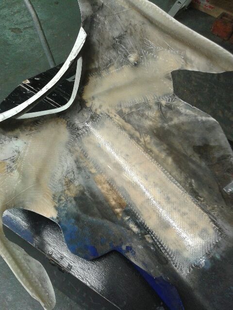

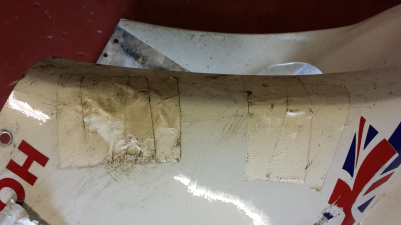

    First up, get them a bit stronger. They flexed a lot....I mean loads, so the gel coat on the fiberglass was crazed like mad. I know a guy who knows a guy who was able to reinforce them. He also filled all the holes whilst he was there so I could start again with the Dzus

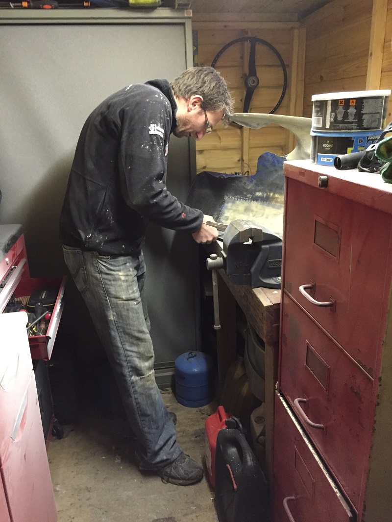

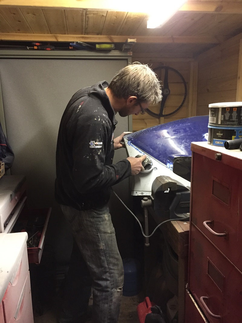

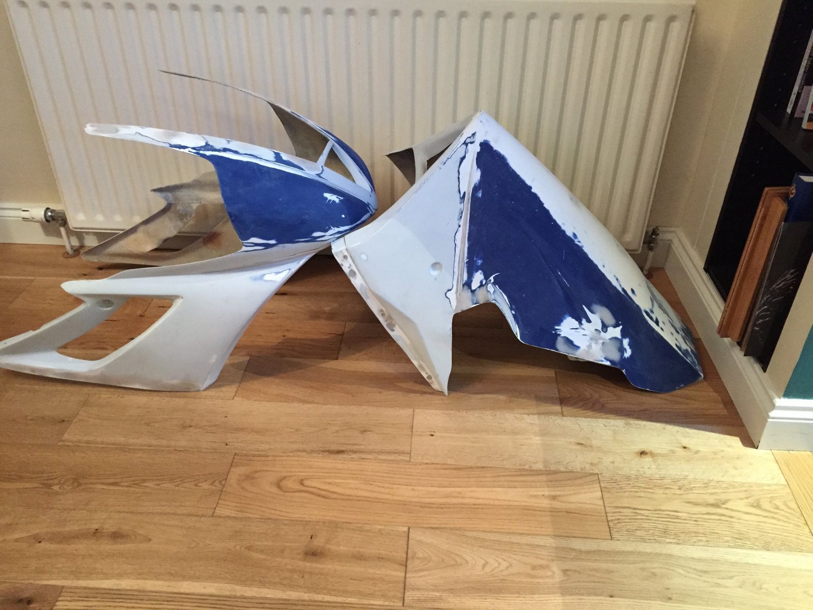

  7. Next up was getting off the stickers and sanding them down as well as patching up the holes.
    (Thats not me by the way.......Im shorter, fatter and have less hair oh and we wore masks too...most of the time)
    After much filling and sanding they were then sprayed with high build primer
    Before spraying and sanding again to find any low spots. Filling and sanding again then primer and spray.
    To keep it simple (and cheap) I did them black with rattle cans. In retrospect, with the time it took, I'd probably pay for the painting next time.

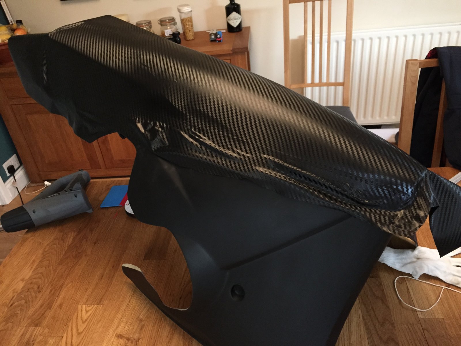

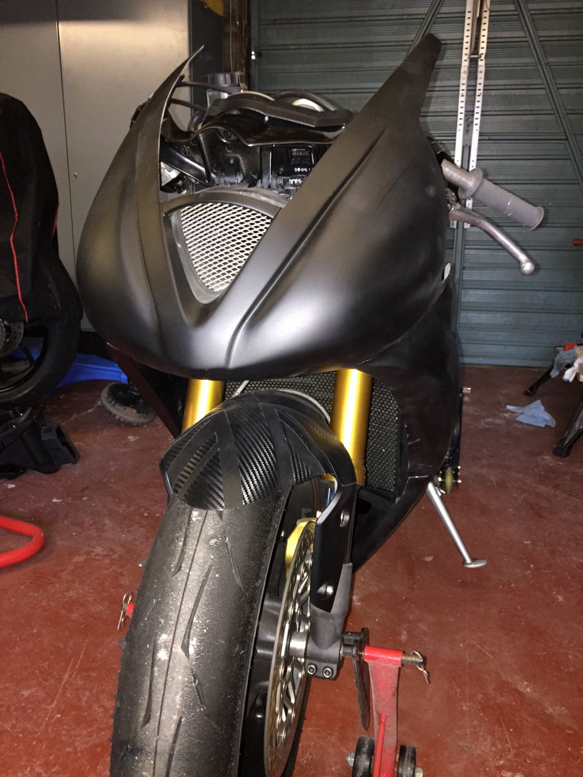

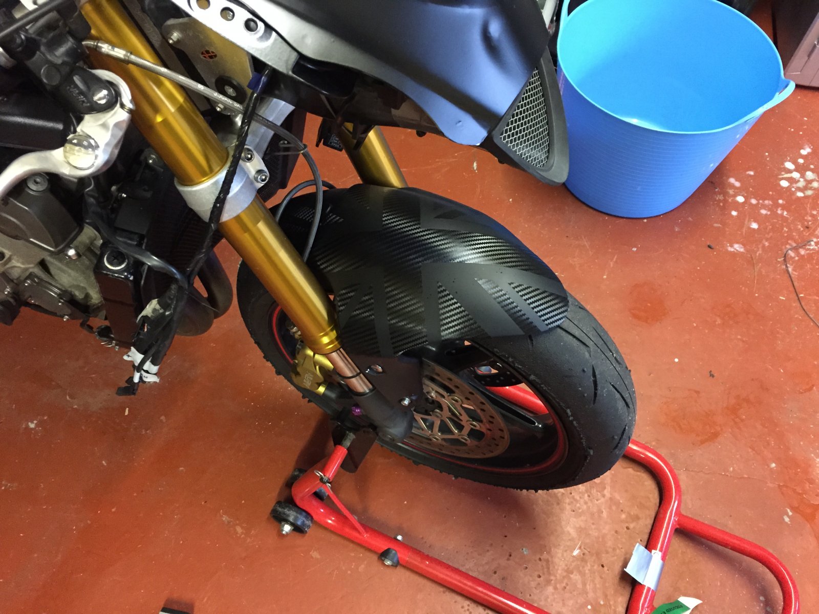

  9. On with the fairings.

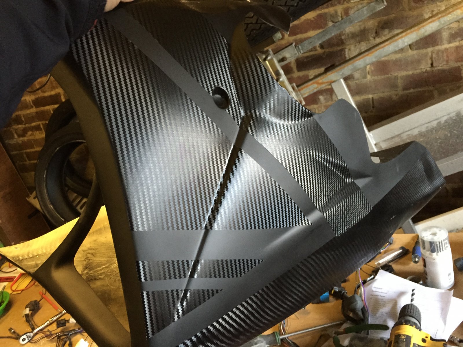

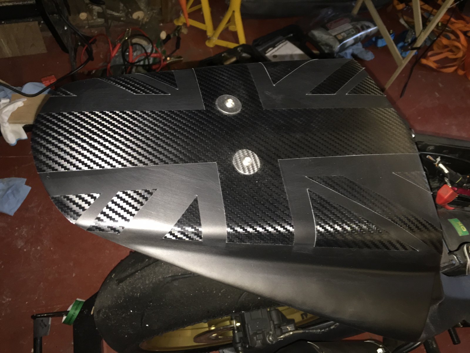

    I got some carbon wrap to break up the sea of matte black. I started with the front mudguard with the intention of carrying through the union jack theme.
    Turned out nicely so on with the belly pan

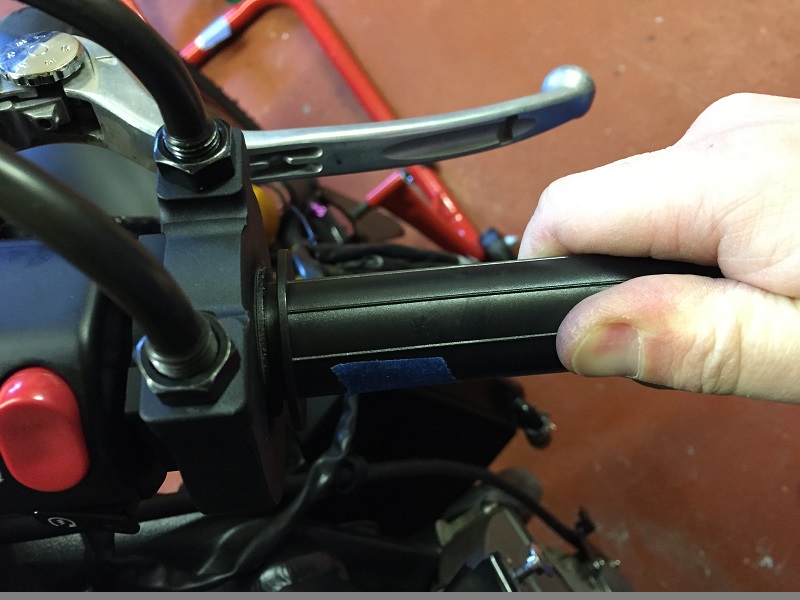

  11. Quick action throttle
    The tube from a Speed Triple is an improvement and is a very cheap mod for the Daytona. Its about £10 from Triumph and lots of owners do it and are happy but I was still struggling to get from about 85% to 100% throttle without taking a second grab at the throttle.
    I got one from Venhill with 3 different cam sizes to try. It was a pain to fit! Getting the cables into the cam by the throttle bodies took about an hour, 4 pints of swearing and some long nose pliers but the result is great. It now goes 0 to 100% in about 35 degrees whereas the 1050 tube was about 45. Doesnt sound like much but it feels completely different. The new cables also have a silky smooth action, rather like double cream. Maybe slightly heavier but miles more positive.

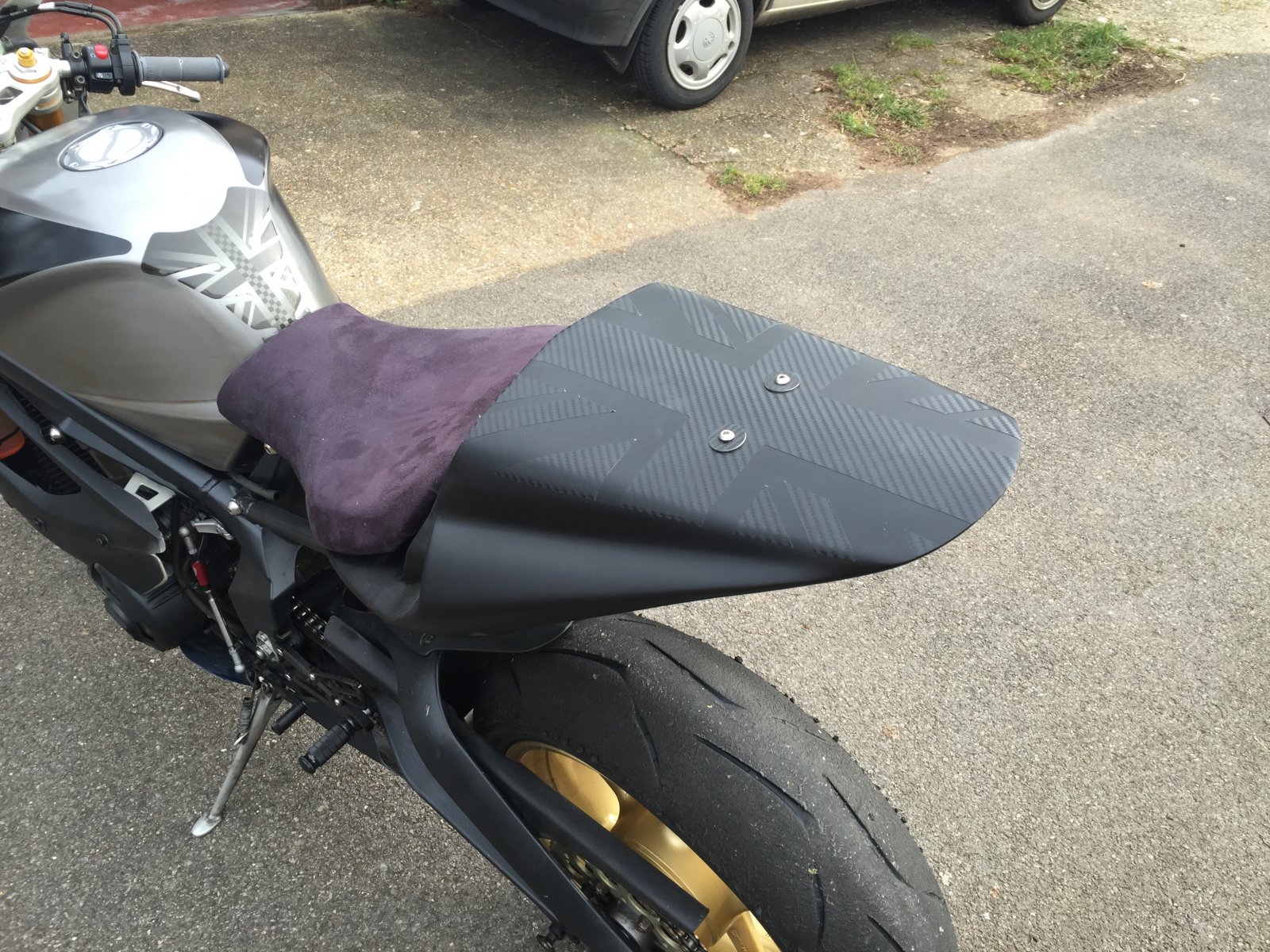

  12. I still need to put the screen on and refit the airbox and tank properly (few bits of wire tidying to do under there still. I'll also be getting some stickers on there including 'Triumph' on the tank and a few others to break up the sea of black! I'm also thinking about getting a black rear wheel or maybe getting the gold one powder coated.
    She now looks like this :
