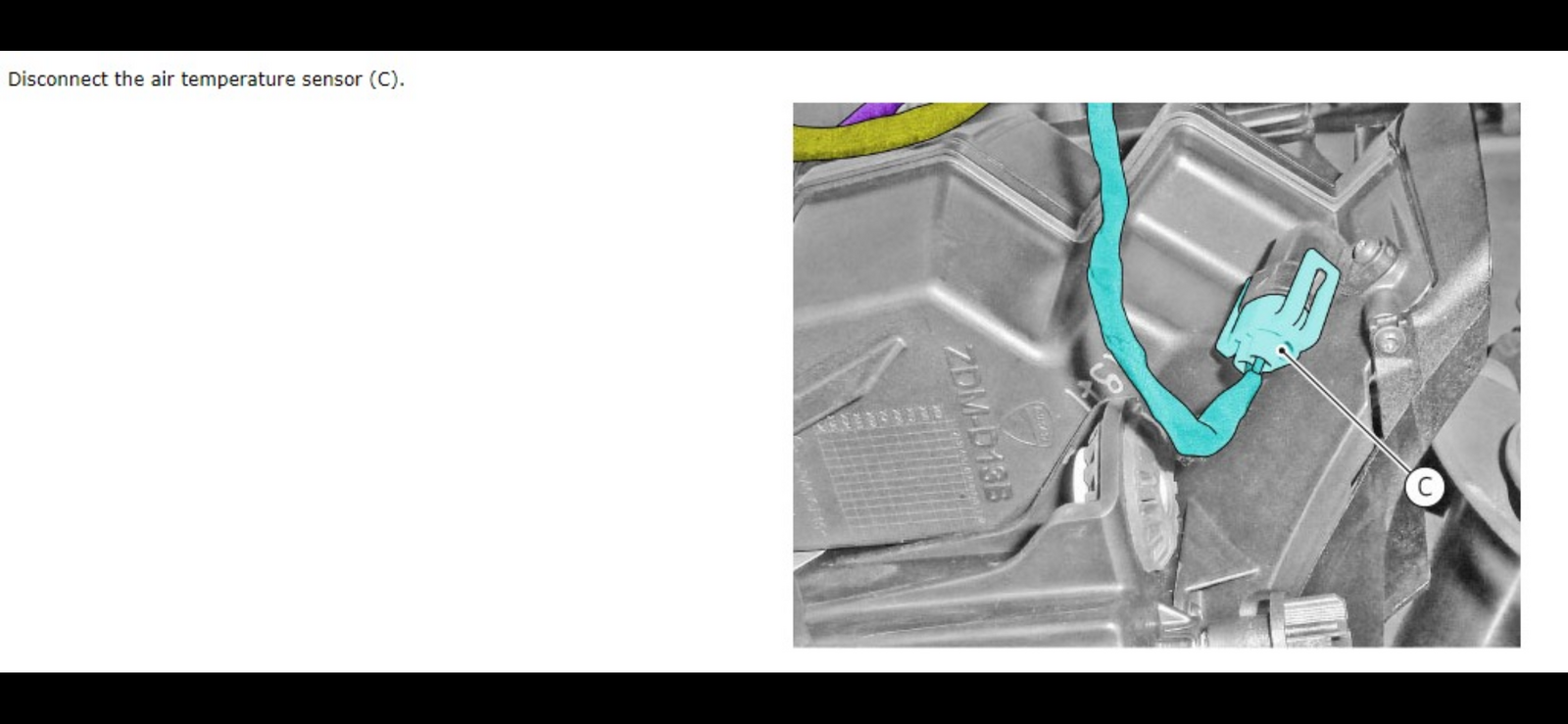

Hi - in the middle of installing CRC track fairings onto my Panigale V2 and when removing the headlight I noticed a small sensor that plugs into the loom under dash and is fixed to the air intake/headlight unit. Anyone confirm what this sensor is and can it be removed or do I need to fix it to the new Crc air intake? My intial guess was that it would be the air temp sensor but can’t find it in the service manual.
I think from memory it’s the “Piattaforma Inerziale” which I am pretty sure is a tip sensor (I don’t speak Italian). On the Ducati Performance fairings this part is retained so I would do the same with CRC and fabricate a suitable mount to replicate its current orientation.
if its the small black sensor its the air sensor and needs to be plugged in. I usually drill a hole in the CRC duct / scoop for it to fit through and then i put to tiny holes either side so i can cable tie ito the duct / scoop using the screw holes on the sensor
Yeah that’s the one - looks like this. Assume just put it towards the back of the scoop so it’s near enough where it is attached to the scoop under the stock headlight.
