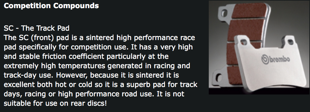

  8. As above, I've been using the SC and they Feel Good
