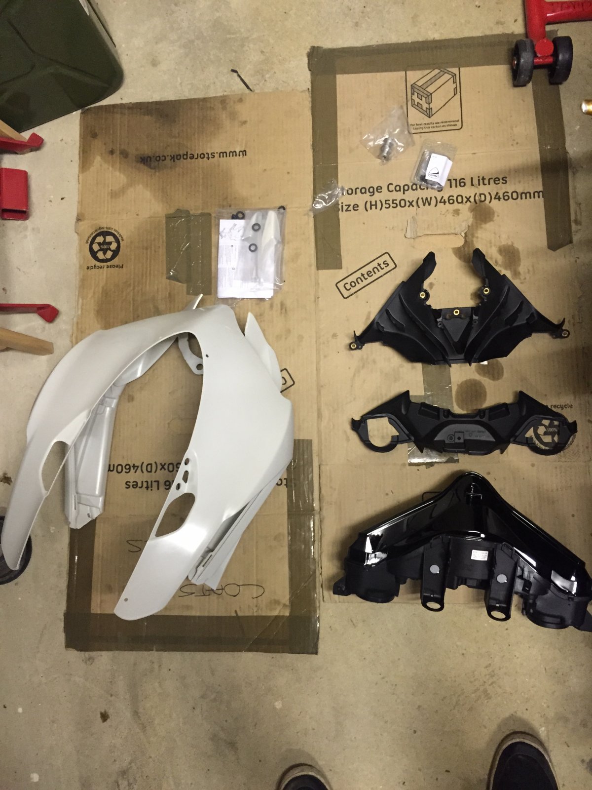

Talking to @J0n3s today, it includes the ecu blanking plugs for when you unplug that stuff, and his new R ones also have the bolts. Worth asking your dealer

I use the ducati fairings for this reason. £500 for the whole lot including mirror and electrical blanking parts so it's good value and just needs another 100-200 spent on getting them painted if you want it looking like normal. I did use them white for a while but they go a bit yellow in the sun. Aftermarket track fairings are quicker to remove on a trackbike but it takes ages to convert them back to a road bike.
Buy the ducati performance fairings and ask for a discount as well if you're buying it all together, as Royal says you should be able to get them for about £500. If you want them painted i would recommend Larry from Illusion Race Paint, did mine for around £600 which is considerably less than your Rage designs and companies similar to that and i found the quality of it pretty good as well as his attitude.
