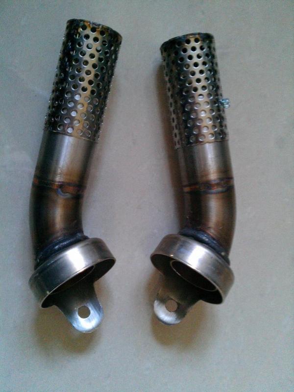

Some chap on another forum has had these fabricated using his stock Termi baffles.. Claims circa 100db. Lowering the DB - Ducati 1199 Forum
