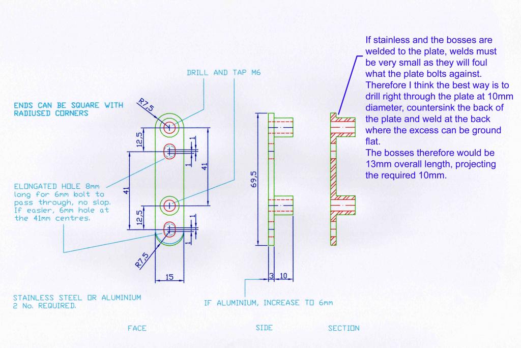

  6. I made some aluminium risers to fit my Showa forks to lift the mudguard by 12mm, they can't be seen...............I will check and see if they fit the Marzocchis as well.......Will update later.....
    Original drawing below............I have it on ACad as well so it could go straight into a laser cutter, which is how mine were done.
    AL
  7. They won't fit the Marzocchi without some modification........
    ..........basically omit/remove the lower boss, then bolt onto the Marzocchi lug using the lower pair of holes; then drill through the Marzocchi lug at the lower boss (removed) hole location and M6 tap the hole in the lug.....
    Job done.....
    Or you could actually do it with a couple of plates and a spacer boss quite easily.
    AL
