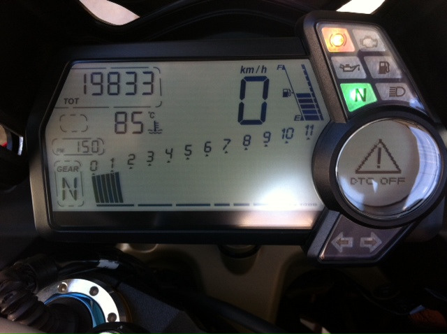

    This is what i got after moving a few meters.
    -ABS indication in on.
    -Warning on the circular LCD.
    -DTC indication is off.(left side)
  5. Same warnings that I got. The front ABS sensor is faulty or disconnected. If it was the rear sensor you'd loose the speedo reading too.
