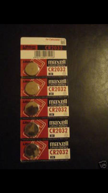

  2. I think your key fob might need a new battery mines just done the same battery's on eBay £2.50 for 10 ImageUploadedByTapatalk 21361396120.220538.jpg

  3. I might get one on stand-by.
