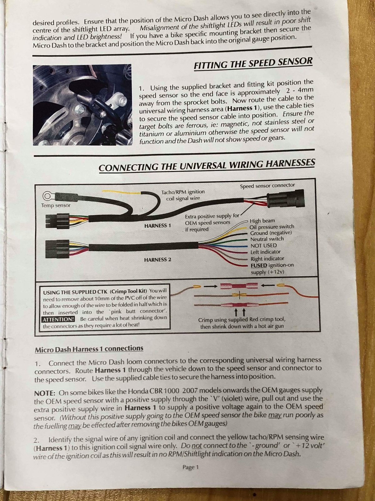

  2. Hope this helps 62E5EEB4-001B-4F5C-8EB8-FC13F4847B76.jpeg 962B01CC-BDF9-4394-8812-F2AD4F945CF2.jpeg 7409E30A-ACF6-4741-B3AA-FD671F8E6BED.jpeg FCEBB678-8EA1-4165-928D-D0F6AC4385AD.jpeg BDC80C08-51AB-4AED-98ED-E9CBE2D0E3CC.jpeg A2089B59-0650-4AC0-B8B0-29057824DAEA.jpeg 48223F6F-A89C-437C-BAA3-A847952F640E.jpeg
  3. Thank you both for your quick response
    I didn't look look under the dash for serial number thanks
    Thanks for the photos of instructions
    Great service
    Dave

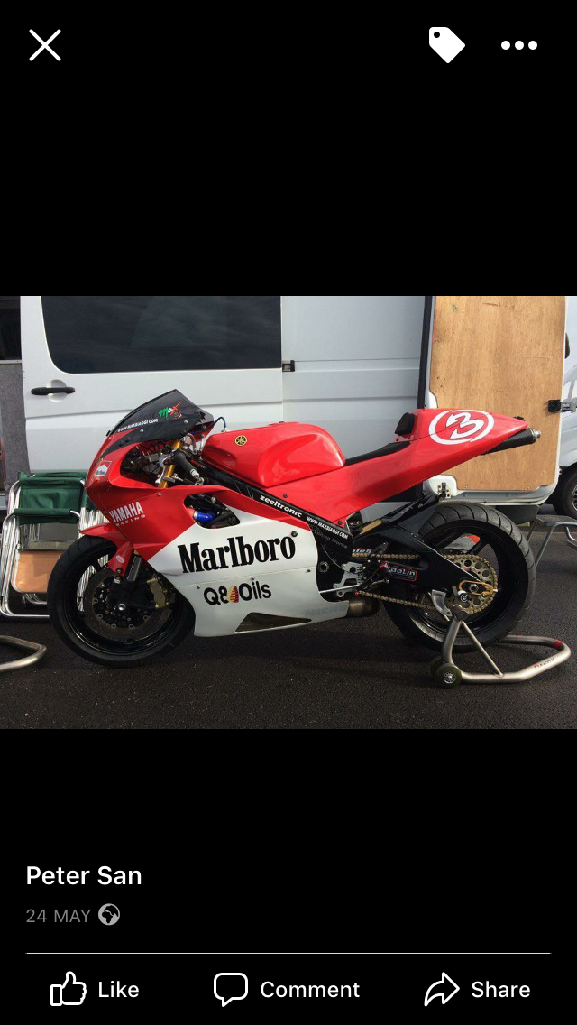

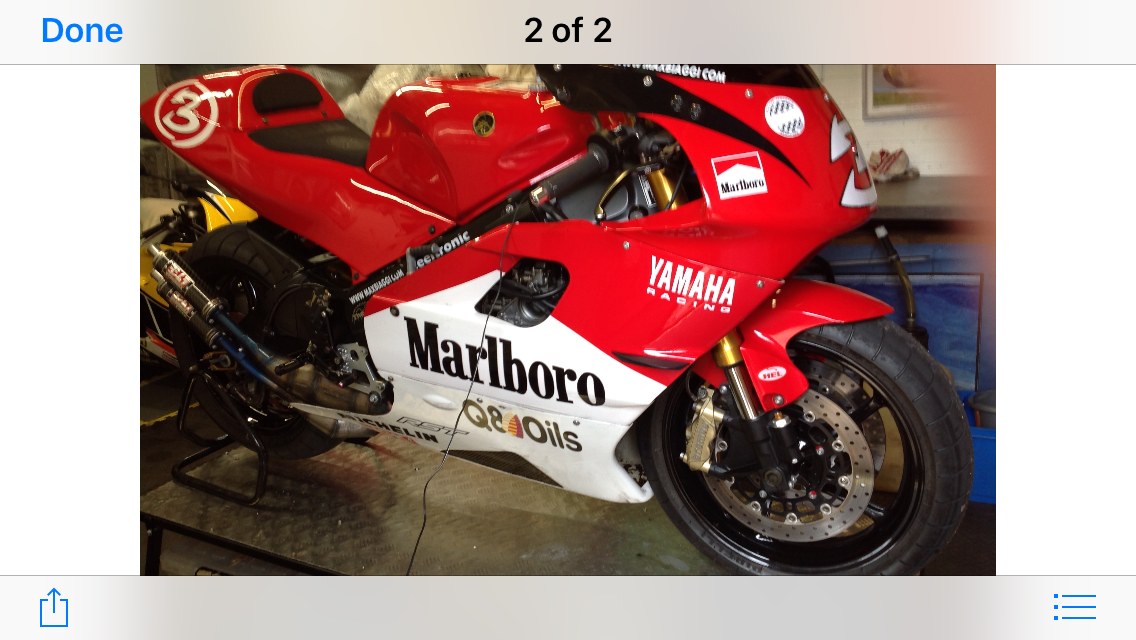

  5. Never mind the blah blah blah translogic dash. What about the small mention of a YZR500!!!
    Photos please.
    RG or RD based??
  6. E69597D2-E17B-429E-87D1-7ED6031D82BD.png 7A8DF8D2-6598-44FE-89F5-F67826FC2F55.png

  7. I have the same dash installed on my 748S, so if you need any help just ask!
    The biggest problem that I had was fitting the speed sensor too close and getting signal bounce, so it wasn't reading accurately. Once adjusted as per the instructions it was perfect.
