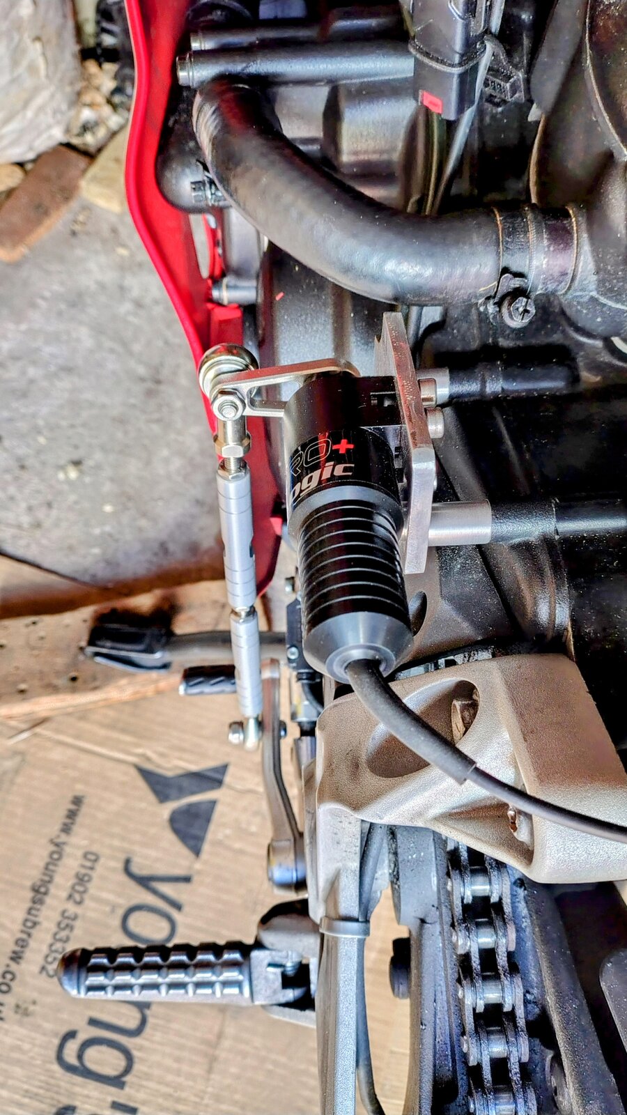

  4. That's exactly why I''m thinking of fitting one. I've had a below knee amputation of my left leg. There are 2 possible push button fitments Kliktronic and Translogic. I can get a Kliktronic VAT free because of my disability but the solenoid weighs a ton (2kg) and is not easily fitted to either my Supersport 939 or my Scrambler. The Translogic is a fraction of the weight at 350g and looks to be relatively easy to fit. It will cost a lot more but that's irrelevant to me.

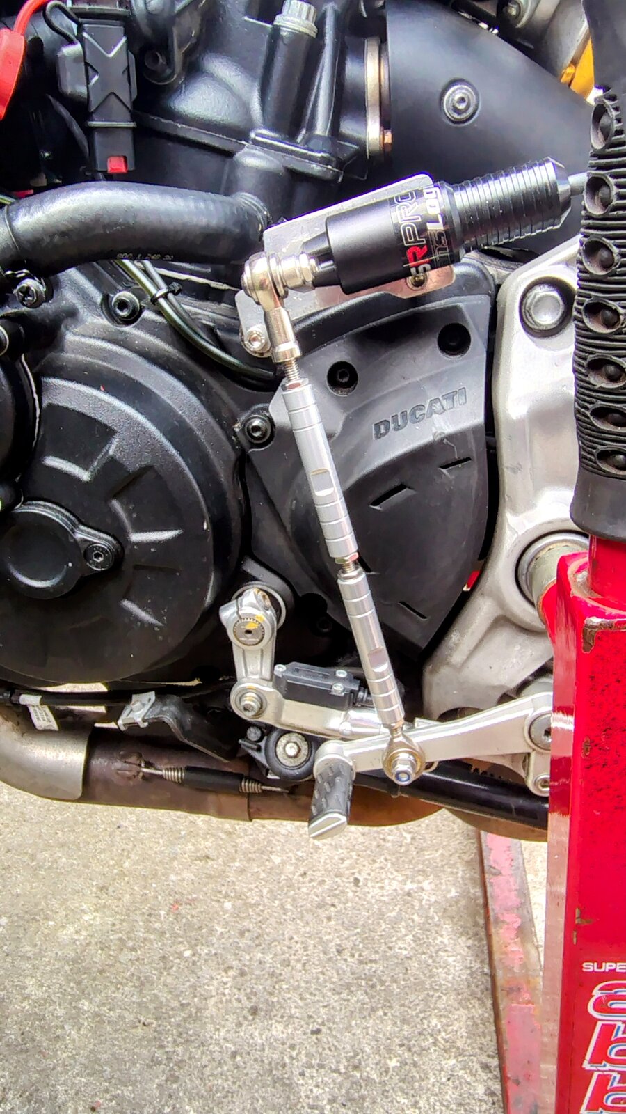

    This Facebook page shows a video of the Powershift in operation, I think I would be making the the mount more rigid. you can see it flex.

  11. That's a surprising amount of flex. Seems to be in the footpeg bracket itself, so it'll be hard to fix.
