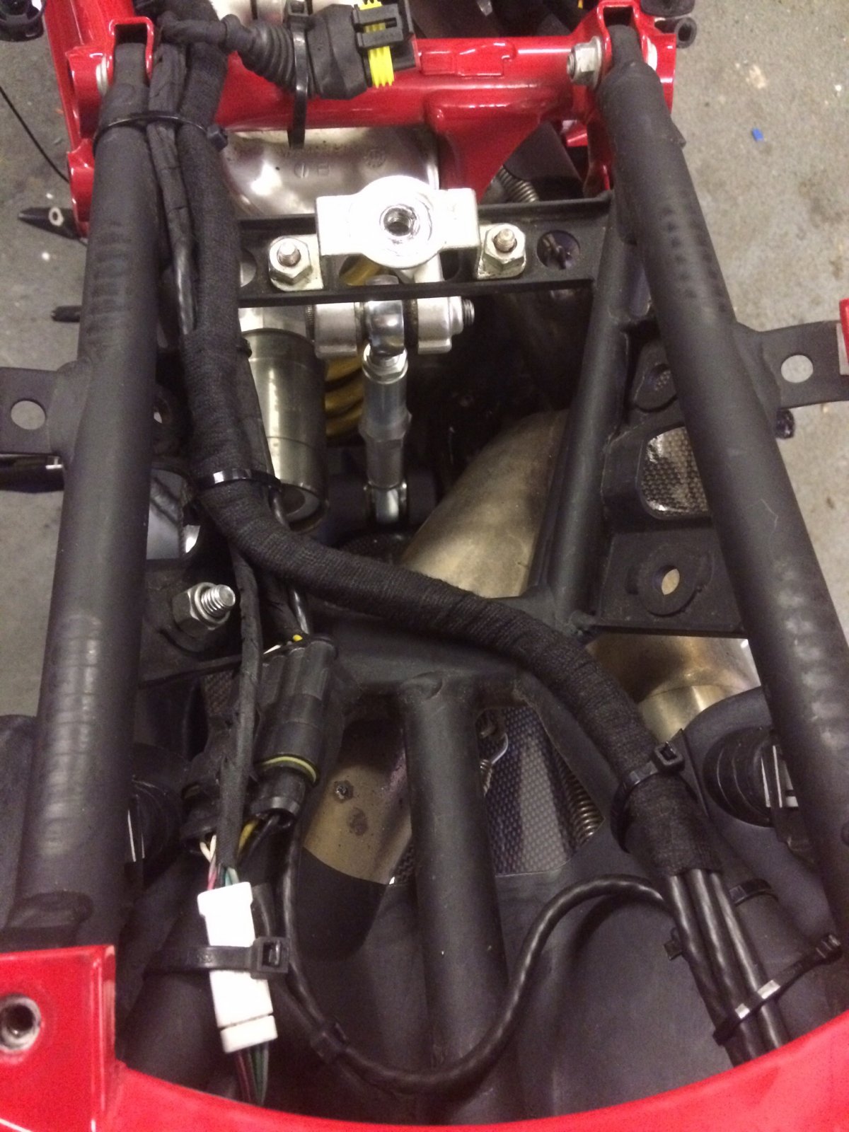

    I fitted the ecu under the rear seat and after wrapping the loom with self amalgamating tape followed by cloth tape to match the oem loom I ran it along the rear subframe and over the bracing keeping it clear of exhaust heat and road grime. See pics below

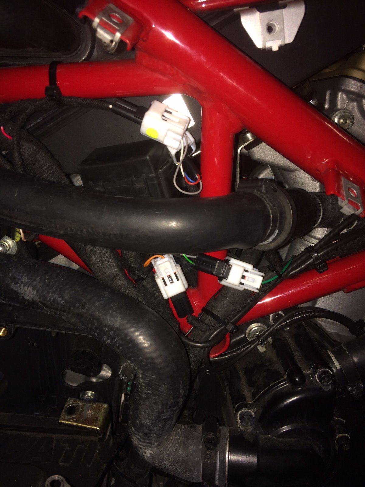

    The coils on the 848 have a signal wire (grey and blue and grey and green) and this is where the quickshifter connects (hence the crimping tool) I decided to splice in to the original ducati loom for this in case of future coil failure, meaning replacing them won't require removal of the quickshifter wires. I also soldered the connection instead of crimping it. Again I wrapped the loom with cloth tape where possible to give that oem look.
    The most difficult part of the fitting is making it look tidy as there isn't a great deal of room for extra connectors/wires but it's still very straight forward!
    There is an earth wire that has a ringlet to allow you to connect to the battery earth terminal.
    You also need to connect a wire to an ignition live. I connected mine to the run/stop switch circuit where it goes to the 10amp fuse in the small fusebox near the battery.

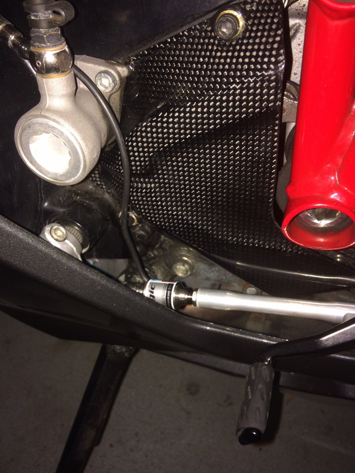

    Next up the shift rod and sensor, the kit comes with 3 shift rods which all have markings so they can be cut down to the right length if required. I used a pipe cutter to cut mine down for a straight clean cut.
    Now the shift rod is the same length with the sensor and rose joints as the original was. I chose to run the wire for the sensor along the clutch hose as it gave a little more free movement when shifting than running it along the side stand harness. Plug it in to the loom and job done!
