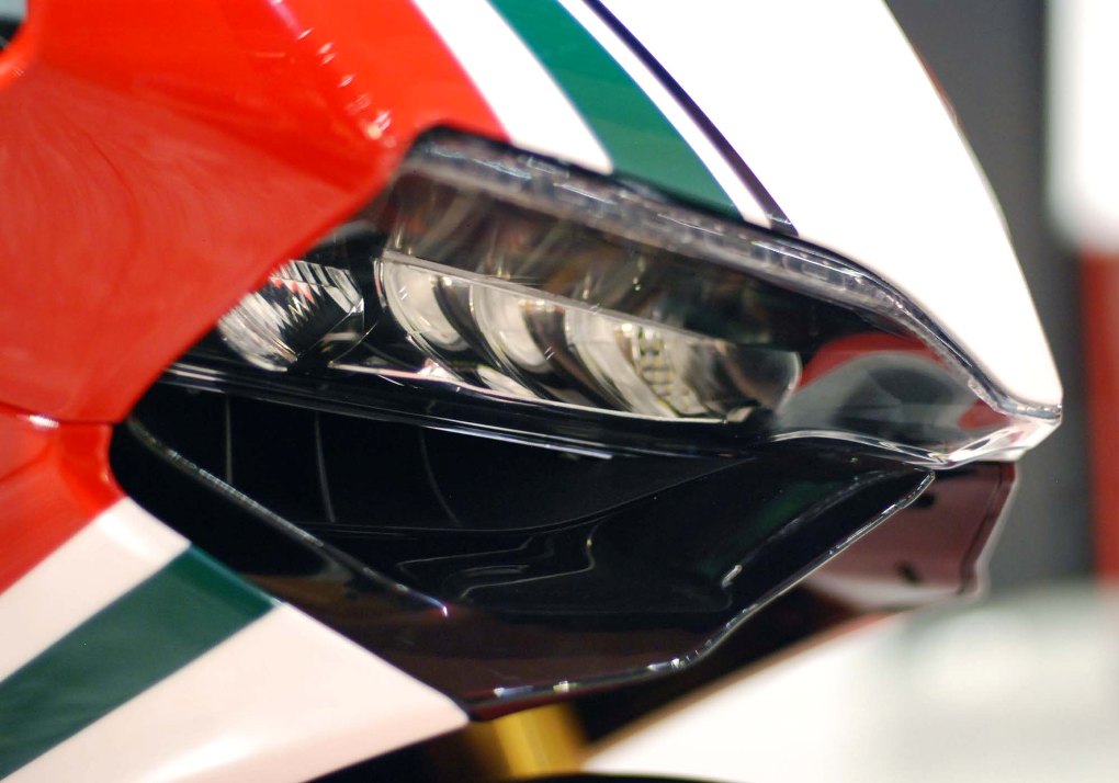

On the official Trics the nose fairing is carbon which is revealed under the lights, most of the lookalikeys don't have this.
Thanks for that, very helpful! I presume that's exposed carbon is it? A bit hard to tell from the photo unfortunately...
Yeah exposed carbon you need to look closely it's very dark, if it's a paint job only probably painted black or left red, I think the tank "Ducati" is white on the Trics and silver on the standard S's although that's an easy fix
